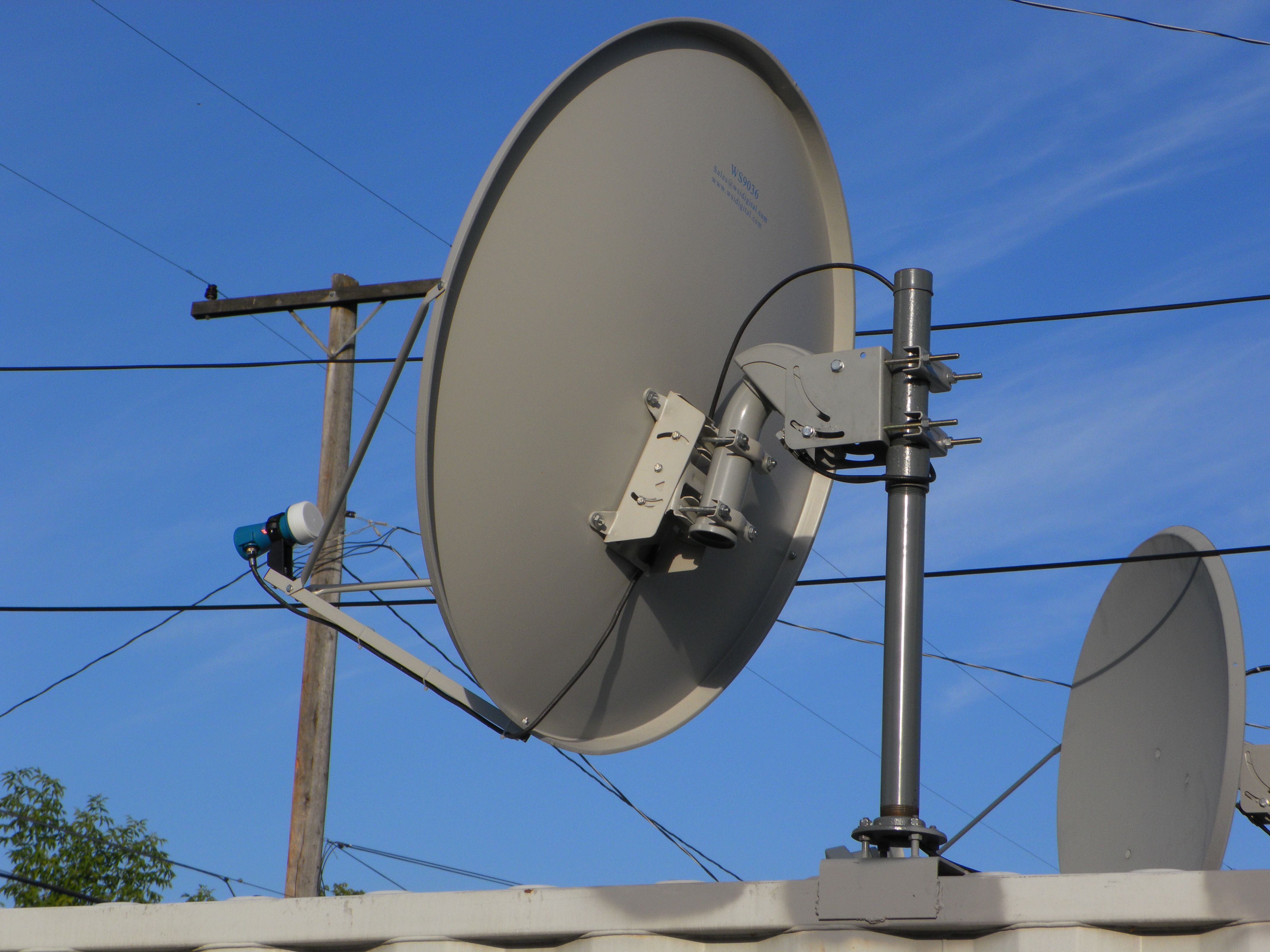

Yes I have one and I use a SG9120 motor the (b) motor has a smaller diameter shaft. I am not impressed with the performance of the dish however.
