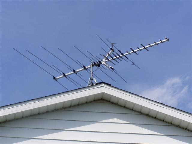

My mom wanted the hd7080p and was concerned with the curb appeal. My dad told her to get a grip... "its just an antenna and I dont give a crap about the neighbors"...if I may guote him.
I installed the hd7082p and she had a fit. She counted the elements from the spec at Winegard and said it was not the 7080p ...paced up and down the street for an hour...drove me nuts...told me to take it down.
I would have installed the 8200p but could not get the distant channels because the signals were blocked by the hills on all sides of her.

The picture I posted was the HD7082P installed 9 miles from the towers (the customer wanted the hd7080P but the hd7082P worked better there for their multipath situation).
If you split the signal in the home and get some loss of signal, add the Winegard HDP 269 preamp (in place of a distribution amp). This preamp was designed for the suburban setting and will not overload your equipment.
The HDP 269 has 12 Db of gain, very high overload tolerance (350,000 mv. which is 3 times more than the other high overload preamps), and 3 db noise. This can be a better alternative where you would have used a distribution amp to improve the signal for long cable runs in your home.

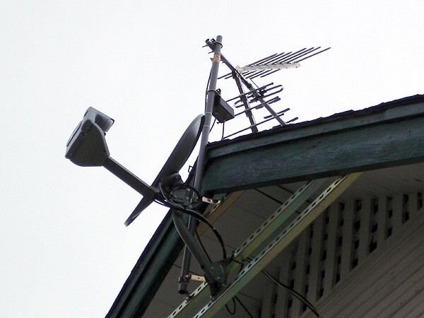

Well, my problem is that I am 75+ miles away from any towers, and I don't know how to gain any more signal. In the daytime some channels are barely strong enough to get a picture, some are cutting out. Closer to sunset, the reception gets better. The Cm7775 is a tad better than the RS amp, but it didn't solve the problem. I think it's just too far away.
ralfyguy said:
I installed a CM3020, but only the front UHF part. The back VHF part wasn't needed as all my stations are UHF. Would I get a better receiption if I had installed the whole thing? I mean the VHF part of the antenna doesn't really help with the UHF receiption right?
Antennas are designed by their manufacturer as a complete unit. Using only a part of an antenna very well could degrade the performance of that part compared to using the entire antenna. There may be harmonic consequences for omitting the VHF portion of a VHF/UHF antenna.
I'd use the whole thing and see if performance improves.
Alternatively, a UHF only antenna such as the 4228 has better signal gathering ability in deep fringe area such as yours. The CM3020 is not rated by CM as working as well in deep fringe as the 4228.
Deep fringe yagis might also work, but they have a smaller gathering area and are more suseptible to signal fade and variance, whereas the 4228 is more susceptible to multi-path (probably not a consideration if you're 75 miles from the transmitters).

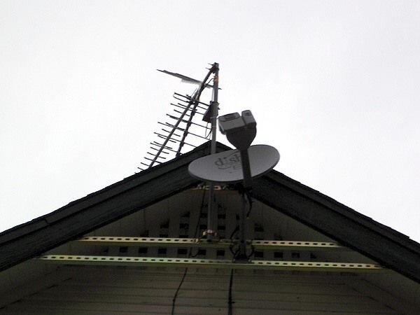

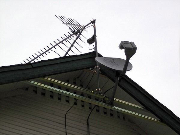

After reading some of it, I actually should be happy to get any channels at all. I am 75 miles from the towers. I have a bunch of huge trees surrounding me and especially in front of the antenna, at about 50 feet away. The antenna is on the roof, as high as I could go. There's alot of wind around here, so for multipath issues, the CM4228 is probably worse than the 3020, even with higher gain.
I can't move the antenna, its actually already pointing through a "hole in thr trees. I can't move the trees either, they aren't mine. Getting all educated by reading this interesting stuff, I am surprised having any usable reception at all.
I came to the conclusion, that the current setup is as good as it gets. I get all the channels but one, and I may just depend on FOX23 to increase the power, especially after analog shutdown. Because they transmit the analog signal at about 3,200KW right now, and he digital is supposed to be 1,000KW. It may not be at 1,000KW as of now. But maybe after the shutdown they might be allowed to increase that to the power of the analog broadcast, or at least closer to that, since the analog signal will not exist anymore. I am calling it quits, to try more, because I already have tried alot, and have achieved more actually, than the experts in all this articles I read predicted I could. I am not ladder proof and I habe fear of heights, and since I am deaf on my left ear, my sense of balance is screwed up. Means I have been up there countless times, and it stresses me out to be up there. I am happy, I haven't been hurt so far. I have a wife and son to feed. And the thought of getting hurt for that, and then not being able to work and provide for my family is just horrible. I appreciate all the input and help so much. Thank you guys, you are the greatest!
I still want you all to at least see my setup. Here's some pix:
