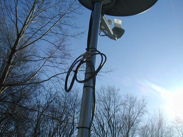

You are correct, of course. However, look at it from this customer's point of view. I had an AT9 installed in June. The tech told me he had installed dozens of them. It was a pole mount, with the pole already installed. He didn't tighten the mounting screw enough, so it went out of alignment. No big deal, I fixed it myself. He mounted the dual junction block vertically instead of horizontally. No big deal, I fixed that, too. He told me that it didn't matter that the 99 sat doesn't show up in the signal strength setup since it carries the international channels! He didn't install a ground wire. No big deal, after escalating the matter, Halsted sent a competent tech out and he installed the ground. So you see, there are some good techs and some that haven't got a clue. Lucky for me, I know more than the one that did my install and was able to correct his mistakes. Most customers are not so lucky and end up with a multitude of problems.

I don't know about all that but didn't you supply your own pole?, and ground blocks and multi switches shouldn't be installed horizontally, but vertical to prevent water seepage.

Yes, I supplied the pole, but the tech didn't tighten the bolt enough to keep the dish in place. That was not my fault. The ground blocks are supposed to be installed horizontally so that water will not enter them. The attached picture shows what I mean.

thats vertical to me. as far as the ground, where did he ground to, i hope he didnt put in a ground rod cause that wont do u any good when its not backbonded with #4 copper bare to the existing house ground. as far as ur dish being realigned, he shouldve used a self tap screw so that wouldnt happen.

I call it horizontal because that's how the wires are aligned. Either way you refer to it, the original install was incorrect. The ground is #10 wire to the water service inside the house. That is the code in CT.

That's vertical to me also.

No, I never said the pole was too small. I said the tech didn't tighten the mounting screw enough which allowed the dish to go out of alignment. The pole is a 2" fence pole.
