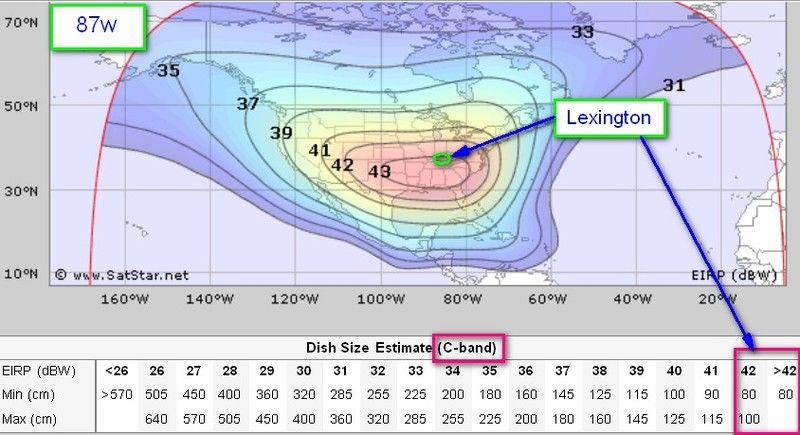

@Primestar: I do have a brand new Titanium PLL C-Band LNB with a large Titanium T1 Conical Ring to go around it, so if I put that on the 1.2M dish, and just park it on the SES2 87W satellite; will my quality numbers be pretty good? I checked on one site, that put my house pretty much in the bulls eye for the strongest signal. The information said I would just need a 1.1M dish to get the signal, so I thought 1.2 would be better.

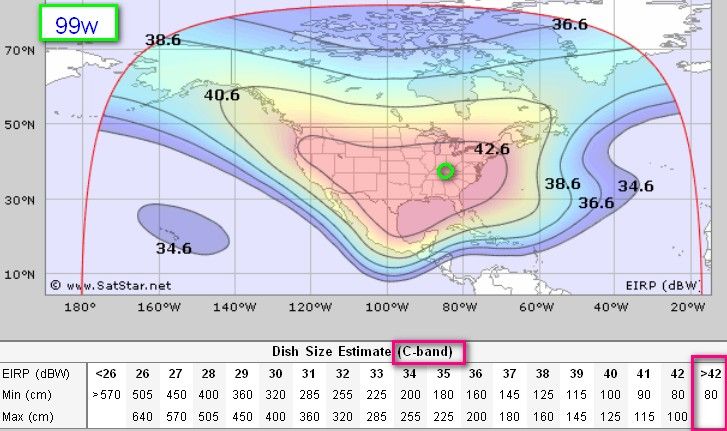

87W is not a satellite that I would attempt to get with a 1.2m dish. Even 6 foot dishes have problems with this sat. You can try it just in case, but I doubt it'll be worthwhile. 99W for sure would work with 1.2m C-band, and is well worth going for.
@primestar31, Ok. Thanks for the info, like you mentioned I can try it first and see. I went to SatBeams to check out the footprint at my house for the 87W C-Band satellite. It said I would just need a 1.1M dish. But if I can't seem to get anything there, like you said, the 99W would be my 2nd choice to park the C-Band dish at. I wasn't looking to motorize it, I don't think my receiver can handle two H-H motor's at once.
By way of explanation as to why people aren't reporting success on 87W with small dishes: While a baseline calculation based on transponder output power and radiation pattern might give an acceptable signal strength on a 1.2M dish, I believe all the English channels on 87W C-band are now a higher-order modulation (DVB-S2 8PSK) than what used to be used, and so require a stronger signal in order to have a usable SNR.
Thanks Jim for the explanation, so your saying I would need a much larger dish to get anything out of 87W? It did have the most local stations on it, but there are some locals and other good stuff I saw on the 99W which is my 2nd choice. I won't be able to aim the 1.2M dish too far to the west or east. I have a large peak of the roof blocking the west, and the neighbors house block much of what I could get from the east. Where I plan to locate the 1.2M dish, I have a small window of sky to pick and choose from. The vendor I talked to earlier today wants to sell me a 6FT Prime Focus dish, which for $270 is not a bad price at all. But I'm pretty sure my wife isn't going to go for that size of antenna in place of the old Dish Network reflector. I am already pushing it with a 4 foot dish I want to buy soon on eBay.
