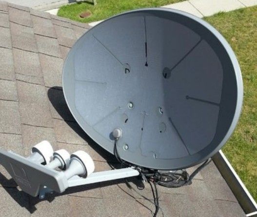

Whether at me still a question about heater Dish.???? in the instruction on assemblage of a heater from what party it to glue.?
And how many there is your heater for Dish.
Has found at our forum about your heater and a photo how to glue.

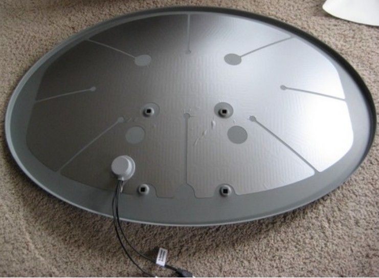

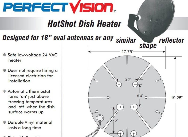

Boris, you did not post the installation sheet for the HotShot Dish Heater. Once you post the correct installation instructions, I will show you where to glue the heater properly. The 3rd photo is not from the installation directions. That photo shows the heater installed on the wrong side, it is not designed to heat the entire metal, just to heat the heater face where the signals are collected.
If everyone actually installed the dish heater on the wrong side of the reflector, its no wonder why it does not work for most people, so they try to dislike it instead as much as they can.
You posted the proper way in that picture. That is why it has those 4 holes. So the bolts and nuts that stick out the back will not damage it. :)
Well, I give up, i can't make it any more clear for people. Im tired of fighting this battle all by myself. If people want to keep putting it on backwards and hate the product, then it is what it is.
That's ok. I will still have excellent TV in a winter storm, everyone else will be in the dark without any signal for days or weeks! :-D lol! :-)
Some models can mounted on front or back of the reflector. On smooth metal reflectors, installers prefer to mount it on the back and the heat is transferred. On reflectors with rear rib supports, the heater cannot be mounted on rear and can only be mounted on the front.
For high power DBS/DSS signals like Dish Network, DirecTV or Bell front or back mounting makes minimal difference on the the signal quality. On weaker FSSS satellites and weaker transponders, the signal loss from front mounting can be notable.
