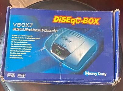

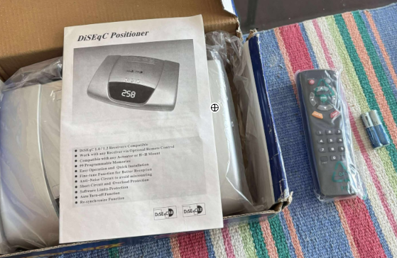

I installed the unpowered Von Wiese jack that came with the dish only to hold the dish fixed during testing so I could manually change the azimuth. Now, it would be nice to move forward and actually try using the Von Wiese to push the dish. For this, I need to source 100+ feet of power/pulse cable plus a mover like the VBox. I'm not sure where I would source these from.

Rick's Satellite has the PR1200 dish mover. Not many options out there these days so maybe best to grab one while they are still available.
