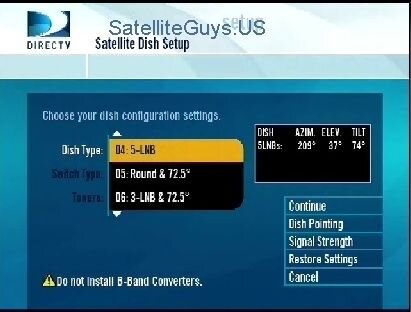

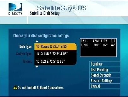

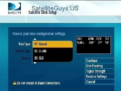

Take a look at the new satellite setup menu options in HR20-700 & HR21 version 0x0241.
I've attached some screen captures for you. EDIT: See the 3rd post - Dfergie fixed my captures for me.
I think DirecTV would be curious as to our feedback on this new configuration setup.
Here are my initial impressions:
1: Great addition of a single/dual tuner option - for the few people htat only have one wire and no swm yet.
2: The 16 options for dish type is very confusing, especially calling the new slimline 3 dish SL3. It is good to see them getting ready for it though.
3: The Do NOT attach BBC converters when SWM is connected is a good addition.
4: Add a detailed description of the 16 sat configurations down where the BBC message goes when scrolling through these.
Try these ;)

Here is the list of the 18 different satellite configurations:
1. Single LNB Round
2. 3 LNB Oval
3. Slimline 3 (Future expected to include D12)
4. 5-LNB Sidecar / Slimline
5. Single Round & 72.5
6. 3 LNB & 72.5
7. Slimline 3 & 72.5
8. 5-LNB & 72.5
9. Single Round & 95
10. 3 LNB & 95
11. Slimline 3 & 95
12. 5-LNB & 95
13. Round & 72.5 & 95
14. 3 LNB & 72.5 & 95
15. Slimline 3 & 72.5 & 95
16. 5-LNB & 72.5 & 95
17. Slimeline 3 -S
18. 5-LNB -S
I'm not sure what the -S is on the 17&18. Possible SWM, but that is listed as a seperate item on switch type.
Hope that helps reduce squinting at the attachments.

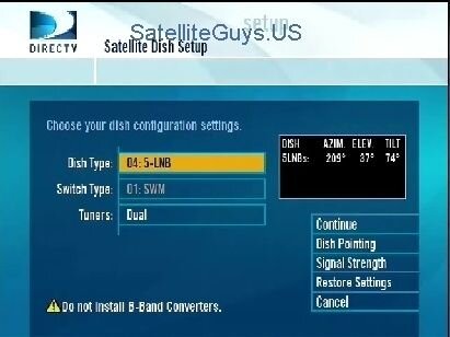

Well I just was playing with this and now I've messed up the receiver. I have a slimline dish (3 months old) with one duel tuner receiver. When I pick 4 - 5LNB and confirm I get no signal detected. What am I doing wrong?
Yes I'm S........... Can't get any signal now to my receiver. Waiting until CE is over and download the stock version see if I can recover.
I have done it 5 times and everytime it says failed to find signal.
Sounds about the same as what happend to my H20. Had signal ,but only odd transponders,and the it would switch to only even transponders. The bad thing about it ,the H20 wouldn't let me force a download after this happend ,so I couldn't go back to national release. Did you try downloading National software again? You can't do it during CE release times.
I forced the nat release, even then it was screwy for a couple of reboots, and finally success. I'm going to download the CE tonight and not play with the Sat Setup anymore.
Like you I had signals, when I watched the signal meter it was alternating from Tuner 1 to Tuner 2 and from 100% to 0 in rapid succession.
Hemi how did you finally rectify or haven't you?
I had to buy a refubished H20 that D* sold me for $85. With no commitment. But I still had to lease it, Meaning I had to give it back if I dropped service. Sadly I just didn't want to take part in the CE after that. Its just not for me. Good luck:)
I'm sorry you had that ordeal - but that is exactly the kind of feedback that the developers need from the CE program. Thank you :)
I'm glad going back to the NR fixed it.
