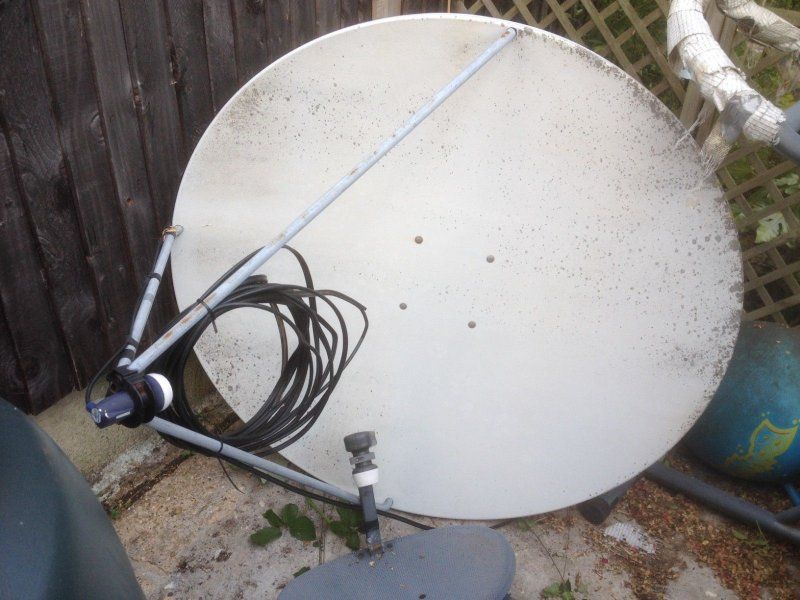

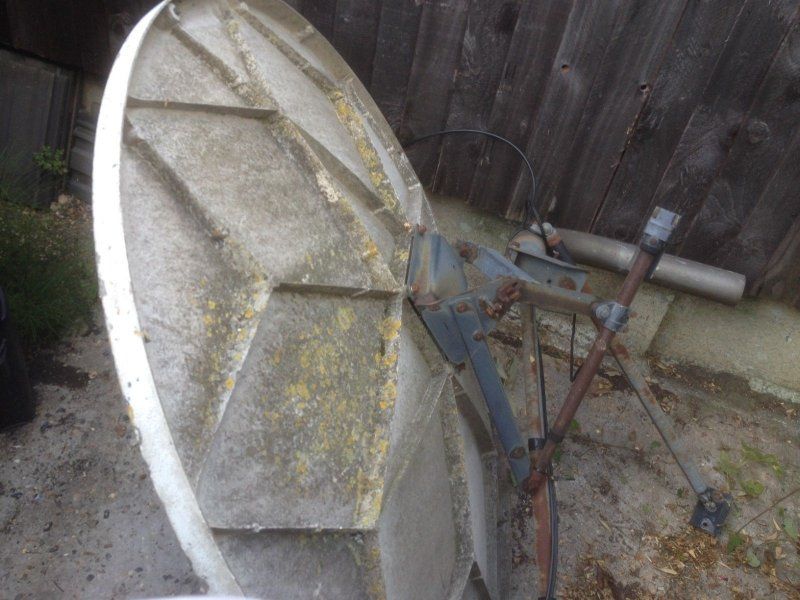

I do not know how much would that cost to ship antenna from UK, but Channel Master 1.2m on original polarmount is much better antenna than many others, Yes, it needs some cleaning, but after that it will look, and most importantly work like new. Buy it now price about 40 bucks. s-l1600a.jpg s-l1600.jpg Add is here

You're probably looking at over a hundred bucks to ship it. A little bleach will do wonders for the dirt and mold on it. I just washed my siding down with it. :)
