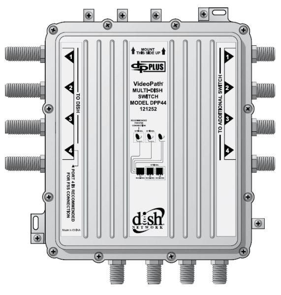

My owned 211k resides permanently on a covered pool deck while in the house we have 2 hoppers with sling, and 3 fire sticks. We utilize a DPP 44 switch with our set up.
