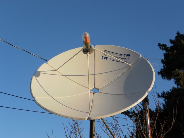

It was nice weather this morning, not to windy. I went up the ladder and started tuning the WSI 6' special with a 741 LNB. The sun was bright and the meter was hard to see but still doable. I'm glad this comes with a BER scale because that is what you need to use for the best tuning. And tuned in good. I'm watching all of my favorite Ku channels as well as c-band. This dish works pretty good. The meter is great. Easy to pack around and battery operated. It will even move the motor via DiSEqC. But pay attention to the menu. After you set up a new satellite and go to scan it, you have to select the satellite again on the scan page. I messed up a couple of times forgetting that. Overall I found the meter easy to use and I had good results.

Hello Magic
I am glad things work out for you, Regarding the meter, yes it is hard to see the display in the sun light but is doable, your dish looks good, I like the way you routed the coax cable maybe I will do that.
