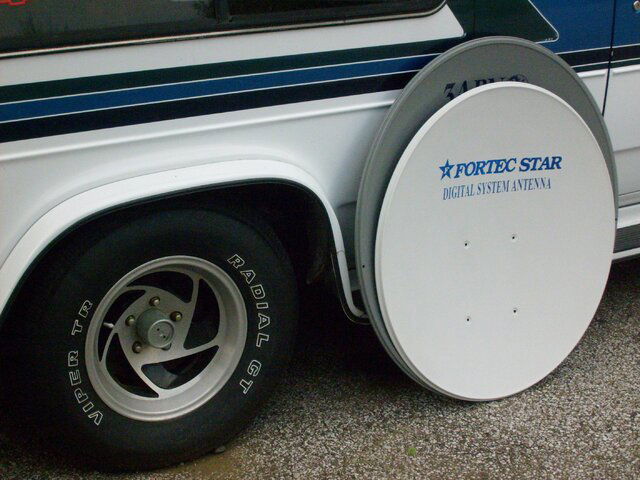

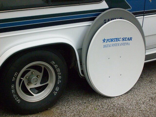

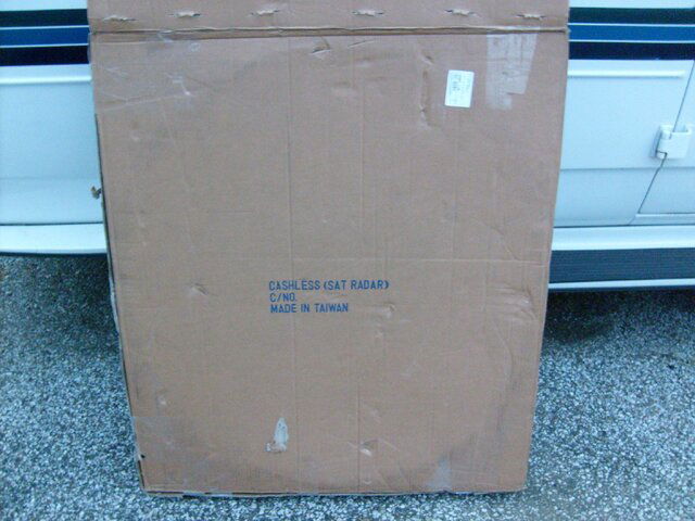

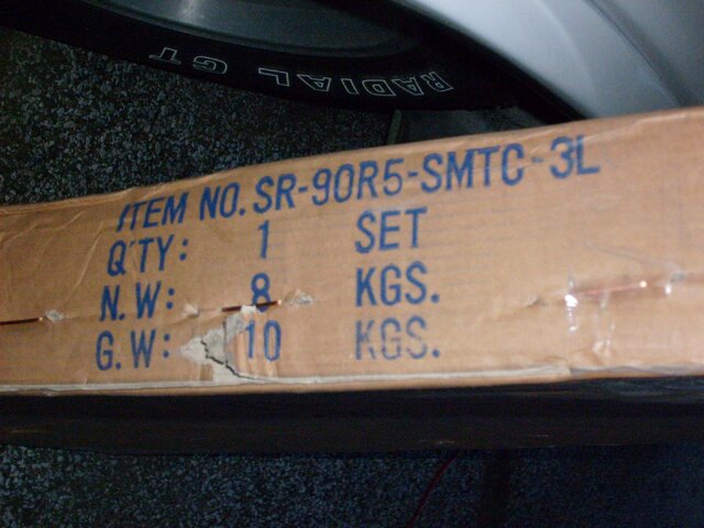

I posted some pictures of the two 80 CM and 90 CM dishes to compare to size especially to my Chevy full size sport van's G-20 15 inch tires! The Azure Shine box says made in Taiwan, I read a post where someone's box said Made in China. I guess they are about from the same place huh! Box said Cashless (Sat Radar) on it and the UPS dude said then he delivered it today "I never hauled around Radar equipment before! This is a first for me!" I had to laugh! Putting it up got my local Pizza man asking questions about the dish. Seems like he was into the BUD era several years ago and wanted to know more about KU. Got him interested in it when I told him that he can use his 2 BUD'S he still has up on a new receiver! He was beside himself! Going to help him set up a system in his business sometime in the near future! Told him about Sadoun also for parts if he needs them for his C banders! Plug Plug!

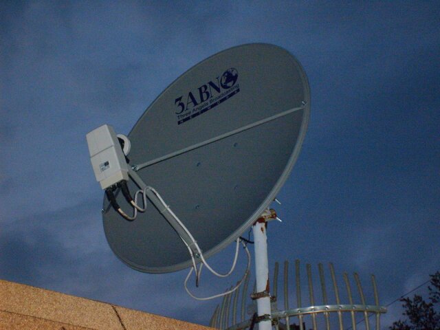

Bee Proof That Darn Pole Setup!
Looks GOOD! I should have bought one of those.....don't need it though :)
Thanks!!

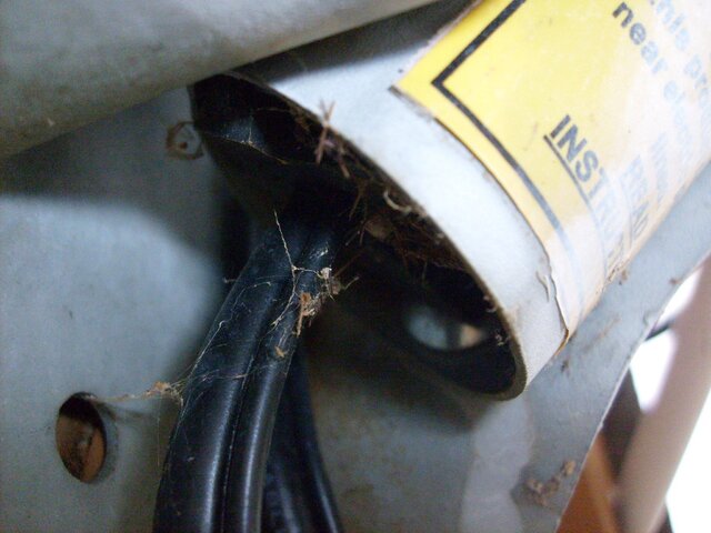

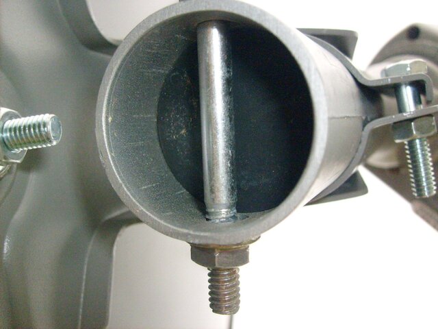

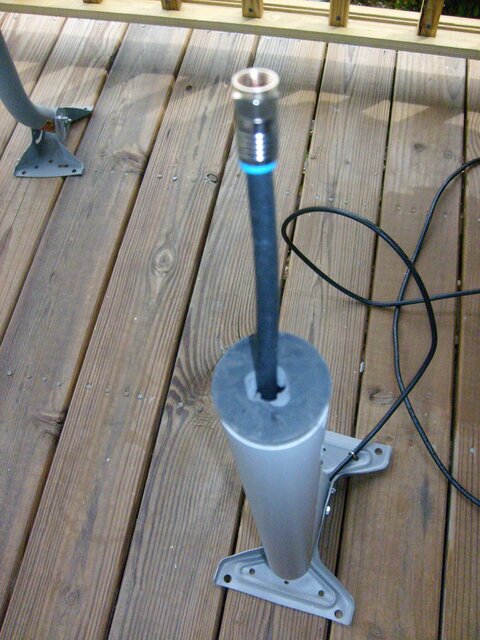

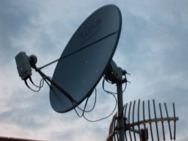

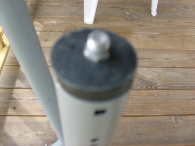

The only thing I need to do is replace the pole it's on! I bought 2 of them when I got into FTA and the other is ready to go up! I thought ahead three years ago before I got this setup and bee proofed the thing by going to the hardware store and bought thick 1/2 thick rubber grommets for the foot pole and motor bottom! Now the bees are everywhere here but not in this setup! I drilled a hole to let the coax pass through the bottom from inside the building to the bottom of the foot mount through the rubber grommet then right up the pole to the top and yes, another rubber grommet! Water can't even get in there! The pole is scratched and the powder coat is about worthless on these things. I learned my lesson a couple summers ago with my D* 300 pointed at 61.5, on the ladder adjusting and a wasp came out to say hi! Although he was unable to fly (This was at night) I knocked him off the mast pipe and he fell to the ground! Nevertheless to say he walked back up the ladder and up my pants he went! The darn thing got as far to my waist band till I started to get down off the ladder and he gave me something to remember him by! Let's just say, I was the last person he stung! With this set up I wanted to be able to tinker with it even in the summer worry free of bees! So I came up with this idea! My FTA dish has never had a bee nest in it since it went up! My Dish Net dishes are another story! Would not go around them at all! Spiders like to web it though but they are easy to knock off! I am going to do more adjusting in a bit to the 3 ABN so we will get it today hopefully!
Yeah iafirebuff, my brother missed out on this deal also! I can say that I see a big difference in signal quality in this dish! I am glad that I decided to get it this time around! It is a bit heavy than the other dish I had and awkward to handle but I walked it up on a ladder assembled yesterday with no problem, the UPS weight on the box it came in was 28 pounds so subtract the foot mast, box and there you go. I got to say that this is a big foot plate! I guess bigger dish bigger mount! Later guys, sending pictures of the bee proof and the difference in foot mounts in case anybody wants to see.

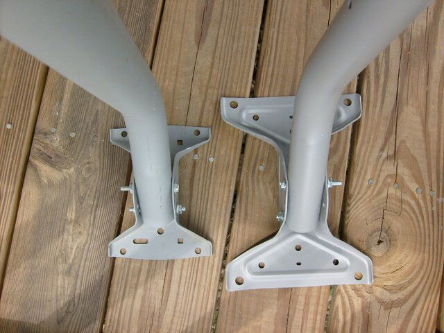

Picture 1. Foot size from standard to the 3 ABN 90 CM
Picture 2. Rubber grommet with female to female connector if you wanted to do it that way
Picture 3. Rubber grommet with the coax going through
Picture 4. Motek SG-2100 bottom of motor grommet
Picture 5. Bottom of my foot mount grommet for the 3 ABN
Picture 6. Top of pole mast with grommet. The silicone has changed colors since 3 years ago. You can also see how my mast pipe has rusted with the powder coat peeling.
