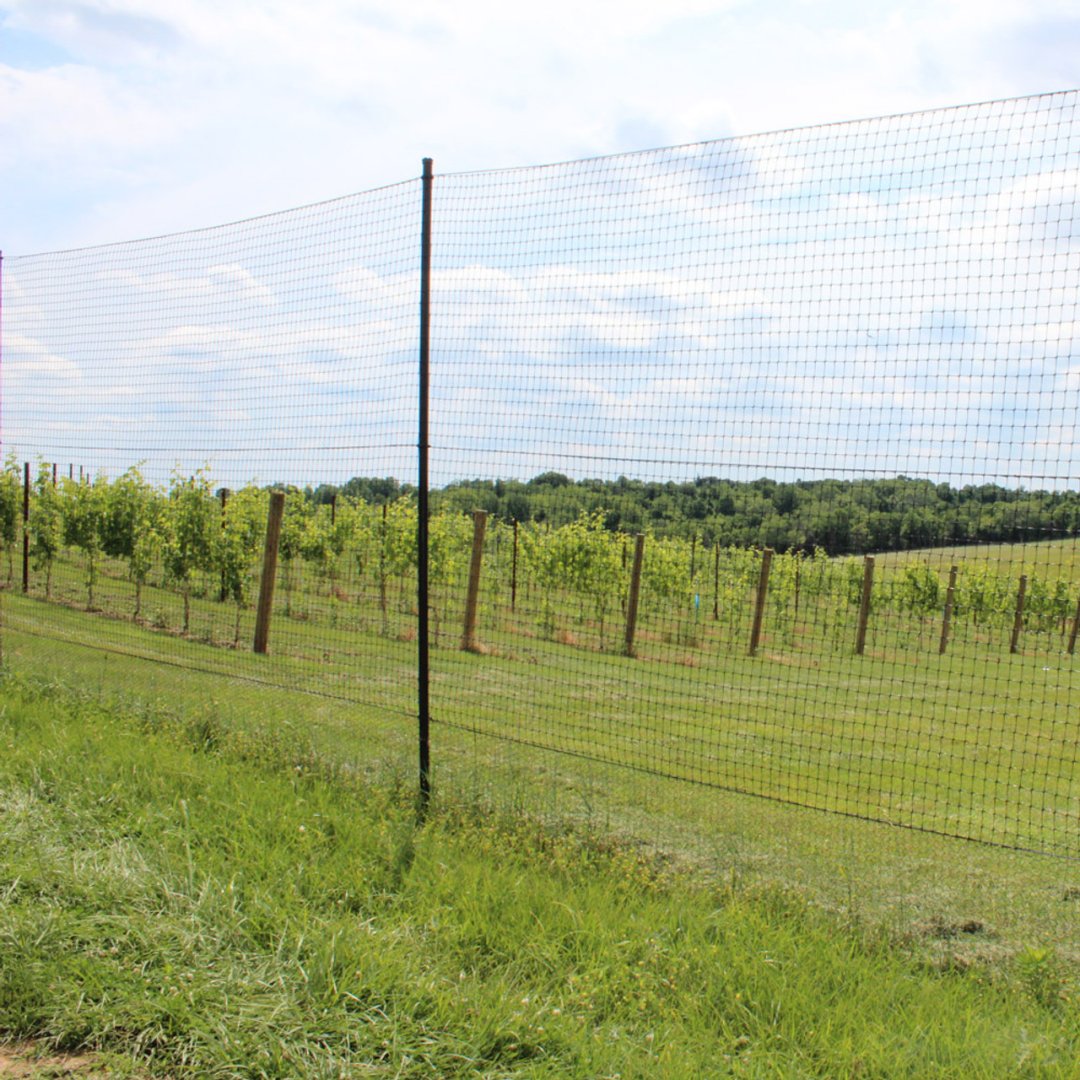

It is behind a building, can you point me to a pic of what you mean by "build a rf shielding fence out of hardware cloth or chicken wire." I just can't visualize what you mean.
Evidently, the building is not in the right position to block the interference.
Use a spectrum analyzer, even as simple as the Tiny SA Ultra: www.amazon.com/ALIESTFDNO-Upgraded-Spectrum-Frequency-Generator/dp/B0D3GYBXMH connected to a powered C-band LNBF to determine the direction the interfering signals are coming from (directly or reflection). Build or buy chain link fence panels (frames) and affix wire mesh with small openings, such as galvanized poultry fencing or hardware cloth. Before installing the panel(s), move the panel(s) around to determine the best placement to block the interfering signal path(s), while not blocking the satellite signal path.
Instead of building a frame, one could install some tall fence posts (8, 10 or 12 ft) and install the galvanized poultry fence or hardware cloth between the posts. Best practice is to ground the wire mesh.
