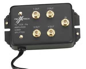

What are the specs on your amplifier? Typically most are 4dB out to each TV which is basically doubling the strength. The other typical problem is they are designed for cable frequencies rather than over the air channels. Possibly your other problem will be where to locate it seeing it will replace a splitter.oh and i have a 4way amplifier similar to this one that i would like to use would it work?View attachment 91456
