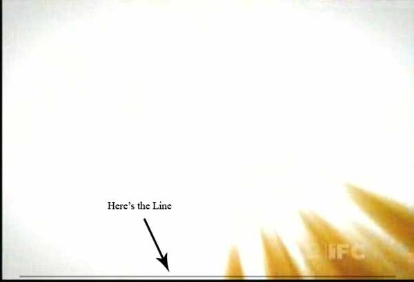

You can read the original thread here. In summary, some of us were having a problem with our 721s, which would show a black line at the bottom of the screen. This was frustrating as all heck. Here's a screen capture of what it looked like (you won't be able to see it from the thumnail image itself):

So I thought about it a little more. The line looked to be near the bottom of the menu screens, almost like it doesn't stop displaying it even after exiting the menu. Hmmm, I that could be it.
I went into the user preferences menu, and lowered the default position of the menu, until the black line was off the screen. Eureka! The black line is somehow related to the menu system and can be moved! I verified that it actually is gone by shrinking an moving the image with my external scaler. It's gone.
