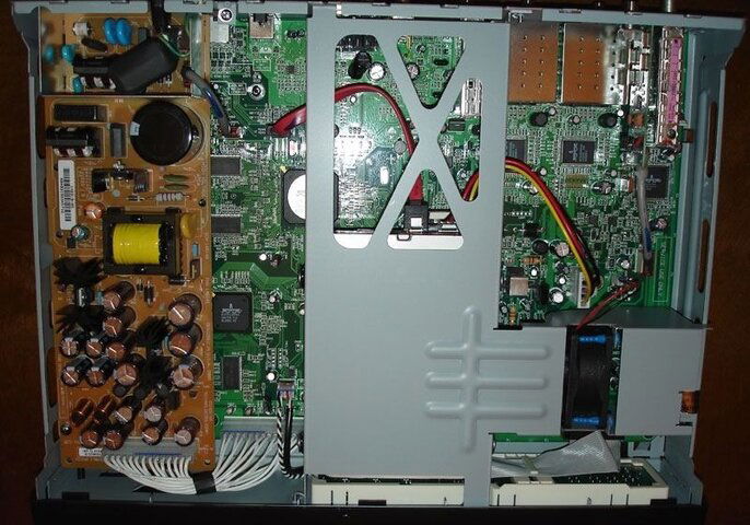

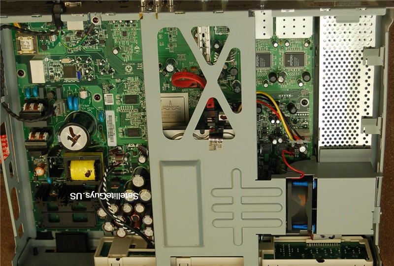

A picture is worth a thousand words.
722 View attachment 73489 722k View attachment 73490
I stand corrected on the "left of center" comment. Those drives are close enough to "center" to leave it at that. Where is the front panel? If that's on the bottom of these pics, then the fan blows out the right hand side contrary to my memory. (My memory has been wrong before.)
Front panel is down on those pix. BTW 140° is not that hot if it is the high temp. Mine is 138° hi and 122° avg with a low of 113°. These are not that unusual for an HDD that runs all the time.
