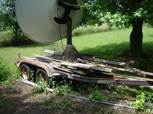

If you are lucky it may look like this with the birdview, in which case you have found the holy grail of dishes.:)
Hey OSU1991,
I was thinking of that Birdview that you found on the trailer. That was a Great Find! :up
I was meaning of asking you when you first made the post (if you did, sorry I missed it) did you ask about it and were you able to get it? It sure needs a better home besides collecting old wood and trash. At lease somebody to put it to good use before it hits the scrap yard! :eek:
TOM
:D
It belongs to the former Birdview dealer and is where I got the closeups of the birdview logos. He had 2 solids, one on a pole and one on the trailer and a perforated laying on the ground.
He didn't want to part with them last time I was in that part of the state. Unfortunately I am stuck in the office and around Tulsa, and have to assign some of my employees the monthly jobs of traveling now, so I haven't been able to follow up on the other 3 Birdviews I have seen. Hope with the coming cooler weather I can get out of the office some more.
