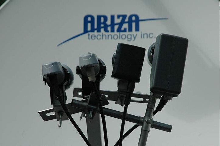

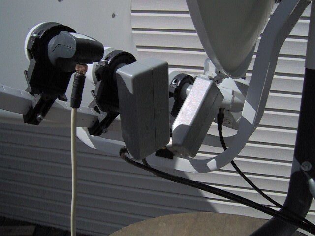

Yes, you will have to skew the LNB as well as it is really off from what it should be. I have 91, 97, and 103 on one dish (pictured below left to right, plus Echo8 at 110). The skew for my area is 10.5 (91) and 16.5 (97), and as you can see 103 is in the minus!

Here is a great picture of what I am talking about
The farthest left LNB is on ANikF1 for StarChoice and the skew is right...the LNB to the right of it is AMC1...look at the skew (technically on the T90 dish the LNB's should be on the 0 spot on the holder...the LNB for AnikF1 skew is probably off by 2 degrees of zero or so
(by the way...disregard the 3rd LNB skew...that wasn't hooked up at the time) :)
