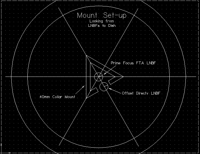

Thanks for all the suggestions everyone! This morning I worked out my theories using my CAD program to draw out the focus length and the 2 angle differences in elevation and azimuth. I came up with a 25mm spacing for the 2.1 degree azimuth difference and a 47mm spacing for the 3.9 degree elevation diference. When I pluged in the numbers into the formulas you provided I came up with the same numbers! Great!! Looks like I'm on track with my spacing and it looks like I will just be able to get the 2 LNBFs in the right position if I mount them just touching each other.
Here is a drawing I made of how it will look. Using a Sadoun Collar II for C Band Dish which has a cutout on one side I should be able to get the 2 LNBFS next to each other with a drop of 47mm and a east shift of 25mm for the offset LNBF. This should be correct as I understand the offset LNBF has to be on the opposite side of where the satellite is in the sky. The offset satellite (101W) being higher and to the west. The circles represent the 40mm LNBF throat.
Now my other theory was to use the combination Circular/linear Invacom QPF031 and have the dish pointed between the two calculated positions so that it would be able to pick up both birds at the same time. The thing is it would be "off center" to either bird by about 2 degrees. The question is would this adversly effect the signal strenth enough that I would have no reception? Or would the size of the dish compensate for the loss created by the 2 degree miss alignment? Any ideas on this theory?
I"m pretty sure theory 1 using two LNBFs with the stronger directv LNBF offset will work. Do you think theory 2 using the combo LNBF centered between the 2 focal points would work? Also, I know using a 180cm dish is overkill but I feel alot better using the big dish especially considering this strange set-up and the fact that we do have a lot of rain here. Also my set-up back in L.A. theoretically is optimum for that location but I still have drop-outs on the 97W especially on the DMC channel which seems to be on a weeker transponder. My fiancee really gets upset when she loses her DMC channel and I don't want that to happen here in Hawaii with this setup!

theory 2 will not work. KU Band satellites are much weaker than DBS sats and you really need to be nuts on to get good signal quality. DBS has room for error. KU had very little room for error.
That's what I thought also. The FTA KU LNBF has to be right on the money. So what if I center the dish and FTA LNBF on the 97W bird. FTA would be great but I would now be 4 degrees of the 101W Dirctv bird. Is the Directv DBS signal strong enough to overcome a 4 degree error in pointing?

yep it will be fine. Here is a photo of my setup (at one time....it changes constantly) of G18 (123W) and a DBS attached for 119W (for NASA TV)
Here is a more current dish of 107.3 (for Shaw Direct...a Canadian TV provider) and 119 (the one on the right)
I guess the one question I have is what is the "normal" dish size for Directv in Hawaii? If I remember right, Dish requires a 24" minimum dish and you cant use the stock dish that we do "on the mainland"
