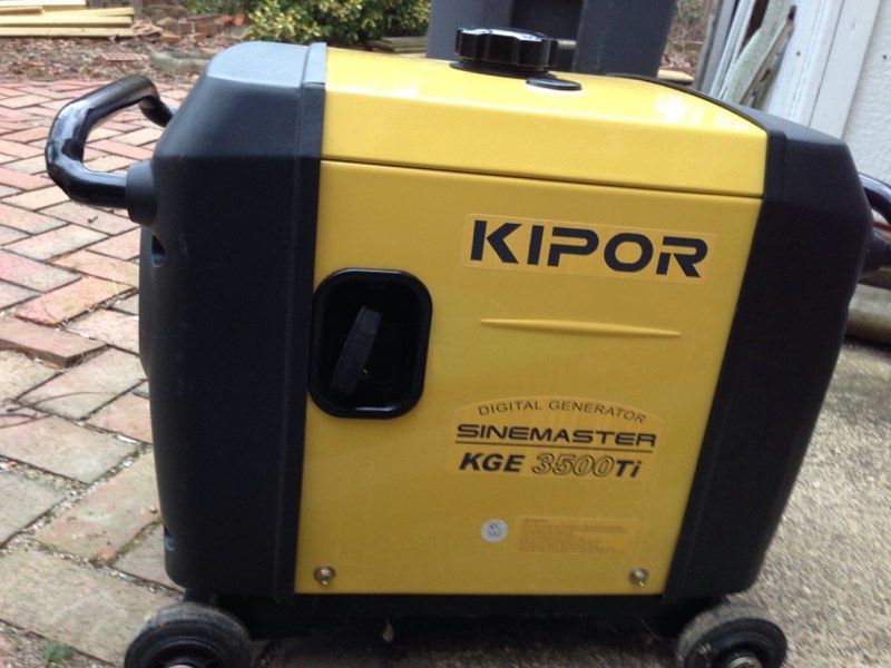

Day before yesterday I tested the generator. No go. Looks like I did not run it dry last time. Anyone suggest self disassembly and cleaning the ports/carb, or just pay someone?

I would clean it myself.Drain all the gas out from the bowl,clean it real good put in fresh gas,maybe change the plug.
Thanks. Disassembly may be a bother, but spring will be here "soon" enough.
What kind of ginny is it?I would have figured the carb bowl would be fairly easy to access.If it's all enclosed,or you have to take an arm and a leg off to get to it,then that's another story.
Some starting fluid directly into the carb may get it running long enough to clean itself out.
Have you tried starting ether? Spray it into the intake. That's what I do when I test my generator every couple of years. Then, if it has open turn the in line gas valve yo off and let it run till it dies.
Good ideas. Ones I should have thought of.
Tomorrow to the auto parts store!
