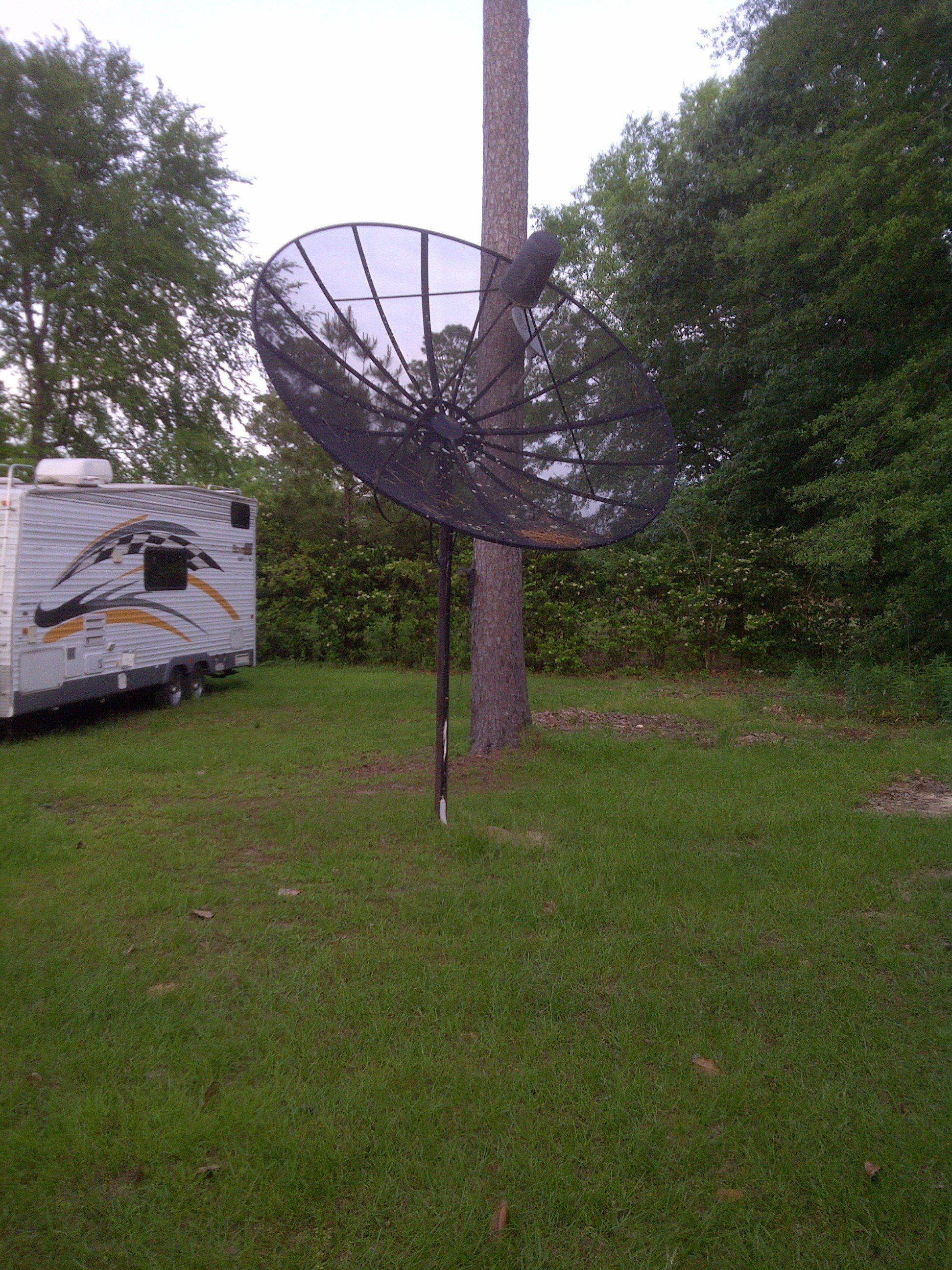

Just talked to a neighbor about this dish, I took a few photos quickly as they were getting ready to leave. Can anyone ID this dish? the feed cap says Sami, but I don't know what size 8ft maybe? District H-20120409-00264.jpg

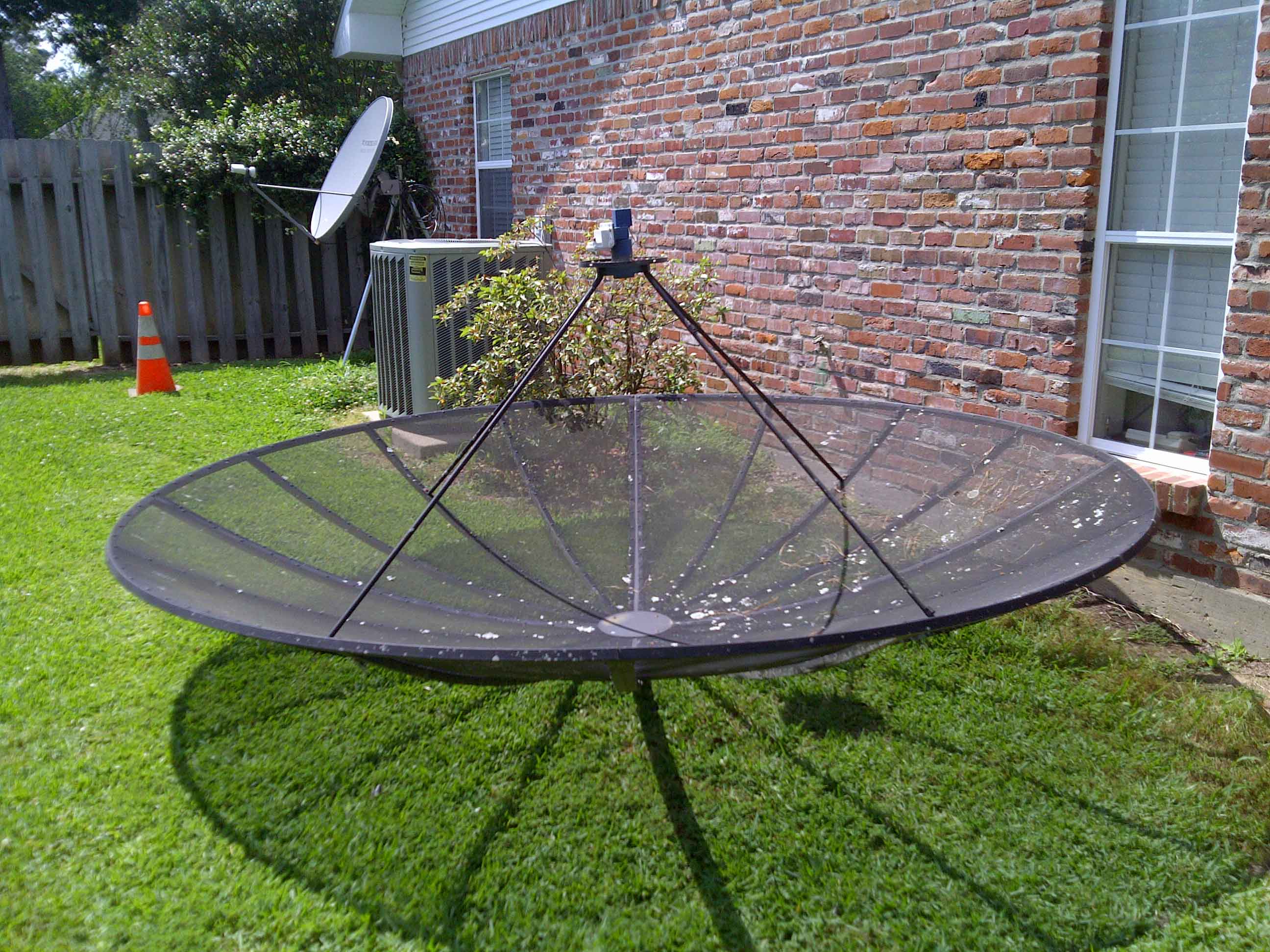

I brought home a 7 1/2 foot BUD tonight with a C band feedhorn and 24" actuator. The dish is in great shape overall but the feedhorn cover is missing. Most likely this is a Unimesh and they were very popular in my area. I have 2 more 7 1/2 footers to pick up and they both have C/Ku feedhorns and covers! :D

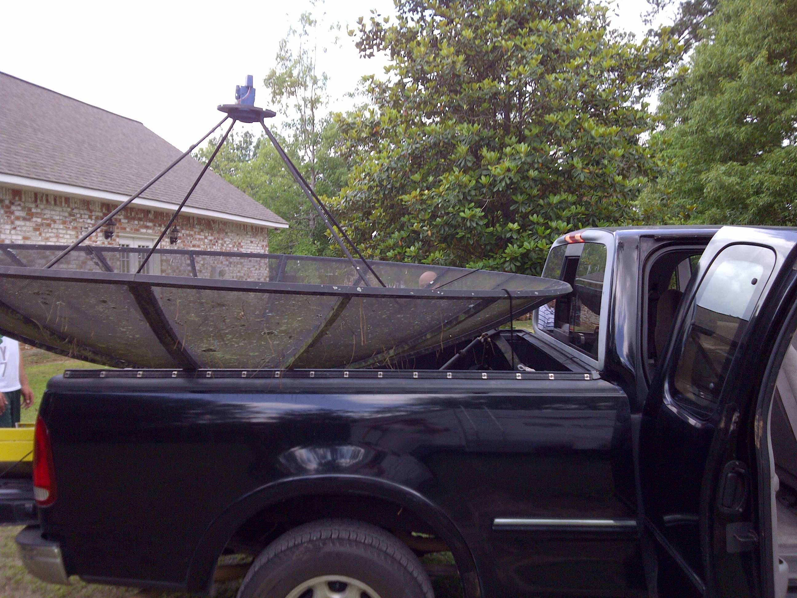

Olegray, I have a 10' Sami that I am getting ready to remove, do you have any tips or notes from the one that you took down? Did it fit in you pickup truck like the photo?
View attachment 74866View attachment 74867View attachment 74868Picked up this 7 1/2 foot this morning, next door where we got the 10 foot yesterday. I was surprized to see it was a SamI. Anyway, I helped them unclutter their yard and brought it home. The home owner thanked me two or three times for taking it away.

johncomp99, the 7 1/2 foot fit in the pickup fine, but we had to take the 10 foot apart in sections, not hard to do. We numbered the sections on the back, so it went back together real easy. Sorry about the delay, haven't been on here in a few days.
I have hauled home 10 footers in my pickup in one piece! I did not have to haul any dish over 8 miles so far. If you could mooch a trailer like for lawn mowers it looks a little bit more legal. A trailer is lower to the ground and easier to load plus it will not scratch your pickup. If it kinda fits... It ships! ;)

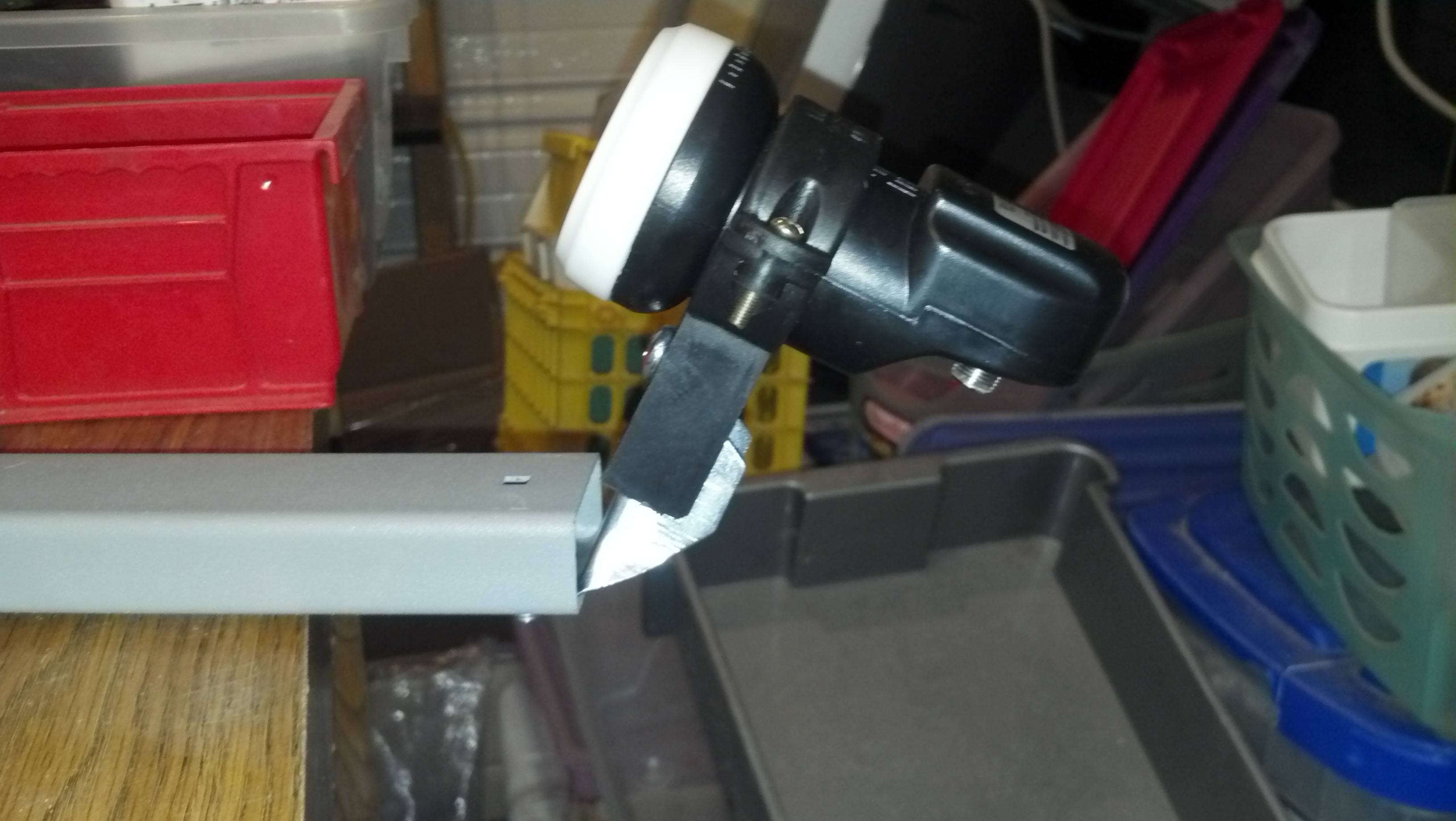

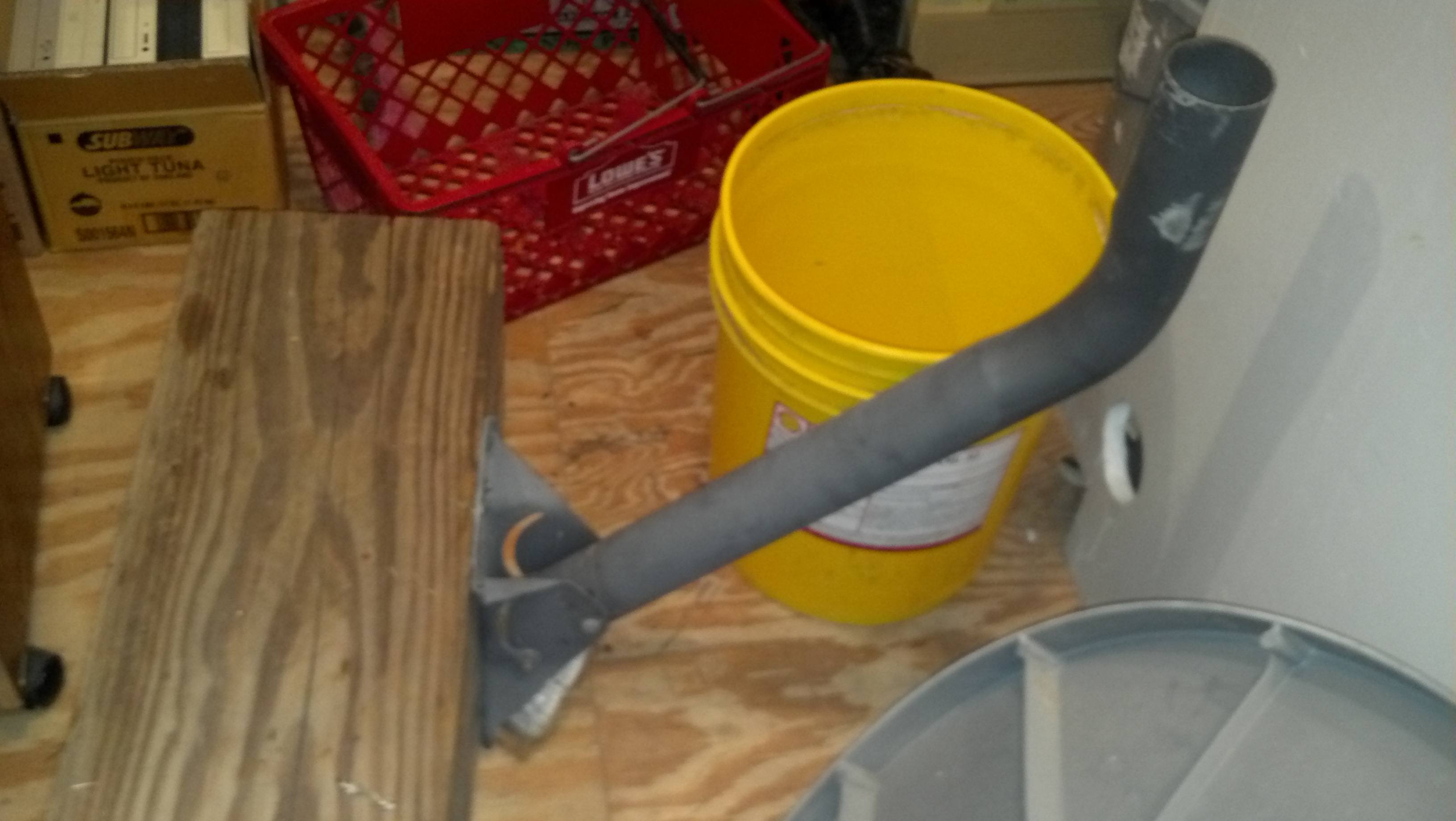

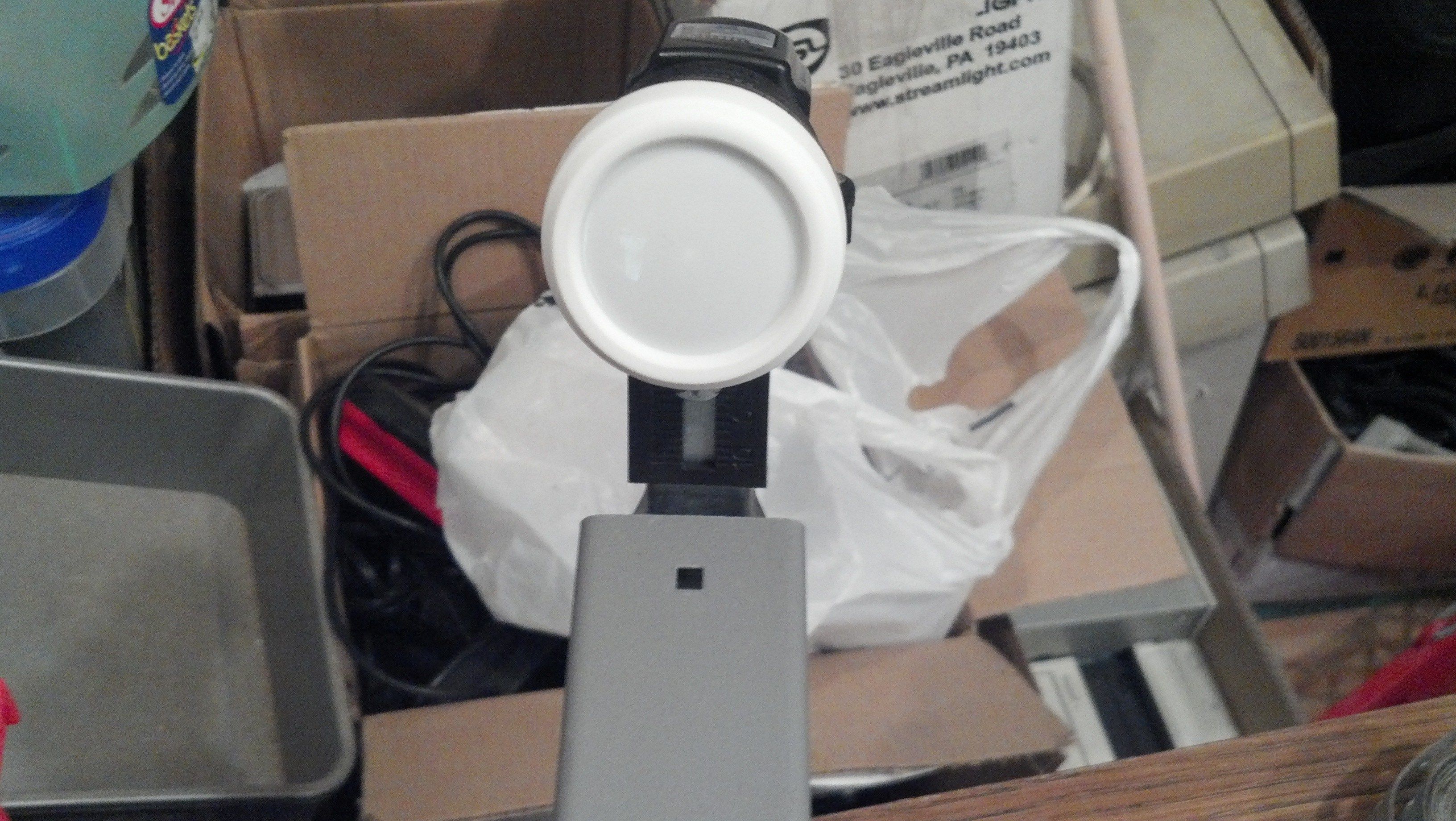

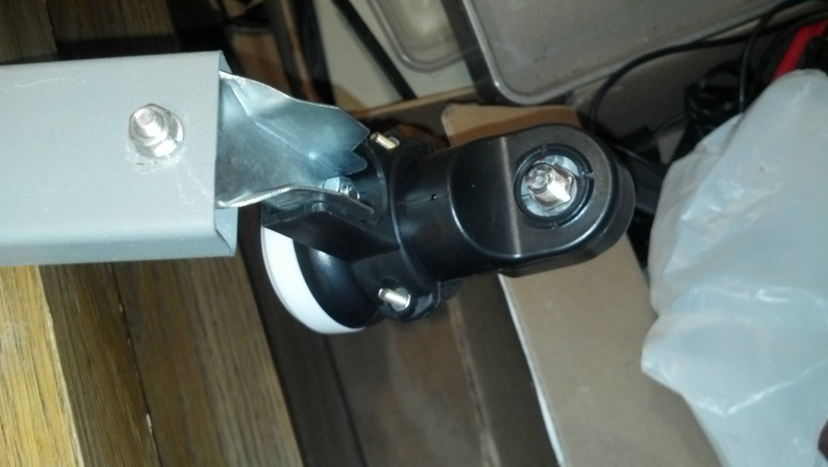

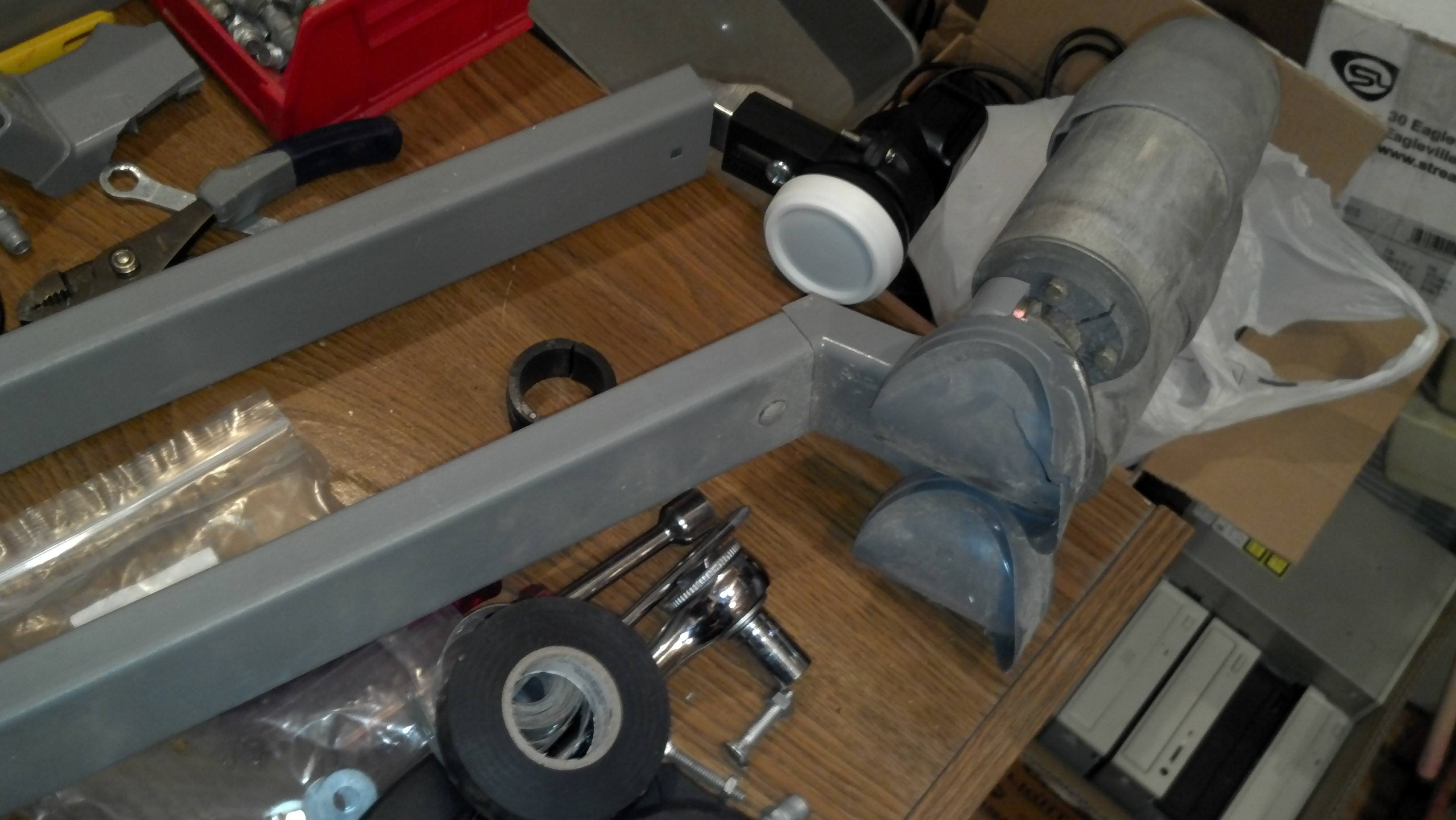

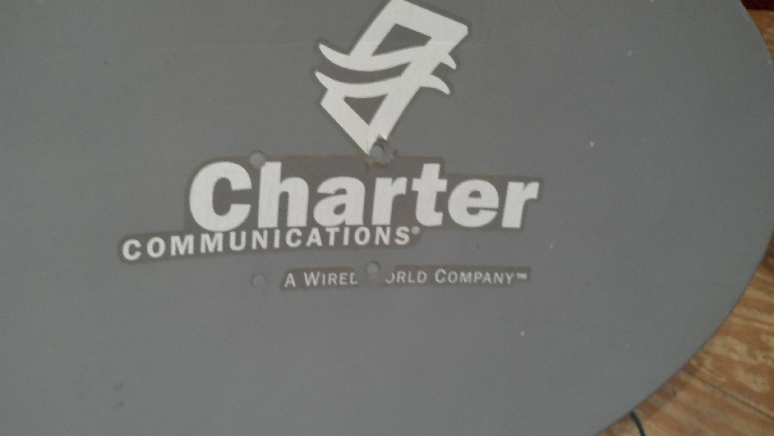

Here's some pics of my PS/Charter dish (One of MANY!) with NEW LNB mounted on arm & PICS of Original Charter LNB arm,etc.I'm using one of the DUAL Charter dishes to get AMC-9 & Gal-28 (Receives Sats 6 Degrees apart).Have quite a few of these & still spied a few more around here!Got a few ROUND PS as well.Have a 1.2 M CM also on Gal-19.Still have to take down the MONSTER 12' Fib Dish i mentioned & Possible other 10.5 solid dish.Well hope these pics help
someone. Thanks for a GREAT Forum!
2 Inch Wall ount On Post.jpgCharter Dish_Same As Primestar.jpgDIY New LNB_Bottom.jpgDIY New LNB_Front.jpgDIY New LNB_Side.jpgPS Dual LNB's & DIY New New LNB.jpg

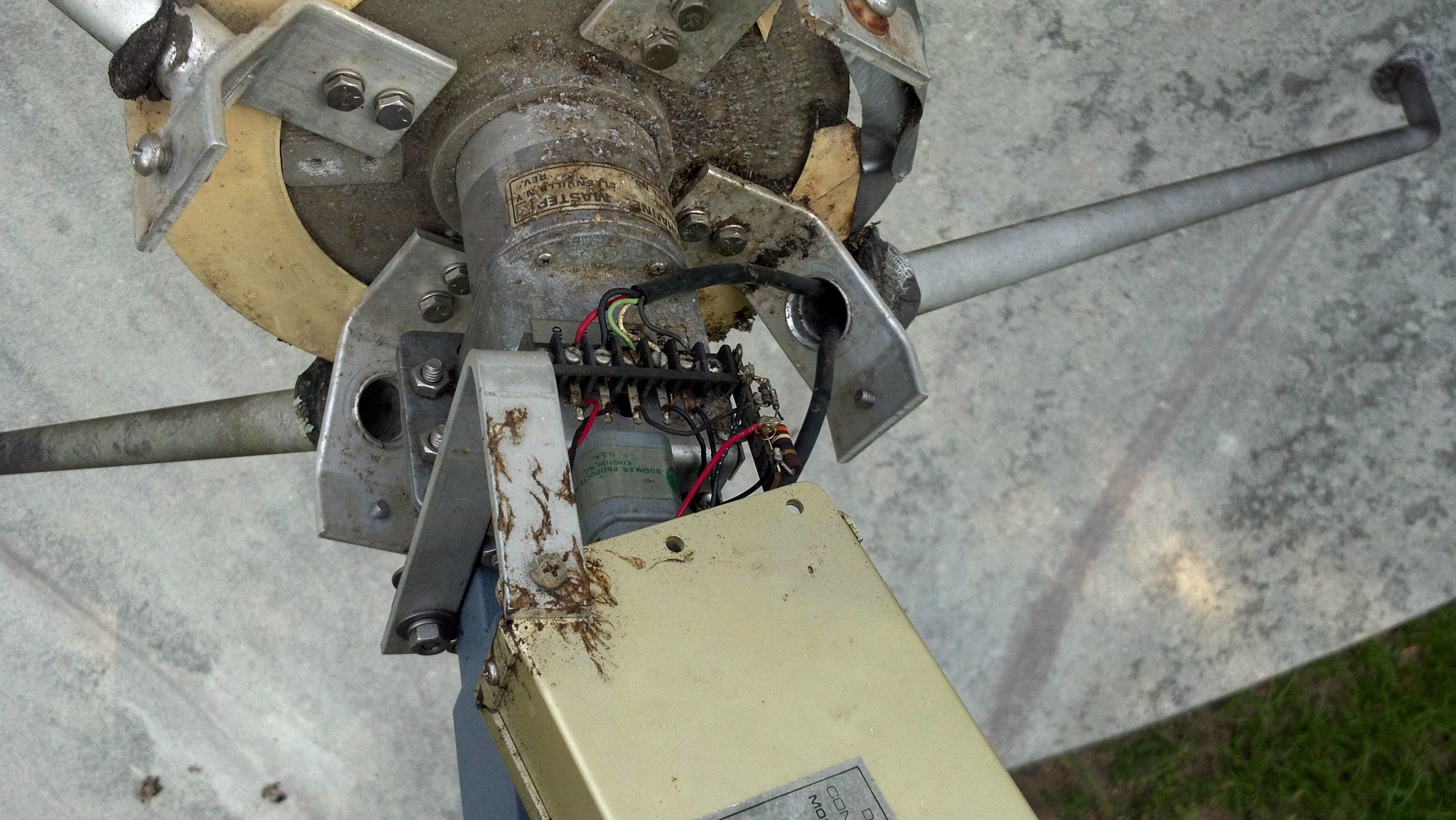

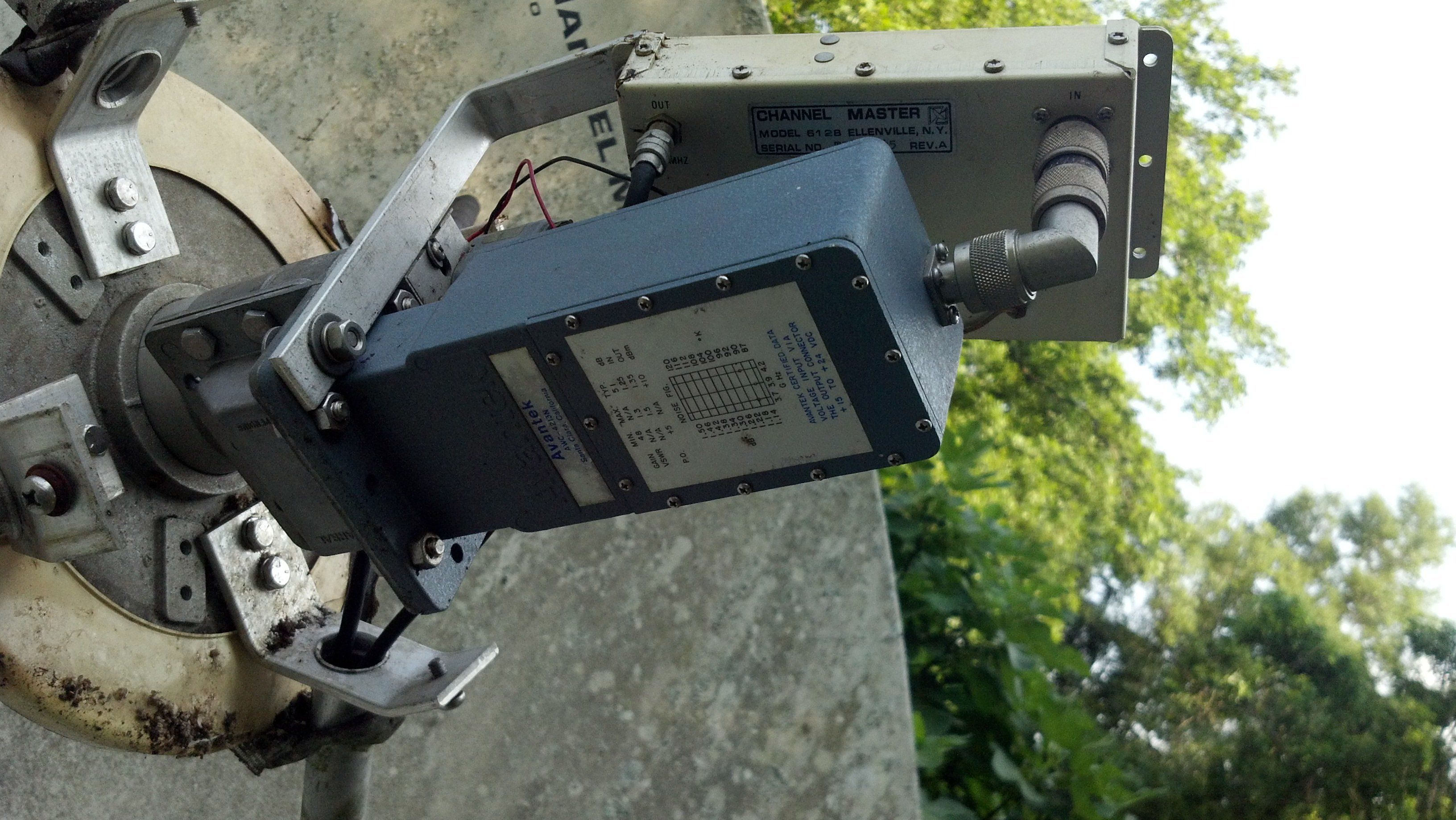

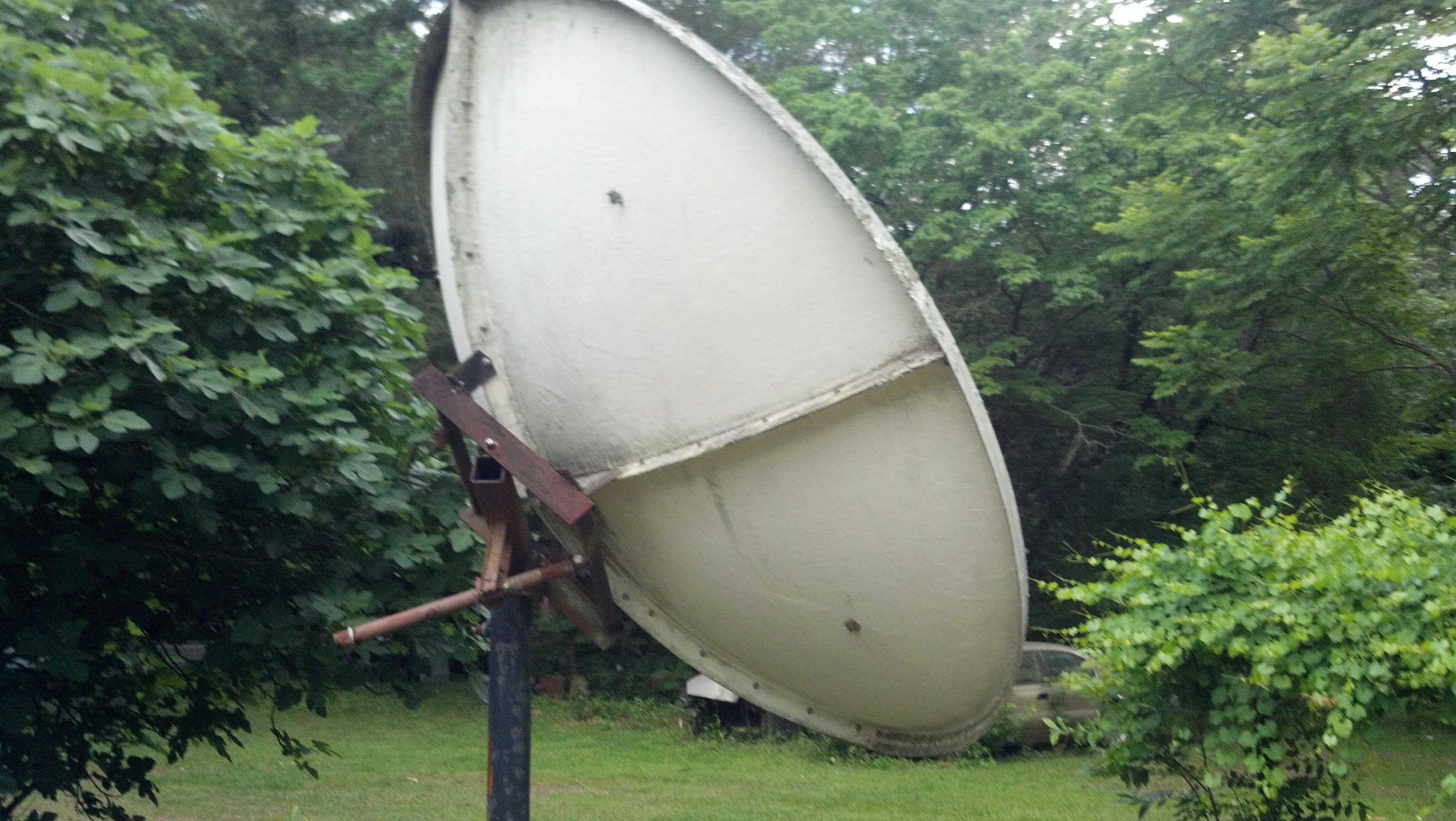

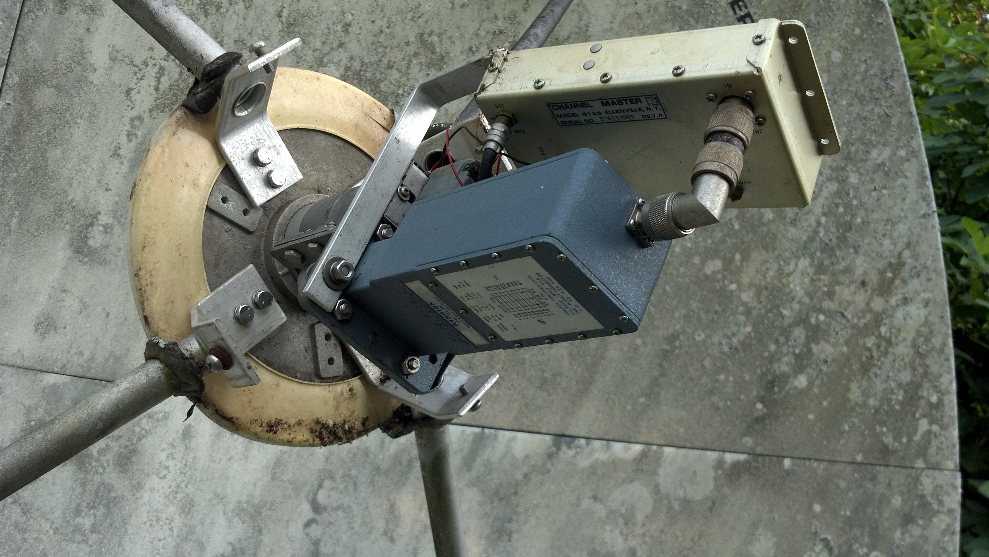

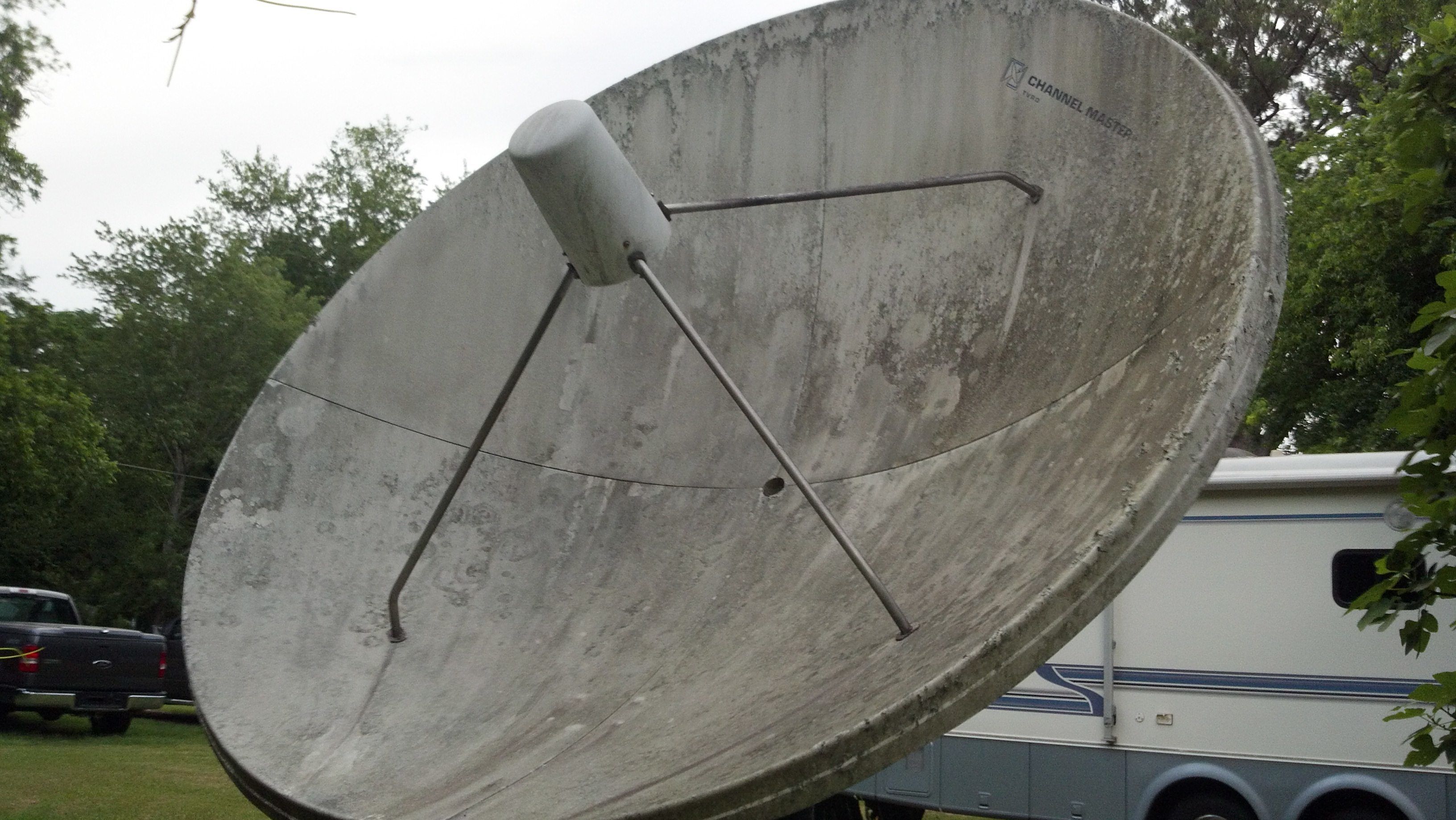

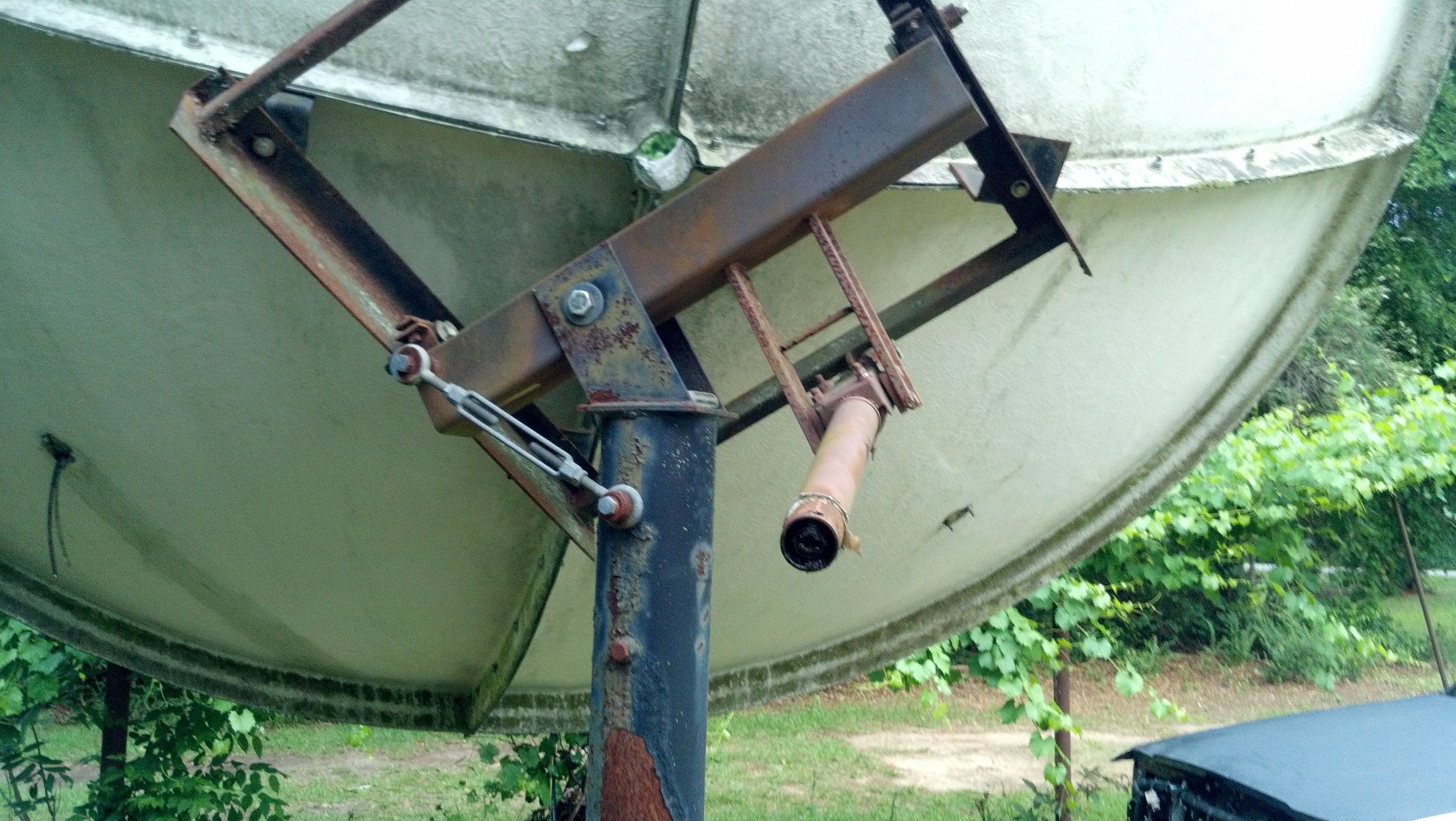

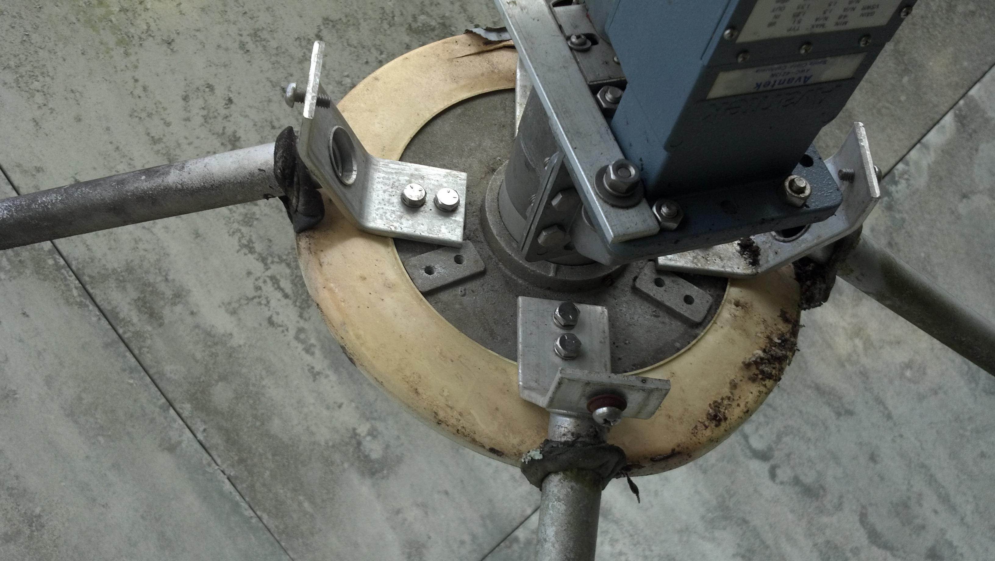

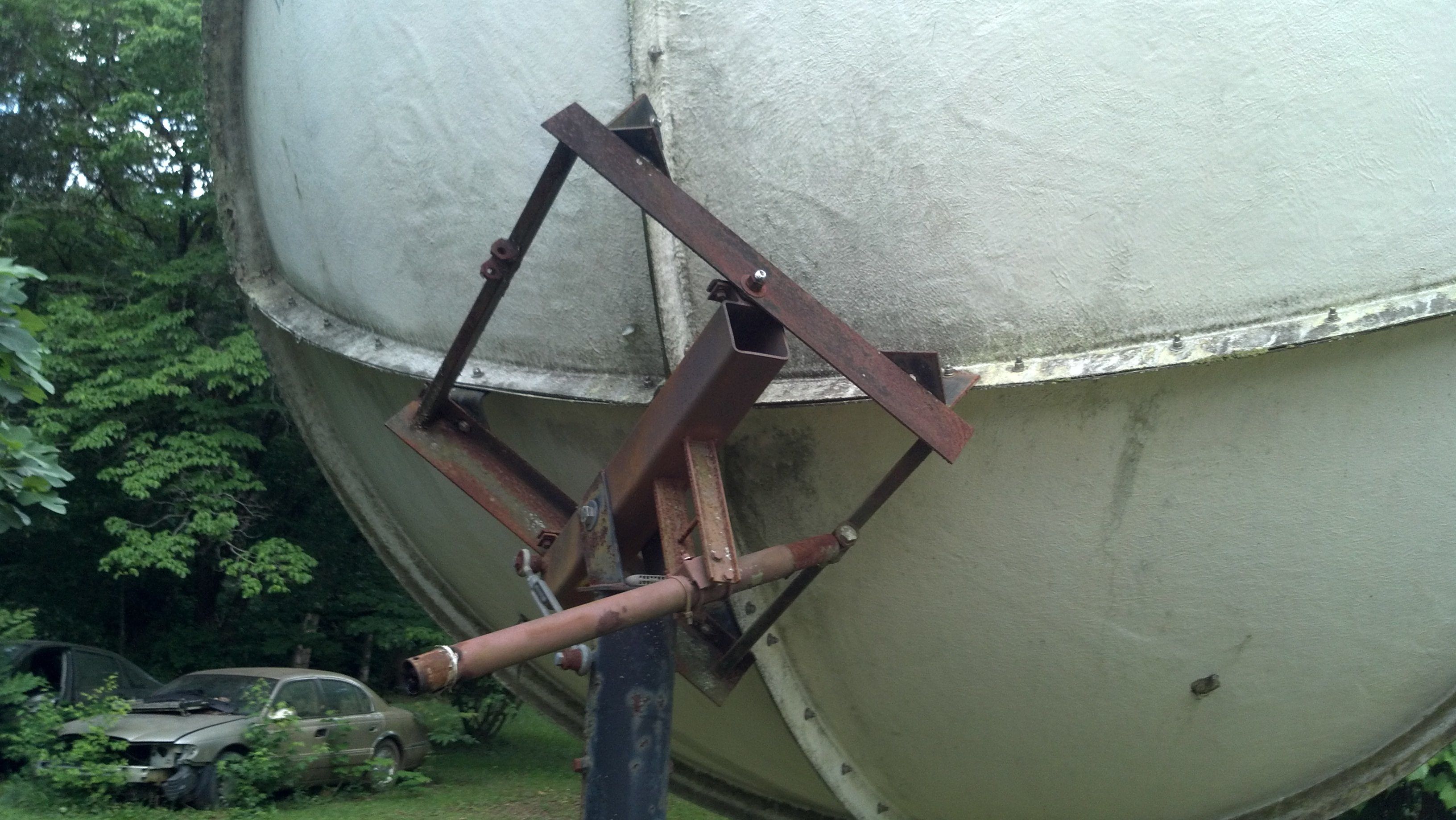

Finally got to check out good & start taking apart the 12' Fiber Dish i mentioned.Well.... turns out it is just a VERY WELL BUILT,DEEP,COMMERCIAL TYPE 10' FOOTER! Didn't have the heart to tell the old guy.(He swears it's a 12' dish). The 5-6 Inch mounting pipe goes all the way to concrete slab poured about 5' square.There's another pipe,full length i guess that goes all the way inside it.It has setting/clamping bolts at 3-4 places along the pole.Got the LNA (Avantek AWC-4213N),Downconverter (CM 6128),Scaler ring & one Panel off it in short time i had this evening with it. Got some pics including LNA,DC, & mount i'm posting. Anyone with info/help/advice on this one FEEL FREE to jump right in! :cool:
Front_All.jpgBack-All.jpgMount-Back.jpgMount_Close.jpgFeedhorn & Mount_Close.jpgLNA & DC-1.jpgLNA-DC_From Below.jpgLNA-Rotor_Wiring.jpg

That's not a commercial dish, but a very good one. I have one just like it, and it was equipped just like yours was. Yes, they are built to last. Mine outperforms my 12 foot paraclipse on S2 signals, so its a keeper indeed. Lemme root around here, somewhere I have a thread when I got mine....ah...here it is...
http://www.satelliteguys.us/c-band-satellite-discussion/256824-how-did-i-get-into-mess.html
Have FUN and ask away if ya have questions.
Thanks for the INFO! Really meant it's BUILT like a Commercial Disc.He actually got it from Rat Shack in '83 i think he said.You using standard NEW type Feedhorn/LNB on yours? Man the solid Aluminum scaler is awesome.Glad to hear it performs good.Got the S9 HD PVR on two ku Band (One Dual LNB's) now.Really wanting that C-Band also! You getting GREAT Ku performance also? Thanks again for post.Like to see that thread for sure. :)
I didnt mess with Ku on it, no reason why it wont be at least passable on Ku, my thread will show you it has ku mesh under that fiberglass. I have a c-band orthomode feed on it now, no ku. I took the stock feed/scalar off of it, and added the ortho, mine was too far gone, corrosion had ate it up. BTW you do NOT have to have the 5" pipe for it to work with the sleeve, I put mine on a 4" pipe that I already had, put longer bolts in it, and it works fine. only thing is its HEAVY, as you already know. It was pretty easy to get dialed in, too. One thing I did find is that a el-cheapo actuator will NOT move it, its too heavy. I was fortunate that the Saginaw actuator that was on it worked fine, I just had to find a dish mover to work with the old potentiometer saginaw.
Feel free to PM me if you have questions, or just post to my old thread. Its a straightforward install, probably the easiest in my farm.:)
