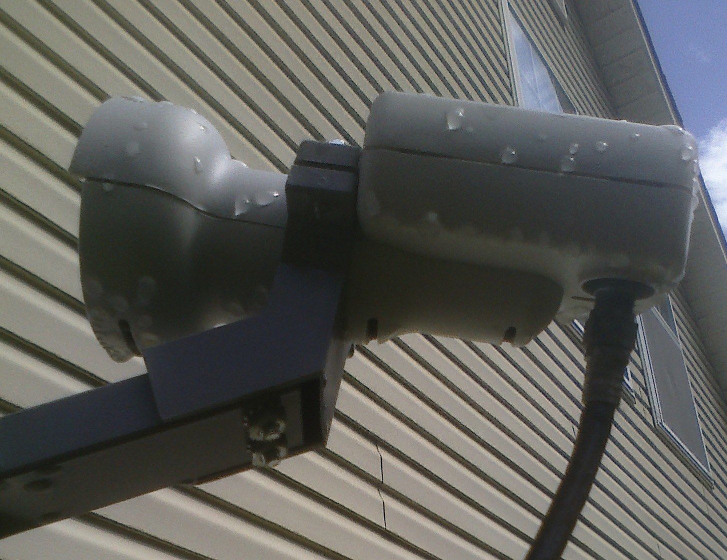

Could you post a picture of how you have the LNBF holder mounted to the dish arm? Sliding the LNBF forward and backward in the holder may or may not lower your signal enough to lose it, depending on how strong a signal you're aiming at, but if you've somehow got the holder mounted wrong, you might have it pointed at the wrong angle altogether.
I can't find a clear picture of your dish model at the moment, but if it uses one of those LNBF holders where the part that attaches to the dish arm looks like |_| , then it's meant to be slipped over the end of the arm, NOT sitting on top of it.
Here's a shot from the ground of the LNBF mounted in the arm.
Pushing it back is usually a good place to start, but I'm not sure if pushing it forward would cause a complete loss of signal. But I don't have his dish, and I don't live in his area.

You can try sliding the LNBF inwards/outwards in the mount to adjust the focal distance, but I generally set it right in the midpoint to get started. It shouldn't be extremely critical and as Jim S. stated, it shouldn't cause a complete loss of signal to have it set all the way in or all the way out. It will help you fine tune it for a better signal quality reading, however.

Minor change in strength but no change in quality still 0% when I move the lnbf around. Tried full front and middle. I did however notice the amber plastic pane was not entirely flat, it's a tad wavy not sure if that's an issue or not.
