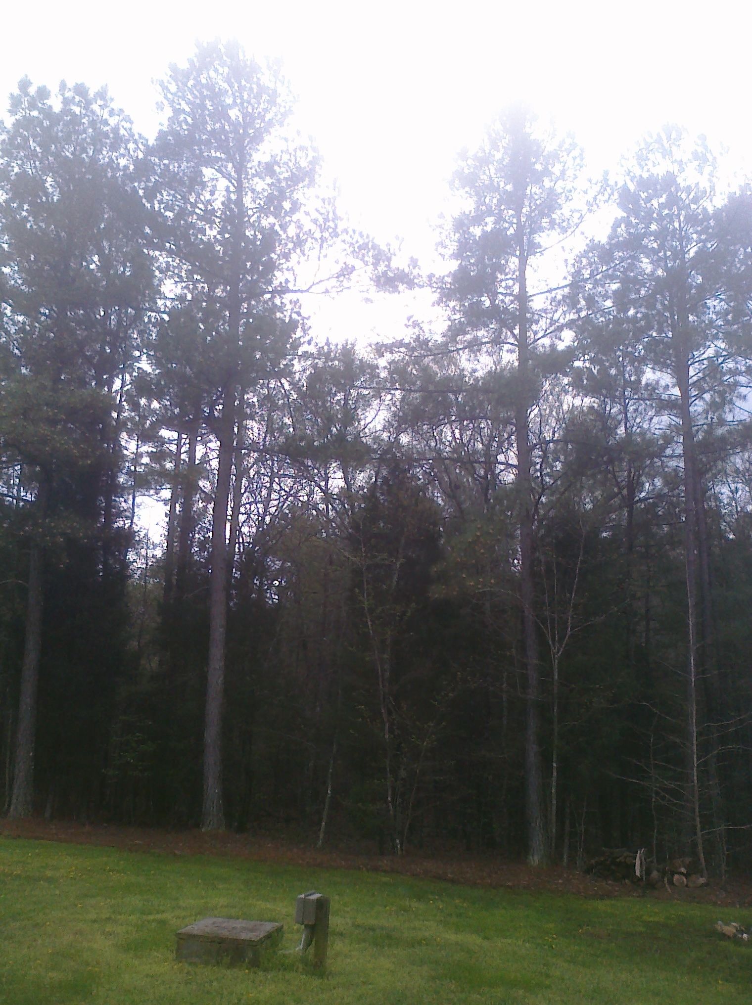

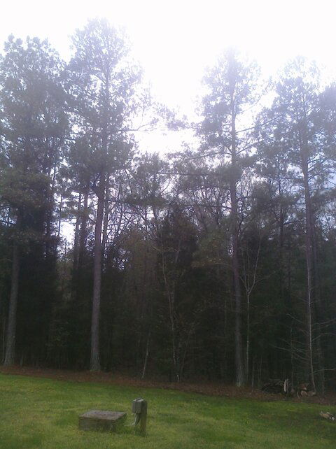

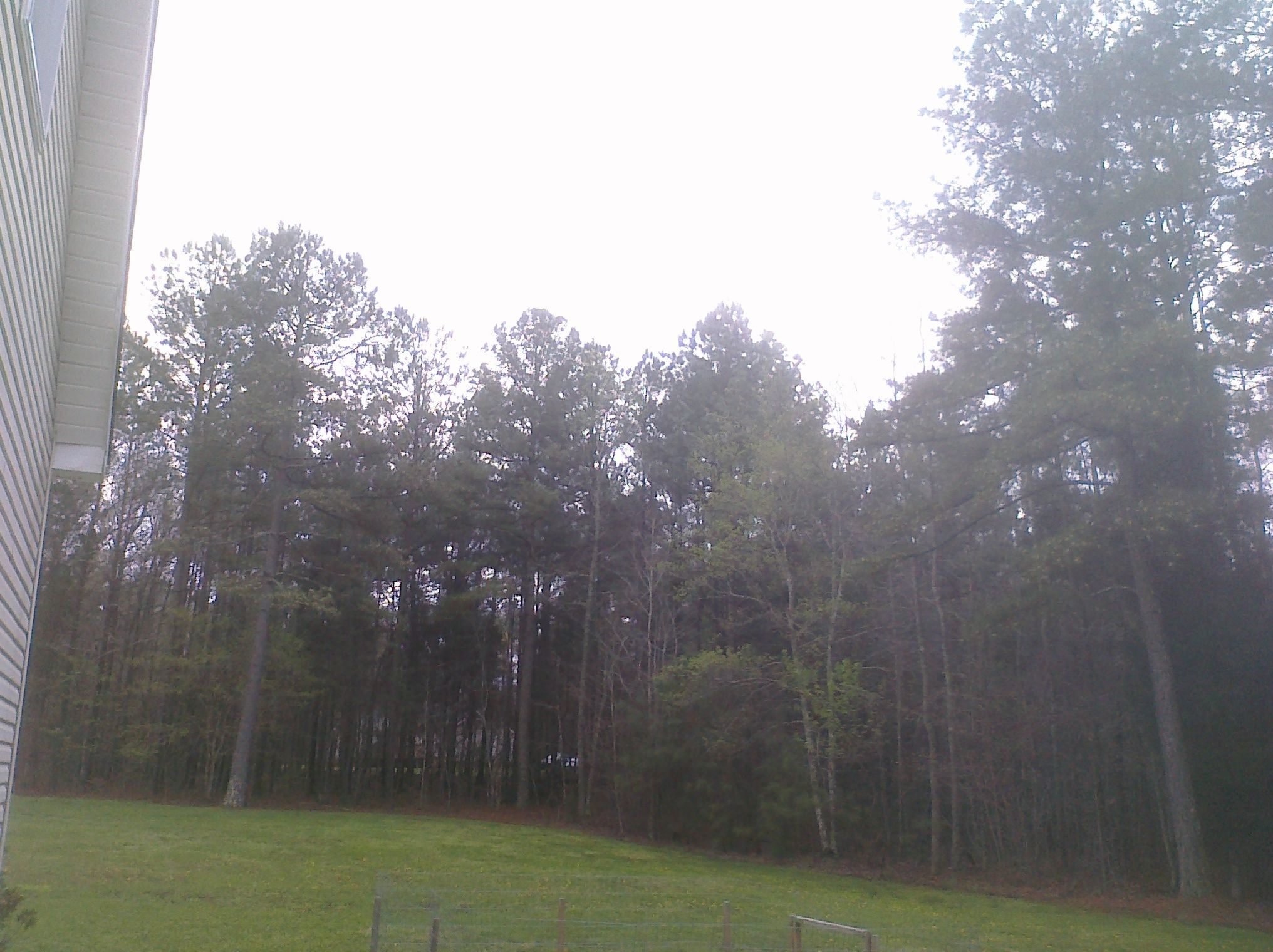

How about a photo of your southern horizon so we can see what's up? Is this new equipment or used?
Equipment is new. Photos....
Dish is about 6" above my head....
South on the compass, tree line here is about 150'
217 deg would run right down the middle of these, where this tree line is about 70' away. Hence my worries about Galaxy 19....
That's a lot of trees! They may or may not be a problem. It's a little late for this, should have done this the first week of March, but you can probably still use this calculator to determine where the sun is in the sky. This calculator tells you when the sun aligns with the sats. You go outside to the dish and view the sun on the dates and times that it is supposed to be aligned and if the sun in in the trees, then the satellite is blocked. If the sun is above the trees then you are OK.
Because it is three weeks off, it won't be entirely accurate, but it might give you a rough idea.
Sun Outage Calculator
You might have to set your dish on the top of your roof so that you get a good LOS.
