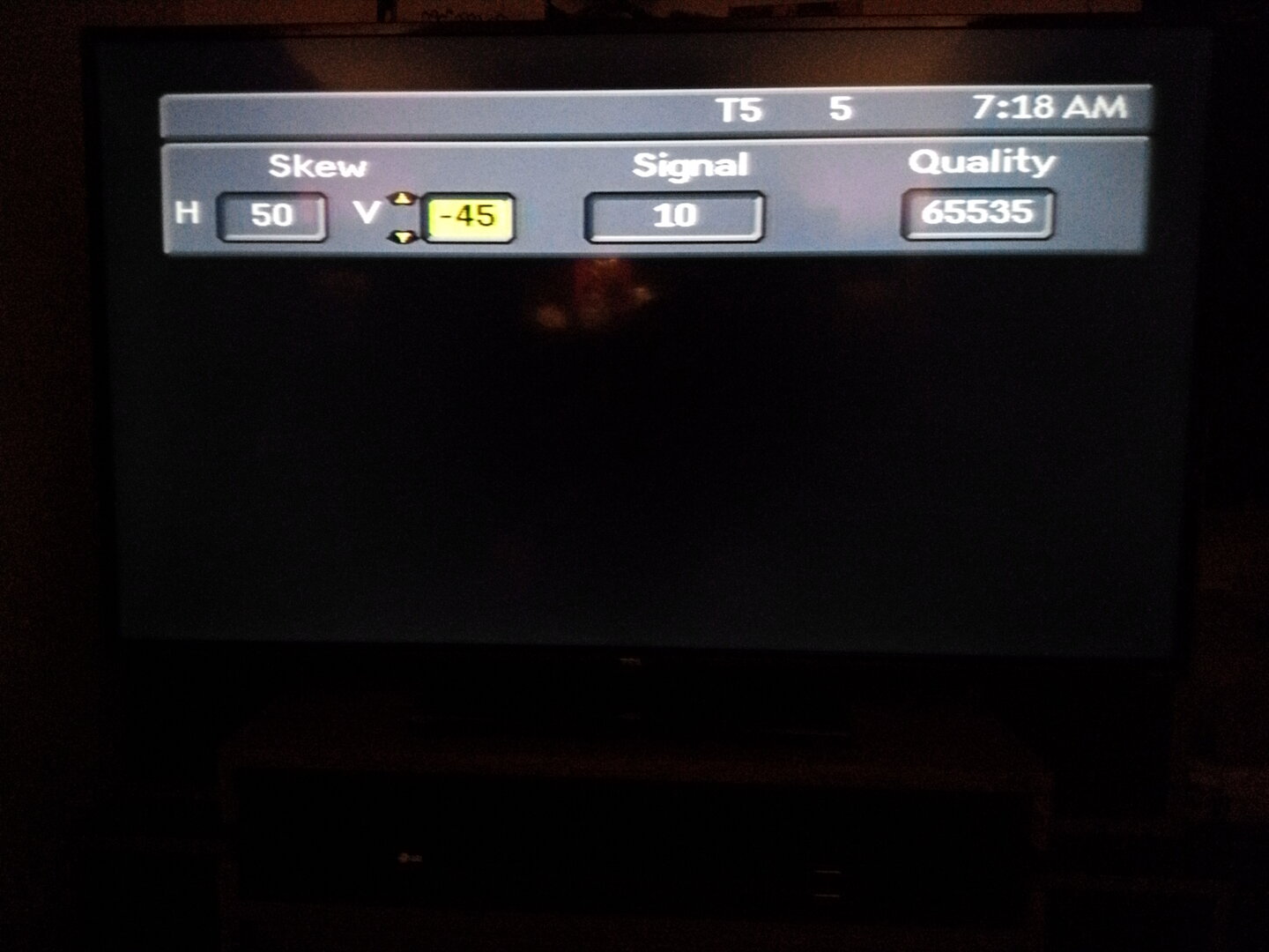

After trying for 3 hours still no cigar. I haven't played with my setup for over a decade now so I will have to get back into the swing of things.
I have the following satellites programmed into my Drake 1724 ESR; W2, W3, T4, G7, T6, G3, T5, G4, W4, W1, F1, E2, E1, G9, G5.
Moved it over to T6 and did an Auto Scan scan with my Captive Works Ultima and nothing. Then move it up to G7(W7) and did another scan got like 3 channels for subcription ad. So I am not sure if any of these two are at 97w ?
Is G7 the Galaxy 7 satellite? If so, a search showed that one at 96W with a failure in orbit in November 2000. That would put you near 97W if everything is still in alignment.
Reactions: EdT
Think G7 was, at one time, at 91w, and the scrambled channels EdT got probably were the Wright-Patterson channels, and T6 was at 93w (and nothing is there now). T5 is on the other side of G3, and my searching shows it was at 97w. Ah the old satellite names! It got really confusing once they started moving them around. It was at that time I went by orbital positions rather than satellite names!
