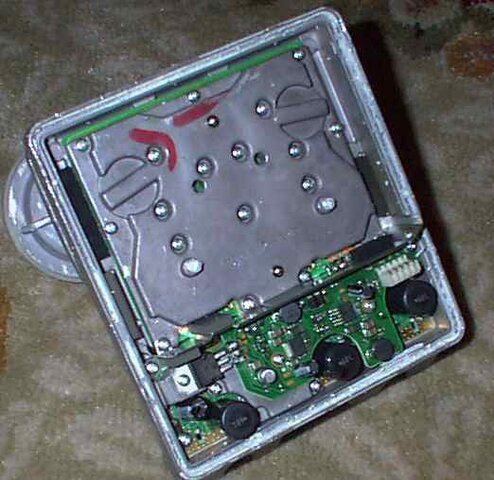

As promised, I have disassembled my DPP twin with an eye toward cannibalizing it for it's DPP32 switch. The first picture is of the assembly with the back cover plate removed. The second is with the cast Al back plate/waveguide removed. The black circles surround two small coax cables coming from behind the LNB PC board. The question of the hour is, can I solder in two coaxes coming from my DP34 feedthrough and have this work as a DPP32 switch?

Probably not, The DP34 feedthrough is a DP bandstacked, Diseqc controlled signal. The raw feedhorn signal is not bandstacked. You need to find the point between the DP circuitry and the DPP circuitry.

I wanted to report great success with my cannibalization of a DPP twin for it's switch. I now have what amounts to a DPP32 switch. I did this to conserve cables from my attic to my basement, since the previously-announced DPP33 has never been released, and since I didn't want to spring for a DPP44. My DPP twin cost me $20.
I soldered 2 2ft RG6 cables onto the lower PC board where the tiny coaxes from the LNB/feedhorn assembly formerly were. (I circled them with black circles in the 2nd picture above.) I threw out everything I no longer needed, and cabled up the aforementioned 2 cables with a 3rd on the DPP twin's input (for 61.5), and attached them to the feedthrough connectors of my DP34 switch.
I attached the DPP splitter that came with my 625, and now it reports "DPP twin" for the switch. All satellites are visible as they should be for both tuners, and the signal strength looks the same as before. Works great! :D

I'm afraid I didn't take any. I threw out the LNB PC board (copper and green board on upper-right in the 2nd pic above) and the waveguide/backing plate (dark gray piece on the left in 2nd pic). I also unscrewed and discarded the upper feedhorn assembly, which is the part with the white plastic cover. This leaves only the integrated lower feedhorn assembly with the switch; 3/4 of this odd-shaped box is empty. I simply fed cables through the mylar windows covering the lower feedhorns, routed them to the switch PC board, and soldered them where the little ones formerly were (inside the black circle). I closed it up with the silver back plate for RF shielding, but didn't bother sealing anything since this is now cable-tied to a rafter inside my attic. It's not pretty but it works.
You can buy plastic enclosures at Radio Shack. You might even be able to get some metal ones there. Another possibility is to gut a DP34 and mount it inside of that. Just solder on some F-barrels on those contacts you circled.
