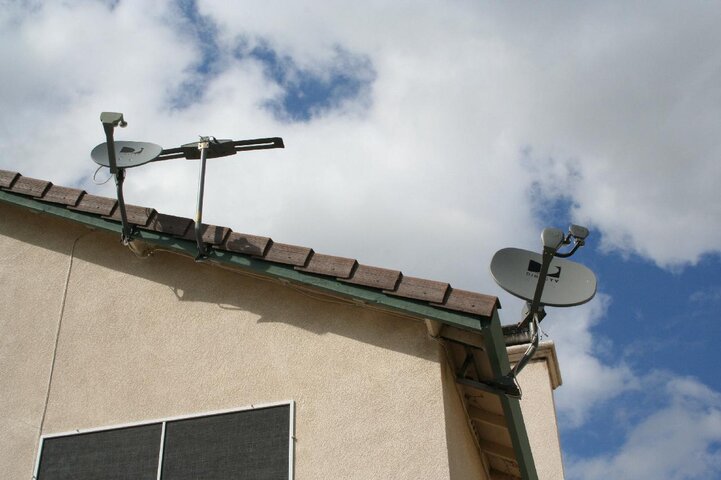

Take a look at mine. I had a custom bracket made.
directvfreak said:
It looks to me, your is going to fall when some wind cones along.
I hope not. My installer said that he hung from one of these (he weighs 200 lbs+) and it supported his weight. We've had some strong winds the last couple of weeks and it hasn't budged.

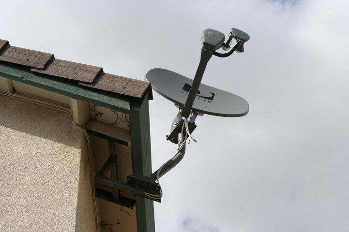

Yes, I had seen your pic previously and wondered if that was an off-the-shelf bracket or a custom job. Any reason why you didn't just mount the base on the eave - it looks like it is a very sturdy 2x8 plank. What about mounting some columns attached to the eave to support the tube?
I think what you are looking at is the gutter. My previous dish is mounted to the eave on the other wall. It doesn't have the surface area for the base, and I'm not sure about the sturdiness. The bracket I have was custom made, bolted to the 2 2x4s with a total of 6 bolts. These 2x4s are more stable - like bolting it to a wall stud, or so I'm told.
cal87 said:
Green structure on side where AT9 mounted - gutter
Green structure where old dish mounted - wood
OK now I see I just looked at the other pic with the old dish and OTA mounted - yes so you couldn't mount it on the gutter maybe made of plastic resin or metal destroy the gutter watertightness.
By the way, on the custom mount how does the end of the "L" get joined to the "I" beam - is it welded or bolted? I can see how a 200 lb person could be supported by the bracket in a dead weight but I would think that the torqing motion of a heavy wind pushing on the dish and leveraged by the length of the dish tubing and part of the "L" could crack the joint between the "L" and the "I" - the weakest point.
It's welded. As for the "I" part - I don't know if you can tell, but it is 2 parts, one sliding inside the other to accomodate different widths beween the 2x4 beams.
Is it strong enough? I hope so, but who knows. Like I said, we have had some strong winds lately, and I have not seen any movement looking at it while the winds were blowing.
Ouch, that dish will fail. It is not installed to specs. There are no stabilizer arms on it. It will move out of alignment over time.
cal87 said:
It's welded.
It is likely that hairline cracks in the weld joint will develop from the movement from the wind leading to catastrophic failure at some point in time. A column support would prevent that failure, but the cables may also prevent the dish assembly from falling to the ground.
The AT9 is mounted on the fascia, the other is on the rake board.
Thanks for all of the input. I have been wondering about the stability of this mount. I'll keep watching it in the wind and keep an eye on the signal meters.
So far no signs of anything, but I'll keep a close eye on it. A guy down the street from me has the same install, so we're both in the same boat.
