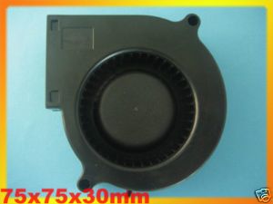

I have tried a bunch of different fans and ideas, this one seems to be the most efficient and the quietest.
They go for about $6 on eBay. I used double sided tape and taped it to the left end corner (over the vent slots in the case) of my 722 with the exhaust port facing out the back (sucking hot air out of the receiver). The only problem is that these fans come with a regular PC connector so you have to cut it and solder a USB connector to it (make sure you use a 5V blower that draws less than 0.5A).

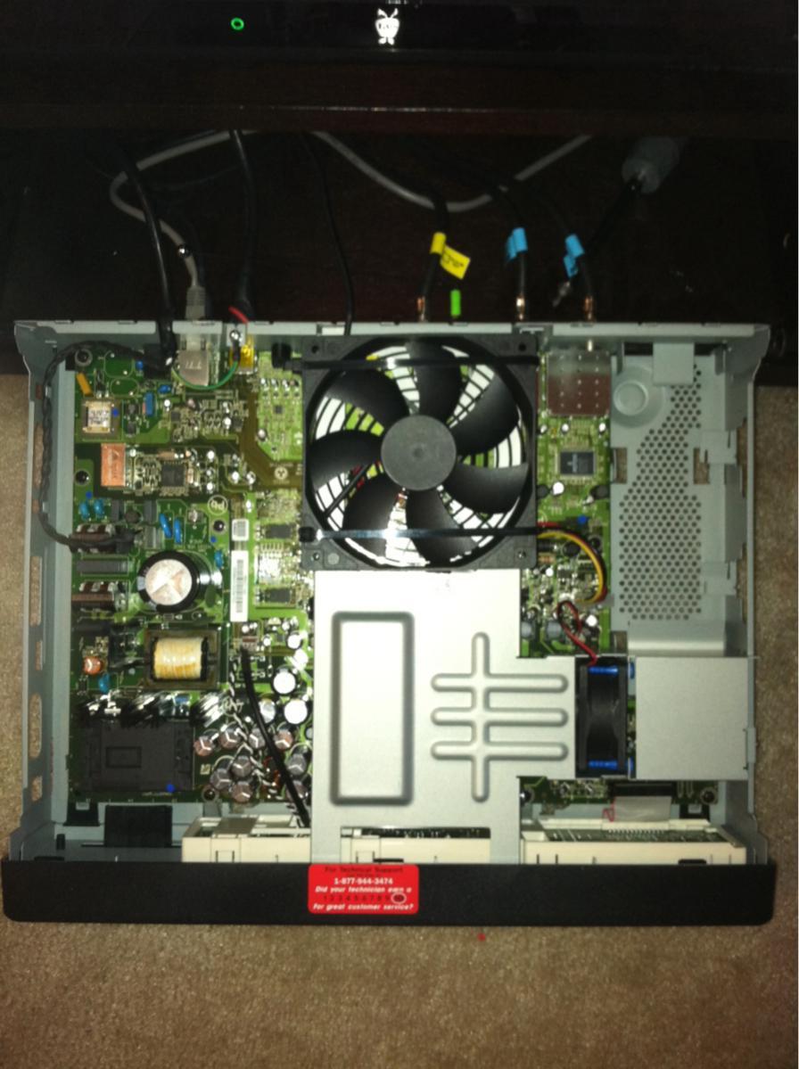

I've had the cover removed, but it's so tight the AVG is running 127. I just installed the 1200rpm Coolerguys fan last night. The from that runs back to front, that has some open area above the chip, is where I mounted it. I used to have the Thermaltake here on my older model and it did well. I used zip ties to secure it, and its whisper quiet. Be curious to see how the temp comes down, I may do the same on my Tivo.

When I pull it back out Friday to put the OTA tuner in, Ill take a picture. It's kinda funny, looks like it is ready for a vertical take off and landing.

Took picture of the fan, avg temp has dropped from 127 to 123 in two days.
