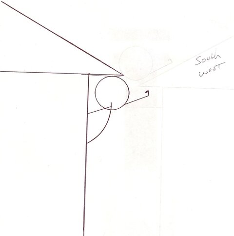

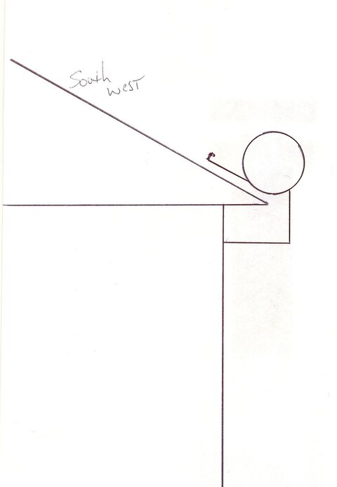

Ok tell me what you are talking about Option 1 or Option 2

Option one is a standard wall mount included in a standard install. Except that you said it is Stucco. Again Stucco is a no go for most install companys.
Option 2 is not standard and would be a custom mount. I dont even know where you would get a mount to do this.
Liquid it's option 2.
Why wouldn't this work: Dish Mount Products ? (Using the New slimline Wall SLW-250 I mentioned earlier today), but face the dish toward the building, while tilted upward toward the satellites
Why wouldn't this work: Dish Mount Products ? (Using the New slimline Wall SLW-250 I mentioned earlier today), but face the dish toward the building, while tilted upward toward the satellites.
Niether is a standard mount, and looking at either one I would not use them. They both do not look like they would spread the wind load that a KA/KU would apply.
