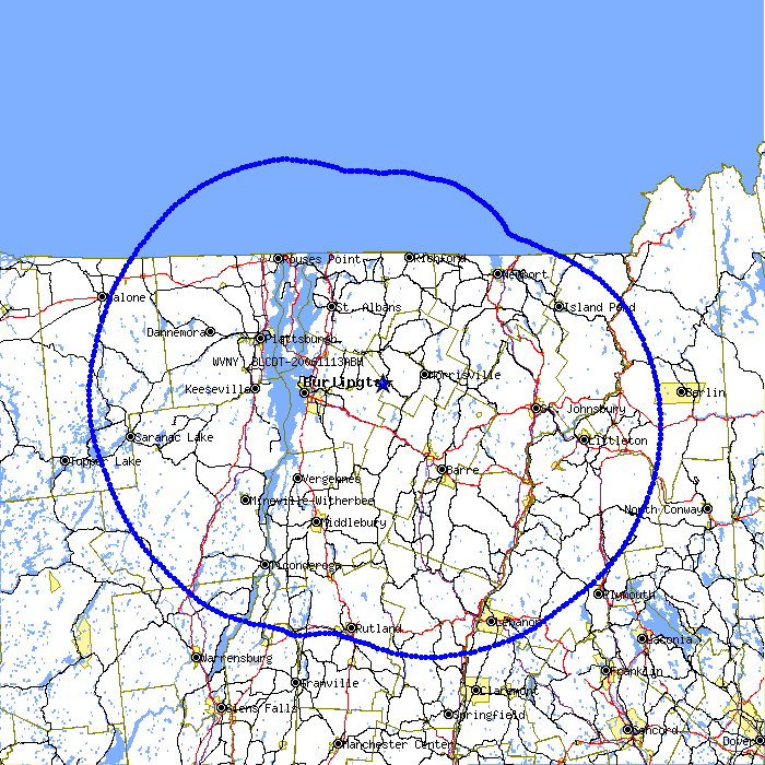

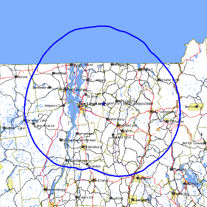

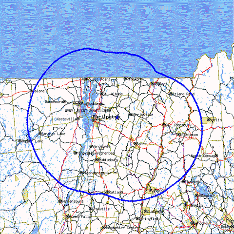

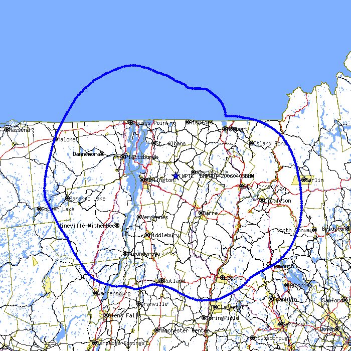

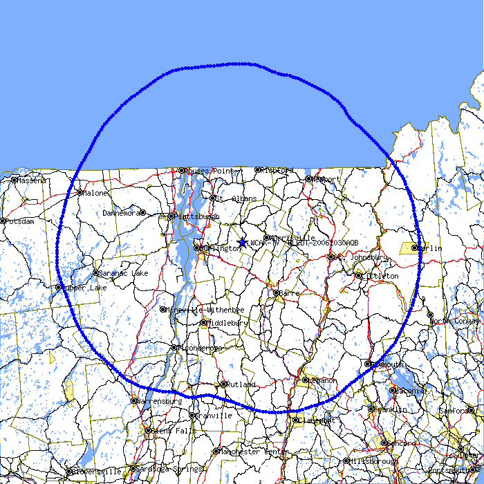

Sounds like my situation. I'm in a valley, but about half way up a western facing slope. The towers I'll be shooting for are roughly at 20 degrees compass orientation. I'm at 700 ft above sea level and the towers I'll be shooting at are a little over 4000ft which is the only plus in my situation. Looking at the Longley Rice coverage model I'm just outside of the coverage area...a little south of Rutland VT (next little yellow area south of Rutland). The last station is ABC but it's on the VHF freq.
WCAX-CBS Burlington.gifWFFF-FOX Burlington.gifWPTZ-NBC Platsburg-Burlington.gifWVNY-ABC Burlington.gif

the 4000 elevation does make the situation better. you are in a valley . if there is a ridge blocking line of site to 4000 ft. in between you are screwed.
