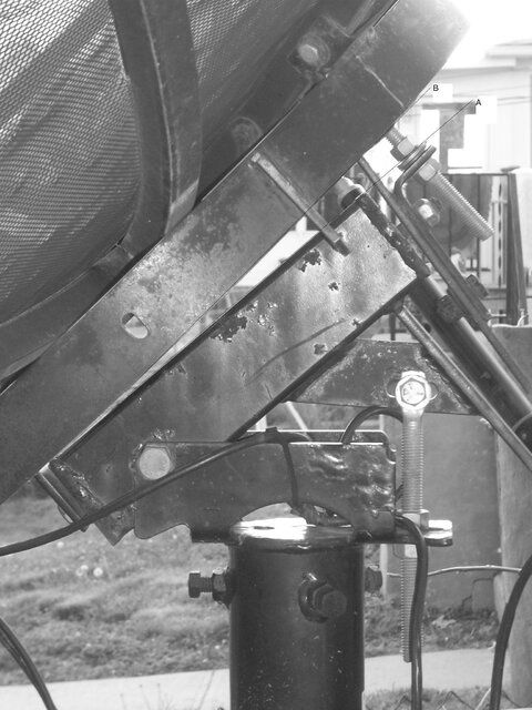

Setup my first BUD years ago, and although I can find all the same documentation I am losing in setting up this one.
I am at 94* 49'W 39* 45'N making my Galaxy 3C my true south satellite, which would put my declination angle at 40.21*, declination angle at 5.51* and apex elevation at 44.29*
In the attached picture, point A is my apex elevation and point B is my declination angle?, is this correct?
This is were I am losing, I have set the angles as stated above, even switch them because I was not getting anything.

declination
Yes stick your angle-finder to the backside of the ring (SURFACE B) to measure
declination. I find it easier to do with the dish at due south, jus because the little magnet base holds it better that way , haha.
