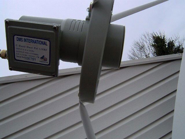

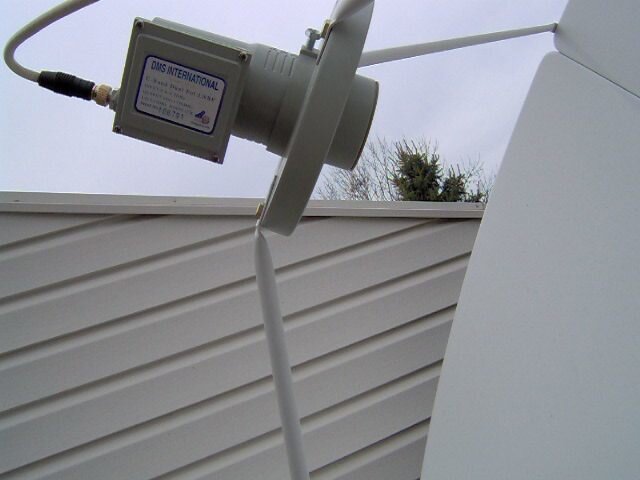

no. Most LNB's have holes on the scaler rings to match it up (plus thast holder doesn't fit most C-band LNB's)
I just bolted my C-Band LNB to it and it worked fine
Here's my picture of the LNB (ASC421). The arms just bolt to it
