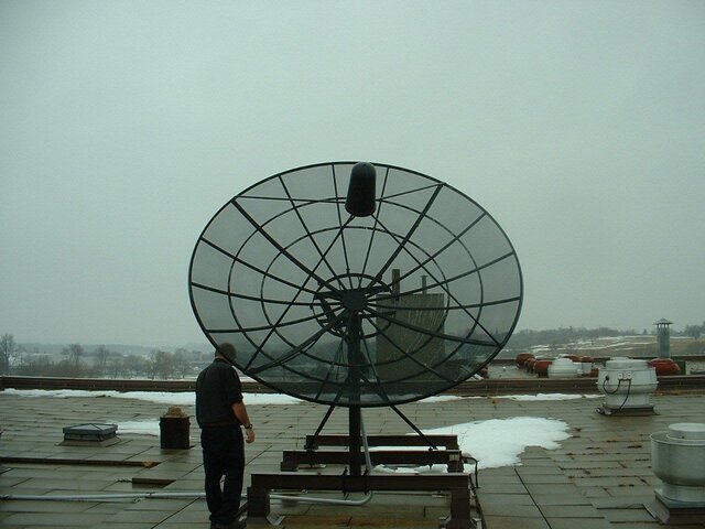

If possible, please post some pics of your exisiting setup, good pics always generate more comments! :)

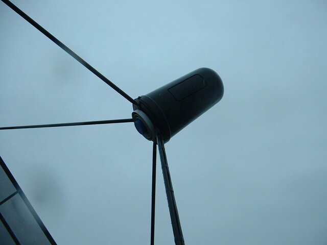

Thanks for the info. I am attaching a few pics of our setup. Our setup is about 12 years old so changing out the LNB is probably not a bad idea. We assume that it still works but don't know for sure. We used a General Instruments Innovation 550i receiver for the analog signal.
There was no numbers on the LNB unless they are inside it so I couldn't tell exactly we have. Will a new LNB bolt right in to this config?

It would help to have a picture of your feed/LNB to tell what you had, but that being said, my feed and LNB is 15 years old, and it works great for digital.
Unless you can determine for sure that it will not work, I would try what you have on the dish before I changed it out.

From the picture, it looks like you have a motor on the back side of the dish.
And your old Analog receiver undoubtedly provides the motor control.
Other than the roof mount, that looks like a standard home installation.
You might want to keep that receiver, both to move the dish, and to adjust the polarity servo up on the feedhorn.

What a nice looking dish and sturdy looking mount. Cable in conduit too. Since everything looks professionally installed, perhaps commercial type LNB is hiding under that cover.
Does the analog receiver still get a picture?
i was going to ask the same question .... reason being if its be a while since it was used
something might have moved in and set up house .... the is the best time of year to check and clean under the feedhorn cover :)

Nice looking dish, looks to be in real good shape for it's in weather service time.
