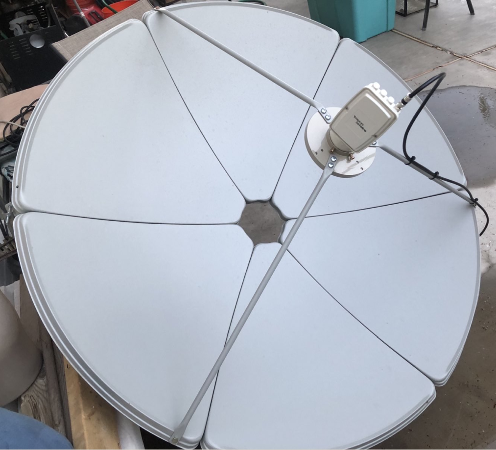

I was given a terrible ground mount 120cm dish. I paired it with a Titanium C140 lnb and have only been successful locking onto 105w 3881H. I scan in and can watch the CH-1, CH-2 and CH-3 channels but no matter what, nothing else locks.
Where the dish is currently sitting I can only see a small portion of the arc. I'm wondering if there are any other birds out there that might be possible before I try moving it somewhere else. Or is it a lost cause and I should just put a KU lnb on it? I'm located in Southern Nevada if that matters. Thanks

Nothing under 8 feet is worth bothering with for C-band. Those times are passed now, as most need far more s/n ratio to be lockable.

Do you have the center plate? Every little bit of signal reflection helps.
P.S. That is a circular polarity feed so you would need the slab inserted in your lnbf. ;)
