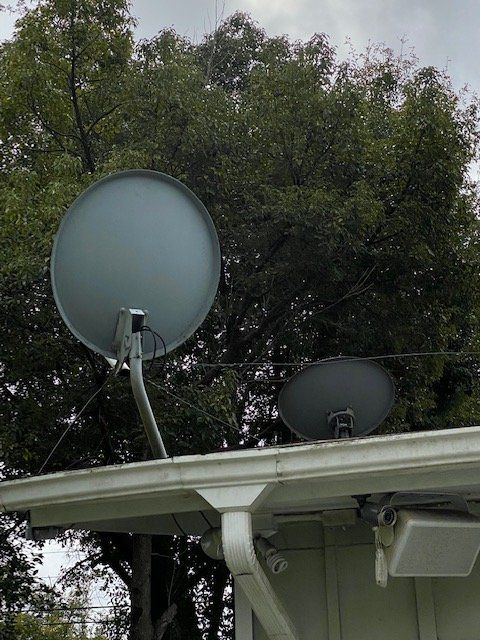

Weather is great here today so I begin my final phase of removing the dishes off the roof and begin roof repair work. I'm pretty excited over physically cutting the cords today.

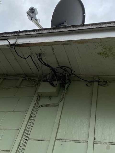

I wondered if that was how they (whoever) elected to get the signal INTO the house. The wire from the Dish looks like it's coming over the fascia board.
OP said he was a 20+ year customer, so I am guessing this is a DIY install that was modified several times over the years. Originally it was probably 119 only, maybe a wing dish was added at some point, etc. I would guess the little box under the soffit once held a couple old SW21s or SW64 and signal was run into the attic through the soffit and then down to the rooms. Probably no basement in this house to run the cable so attic it is!

It is in Florida so basements are rare, also Don already said he put up the Dishes himself.

No need to guess. Originally I had the DirecTV system in the mid 90's. Then added DishNetwork receiver, Next came VOOM. Now I had 3 dishes in a line. I then added the roof top antenna for locals. As Dish obsoleted my dishes and Voom went out of business and I dropped DirecTV, I ended up with a single dish that had weak 61.5 signal so I modified the main one by shielding the 3rd LNB and added the 30" dish for 61.5. This worked great for everything when it was in the clear but as years of tree growth passed I kept losing signal more frequently with wet trees from the rain. I could have relocated the dishes for clear angle but I didn't want to mount them into the roof where any leak would be internal. There is no place where in the middle of my yard would work either.

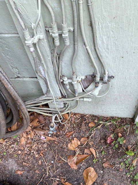

The connectors are all water proof ones with rubber seals and sealant and have been in place for many years and no leakage and I have never suffered a static failure or lightning strike. Waterproof connectors eliminate the ugly drip loops that cheap connectors mandate. Not shown is the entry point into the house which is through a block wall under the main floor through a block vent. Nothing runs into the attic space. House is not on a slab but 24" above ground and I can crawl under where all the piping and wires run from room to room. You are right the box was first for the DirecTV switch and later the obsolete SW64 IIRC. It's been disconnected for years.
With all that gone now I can prepare for whole house painting which it desperately needs.

Drip loops aren't just for water drainage. They provide excess cable in case of damaged connectors or just unscrewing connectors without removing cable clips
