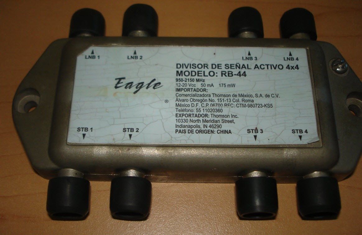

That is a very impressive find. However there is no shopping cart on that website and it just leads to a form for information on an install. I'd love to know how you found that or if you found something on eBay. Below pictured is one of the switches actually used in these installations. Perhaps there is something similar I could use that would work. A spanish board said these switches actually have a microprocessor within that marry the receivers.

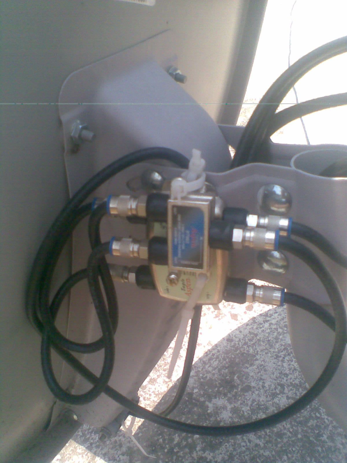

your flea market source has no switches? Did a search on that lnb and looks strange the way they destack the signal but photo shows how they install with one line for lnb to a single port power passing Eagle Aspen sat splitter then to the 2x2 switch imagen003ao.jpg

That one port power passing is model 7002 that I was able to get on ebay for very cheap. I already have that... the only missing piece of the puzzle is the eagle aspen rb22/44 switch.

In that particular photo that you just referred to.... There is a difference in how they routed cables that were going to HD and non HD boxes. That is what is in the description that came w/ that photo when I found it.
looks like the splitter with power passing goes to lnb port 1 on switch. should not matter what port the box is on one or two they should still talk to each other and HD is all on the same sat

I finally got my hands on the switch! I got the Eagle Aspen RB 44 and all is well ! About 5 channels don't come in. I don't even get a signal loss error but just a black screen. Could be on the broadcaster's end... could be LNB as I am using a single and using 2 receivers.. Could be I just need to play around w/ it more.
