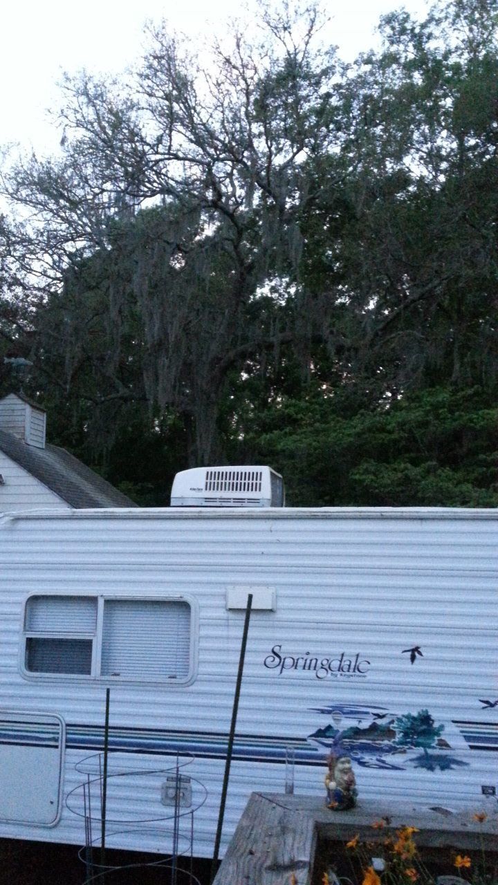

I wonder if someone could help me with this issue I've been having. I have a dish VIP 221 K receiver and a dish turbo HD Dish

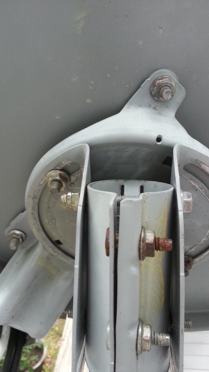

I'm picking up 110 and 119 just fine but I cannot pick up 129. I think I read somewhere that on some turbo HD skew readings are reversed?. I'm thinking it's mostly a line of sight issue there is a lot of trees. I got the dish from eBay I wonder if that could be an issue? also have a second dish it's a small windguard I was wondering if there's another satellite I can use it with to pick up some extra stations?

That could indeed be a LOS issue or LNB/Dish issue, based on those results.

At any rate, leaning toward LOS/LNB issue.
