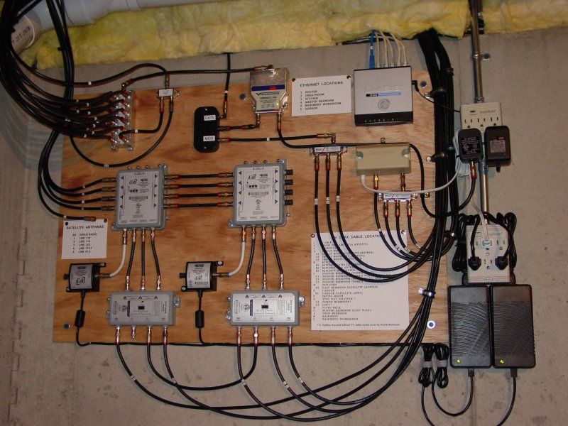

I have seen a diagram for six DPP44 switches. When I had four HWSs I had two switches connected to a DISH 1000+ dish.
Four Hoppers? :eeek
Here is a pic of my headend when I had four HWSs and one Joey 1.
