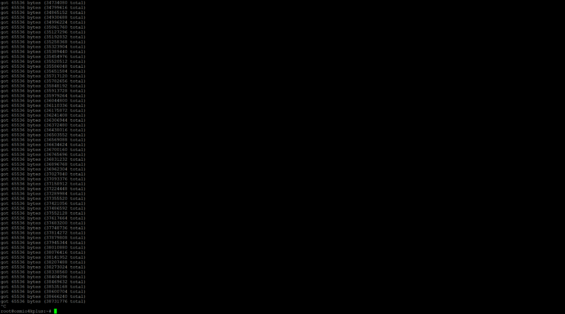

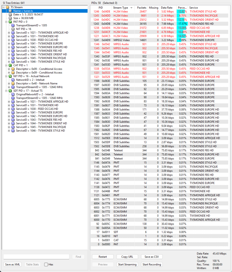

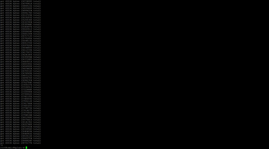

...I'm just wondering if there is any chance that someone there in western North America who can pick it up could record a full transponder dump (just a couple of minutes) of 11155V for me?...
If nobody provides before, I can record this in a couple of weeks after I return home. My dish is still pointed at 180E.

how do you record a full transponder dump?
I have an Enigma2 receiver, but i think that only records the specific program, not the full transponder, right
I also have an old DVBWorld PCI card, but i'm not sure if it can lock those high-bitrate transponders
(I'm asking out of curiosity as that seems interesting, I'm not offering to record that Intelsat 18 transponder as i'm on the US East Coast and it's not receivable from here. But I do receive the Intelsat 35e stuff)

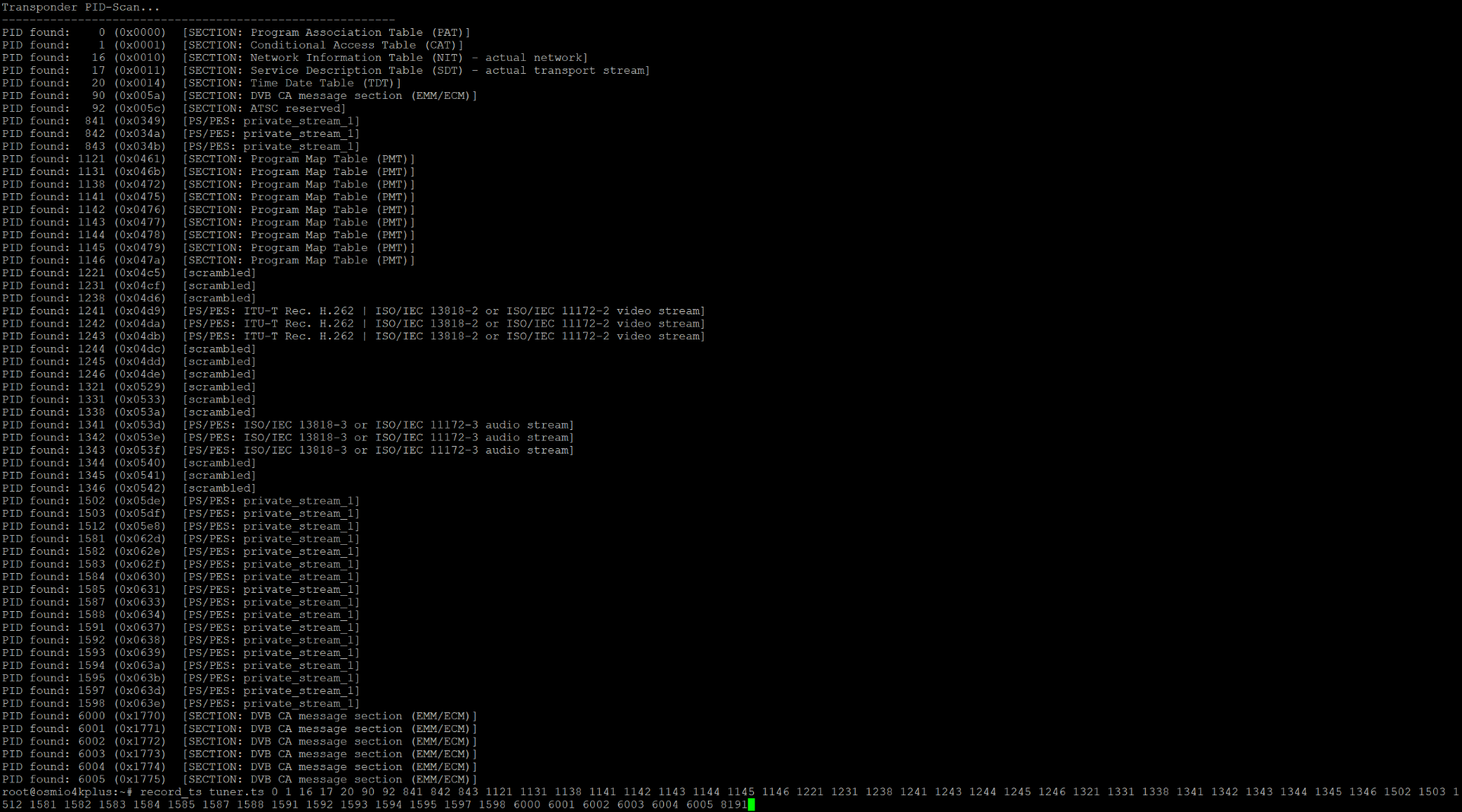

Enigma2 receiver cannot perform fullTS, but you can try to find all active pids with dvbsnoop and use the utility to save them.
