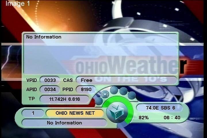

1. The symbol rate now is shown after the frequency the second time you hit the "Info" button (Image 1). This is a major improvement since to find the SR for a channel previously you had to go to the "Manual Scan" or "PID Scan" screens.

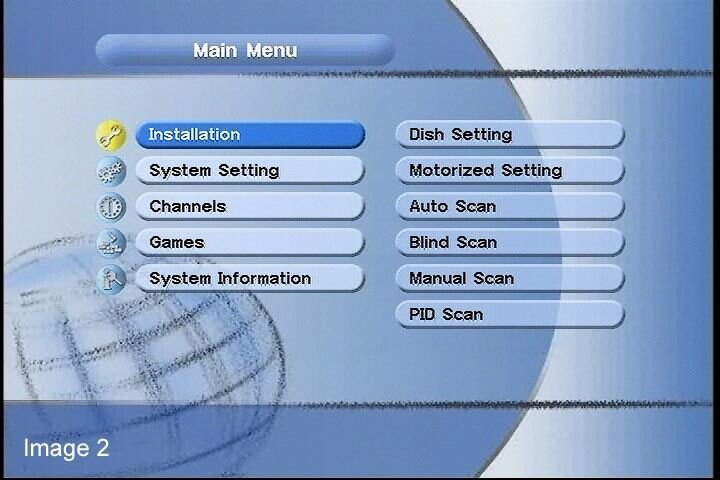

2. The icons to the left of the menu items on the "Main Menu" (Image 2) now blink (they don't do anything else that I can see).

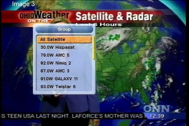

4. When you hit the "Sat" button the list now shows the orbital location (93 W etc.) for each satellite (Image 3). A nice touch.

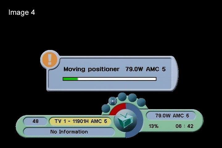

5. Someone at Coolsat must read this forum because one of the most suggested improvements has been implemented. Now when you switch satellites the screen displays "Moving Positioner" and then shows a bar graph with a green line moving from left to right to indicate the progress made (Image 4). This graph only indicates that the positioner is moving and is not meant to be a representation of how much time is remaining in the current move. For example, during a move from IA6 to AMC 5 the color bar will never get "full". Going to G10R from the eastern-most satellites will cause the bar to fill up several times before reaching its destination. But at least you know when the positioner is moving and when it is not. A major improvement and kudos to Coolsat for listening to the FTA community and implementing this much-needed feature!
Last but not least, Coolsat has again listened to the FTA community and implemented an improved "Blind Scan" albeit with mixed results in my admittedly preliminary tests (Image 5). The changes:
