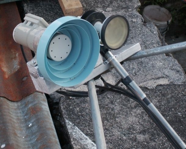

what size and type of dish have you got -- prime focus or offset
i,v tried combined C / ku lnb.s --- and a second hand co rotor setup here in the u.k. --- all have been poor performance on k.u .
the best way to go if you can set them up on your dish is to use seperate C and k/u lnb.s -- i currently have a k.u l.n.b. in the centre position and a dual polarity C band l.n.b 6 degrees to one side
its a little inconvenient having to have different C and k/u/ positioner settings for the receiver --
but the performance is miles better than any combined unit
i,m using a 1.8 offset dish -- for this --
but i have also done a similar thing in the past using a 1.8 prime focus --
but on that one i had C band in the centre and k/u to one side
regards nelson.b

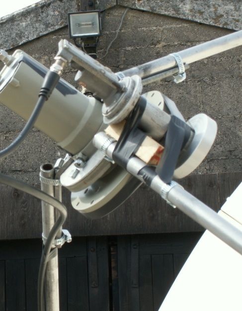

Using a Chaparral Feedhorn and adding a Ku band LNB look to be a option.
Mr.nelson b my dishes are 0,9m,1.2m offset and 1.2m simetric.
The dish are one center,the signal are not lost if i want to watch a satelite with C and Ku band ? The C band LNB its near the center not in the center.
I want to ask You all a question.
Mr. Klaus Schumacher from Brasil use a ingenious mechanical device to replace the Ku band LNB from the focal point with other LNB C band i think.
This device its free from signal lost if i want to receve with the same feedhorn C band and Ku band ? What feedhorn its the best to us in this case C or Ku feedhorn?
What You all are thinking about this mechanical method,its free from signal lost ?
