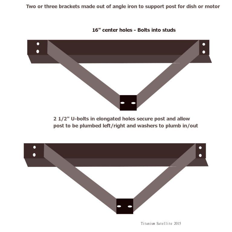

$30 or $40 a local shop will weld a set of these up for you out of some scrap angle iron. Buy a can of Rust-oleum spray paint, 8 lag bolts, a dozen flat washers and two 2 1/2" x4" U-bolts. Better than any J-bracket on the market.
Reactions: glover31
neat! My half brother is a welder. Maybe I will ask him. I am going to see if I can find a mast to mast adapter. If not this is a great Idea. Thanks titanium.

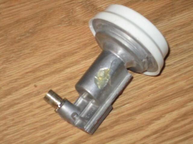

The lnb, Is a Eagle Apen 270 MODEL lea270ku. Input Freq: 11.7-12.2. Output Freq: 950-1450.
As far as an ACTIVE transponder, I am not sure. I mean the receiver has like 4 channels pre programmed in on galaxy 19. EXAMPLE : rtv. But have the transponders changed? Don't know. I am trying to blind scan. YES. most definitely I have changed transponders. No change.

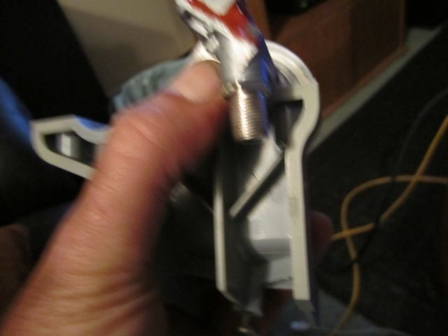

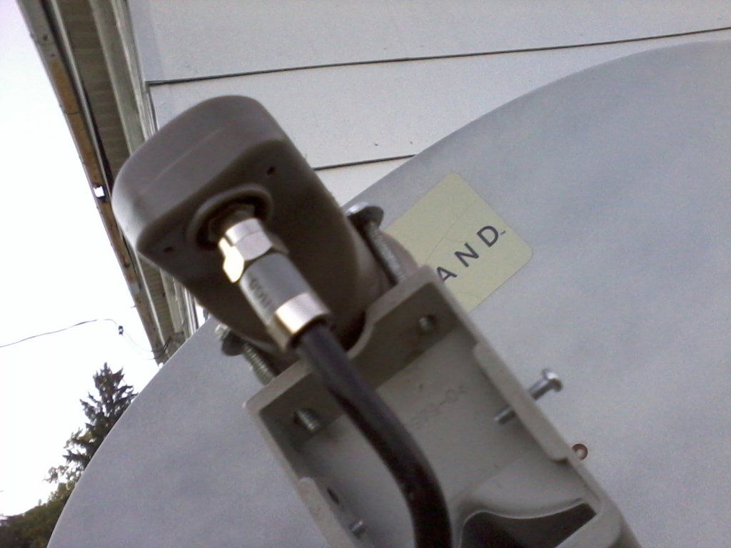

NO feed horn means : There is no feed horn attached. Blue ring like c-band. notta. nothing. was told I needed one. That this was a lnb not a lnbf.
Good, correct LNBF! Be sure the receiver' LO frequency is set to 10750.
You were informed correctly, the LNB requires a feedhorn and scalar. Not sure how a LNB could be mounted on the 75e without the feedhorn and scalar. Surprised that anything was received! Definitely want to see a photo of how this is mounted. You either need to also install the proper feedhorn/scalar or replace with a LNBF.
