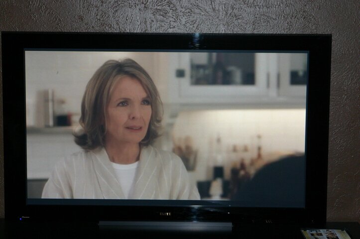

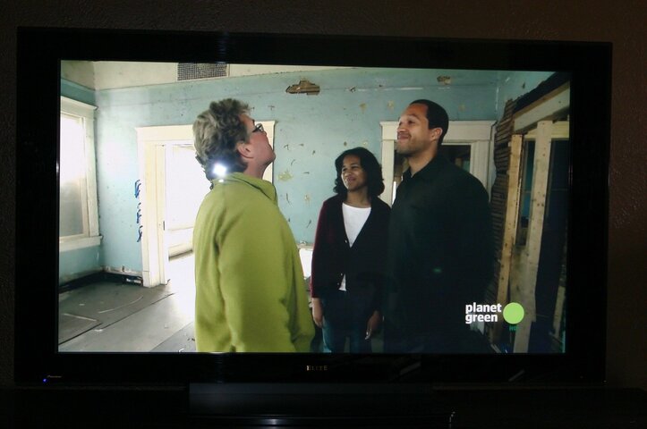

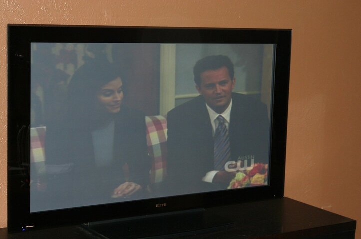

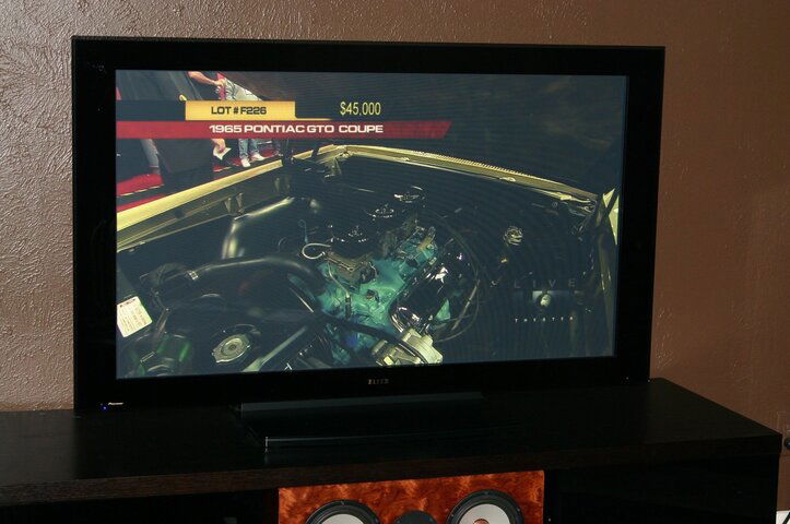

Here are the pictures: The HD theater (car engine) and the CW (people sitting on couch) are Direct TV and then the lady is a DVD. Can the ODU (power inserter) cause a dirty signal or do we need an amplifier. These are all new cabling so i wouldn't think it is a cable. We did have trouble with a connection on the ODU, and I remember the installer saying he initialy wired the power supply backwards.
I hope i don't have to live with this picture for 2 years I would be sick!

First the signal is Digital.. ie 1's and 0's so there is no degradation (Works or Doesnt), but.. if he did wire the PI wrong it is possible he sent 21v into the boxes causing some issues. But it Still "seems" to be a Issue with the TV's. So to eliminate that we need to try a couple things.
First The TV In the Picture...
On my TV I can set the HD settings and Picture Quality Settings Per port. Ie I can have a high contrast image on HDMI1 for games, but have a low contrast setting on HDMI2 for Movies (just examples) So
Use the Same HDMI Port the DVD player is using, swap D* and the DVR on the TV and see if it is still there.
Cycle through the Pre-Set Picture Settings (I am sure you have tried)
Set the D* HDDVR to ONLY 720p and Cycle Settings
Set the D* HDVR to Native on and Cycle Settings
It is quite Possible the cable company was just transmitting a high contrast image and you adjusted to seeing that, now that your TV is getting a new source, new settings may need to be made. If trying the above make no difference I would call D* and get a Tech out to Swap a box to see if the PI issue damaged the boxes. I would have him put in a new HDDVR and see if the Customer Ed channel looks good or the same (201 now).

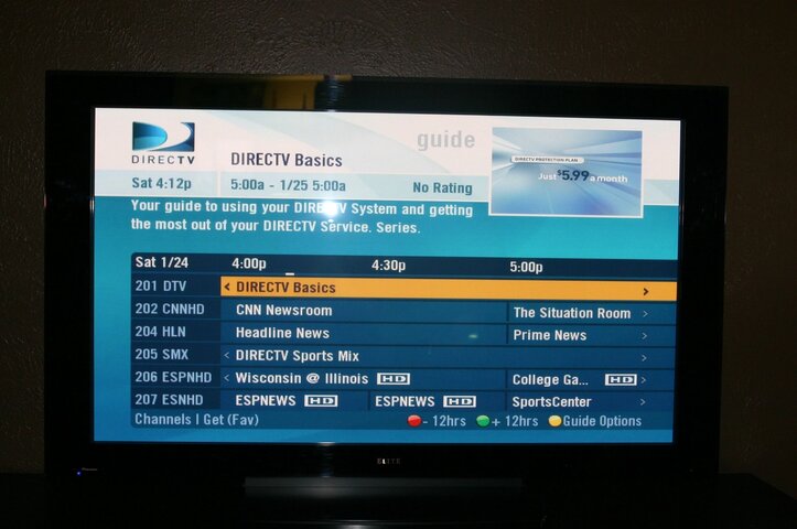

If you do not mind... Put a Pic up with the Guide and 201, I want to see what shade the blue is. But also swap DVD for HDVR inputs.. Ie hook up the HDDVR to the exact same way the DVR is into the same ports. Take the shot straight on so there is no side view distortion.

Looks like you need to readjust your contrast and brightness for DirecTV. Every input is going to be different.
I remember the installer telling someone over the phone that he had hooked the power inserter up backwards at the switch in the attic. I am wondering if this may in fact have caused a problem. I think the ODU/power inserter for the SWN line puts out 21 volts and the box puts out 12-18 I think someone from Direct said.
It always makes me uneasy having these power inserters inline/before expensive AV equipment. I have been told that is very unlikely that these low voltage can do any damage to AV equipment, but if it is powered with 110volts seems that is entirely possible if the power conversion mechanism fails.
I am going to try the tests above and post pictures and results.

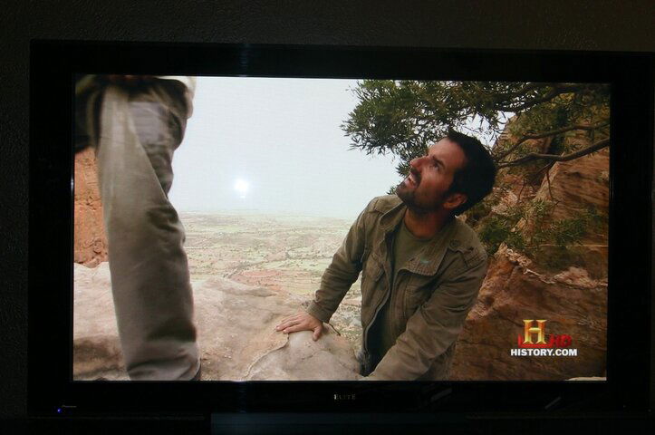

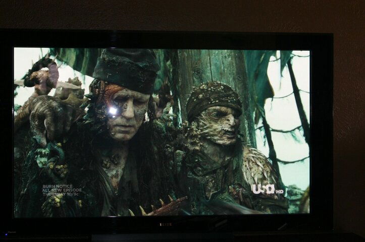

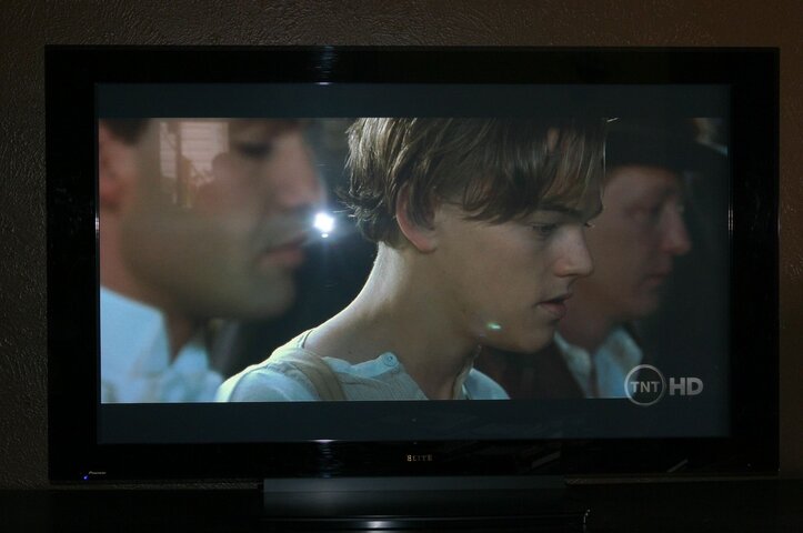

I just came in and powered up the Sat receiver, AV receiver and the Pioneer Elite plasma and the picture quality is an awesome WOW picture. Could it be that it has something to do with the Sat receiver updates or if the power inserter damage the box would it run normal until it gets hot?
Haven't tried the differant connection yet, however after seeing the stunning quality ofter the SAT receiver had been powered down for almost 24 hours it makes me think it is a SAT receiver issue. I did take a picture of CH 201 and the guide for you and some pictures of the current picture quality on differant channels, even TNT is smooth clear and bright!!! I know pictures don't show the true quality but has stunning brightness/clarity more so than the pictures. I'll have to wait and see after the box has run for a while. Haven't tested the other boxes yet.
I will post later after Sat receiver has run for a while and has become warm/hot. Thanks again.
