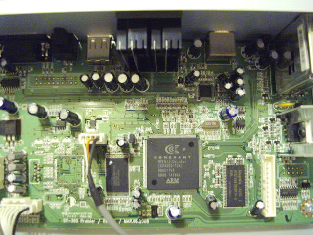

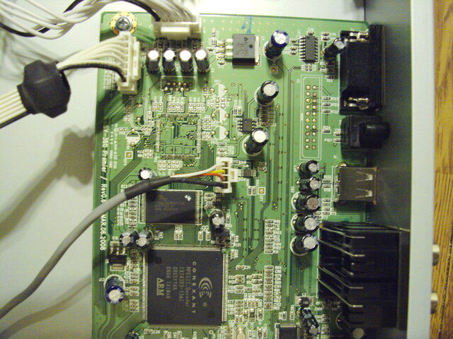

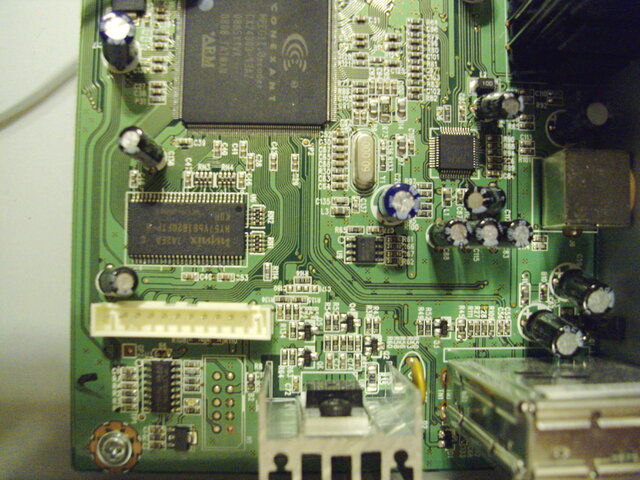

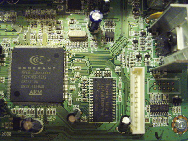

Here are some pics of the inside...just the main board
the pin connector is a 12 pin

There are 2 empty headers: one 20 pin & one 10 pin.
The strips I have are double row 80 pin segmented to be cut to length.
I think the one to use would be the H2 20 pin header near the serial port for jtagging. If I'm wrong someone feel free to jump in.
