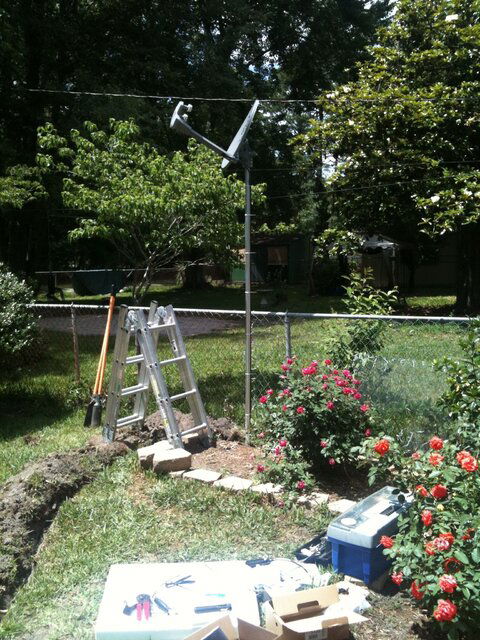

Personally I wouldn't worry about it. I've installed plenty 7'-8' above the ground using a 10' pole. Any minor rocking from wind, ect. just won't be enough to effect it. Also, I typically use (1) 50lb bag of fast set quickcrete. The 100lbs is more than adequate.
In fact, here's one I did last summer that was around 8'

That is a great example. I am thinking that I may try it as-is and if I have any wind related problems I will add ground anchors and turnbuckles.
You won't have a problem. I'd bet on it. I'd say 5' is what I usually average on them unless I go higher to clear trees. I've done 100s and not once had to reposition one.
