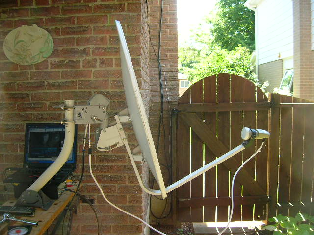

tookien123,
I did a quick setup of my Stab 90 motor and 31" dish on my deck the morning.
I managed to get 97º W with a Q of 60, did not bother to tweak for higher Q.
Motor is set to my LAT 43.6º.
The elevation mark on the dish is at 42º.
I measured the dish angle with an inclinometer by placing a straight edge across the face of the dish from edge to edge.
The reading was 20º
Based on the dish and motor at your end the dish elevation mark will be different but I think that the face of the dish should be at about 20º.
Hope this is of some help.

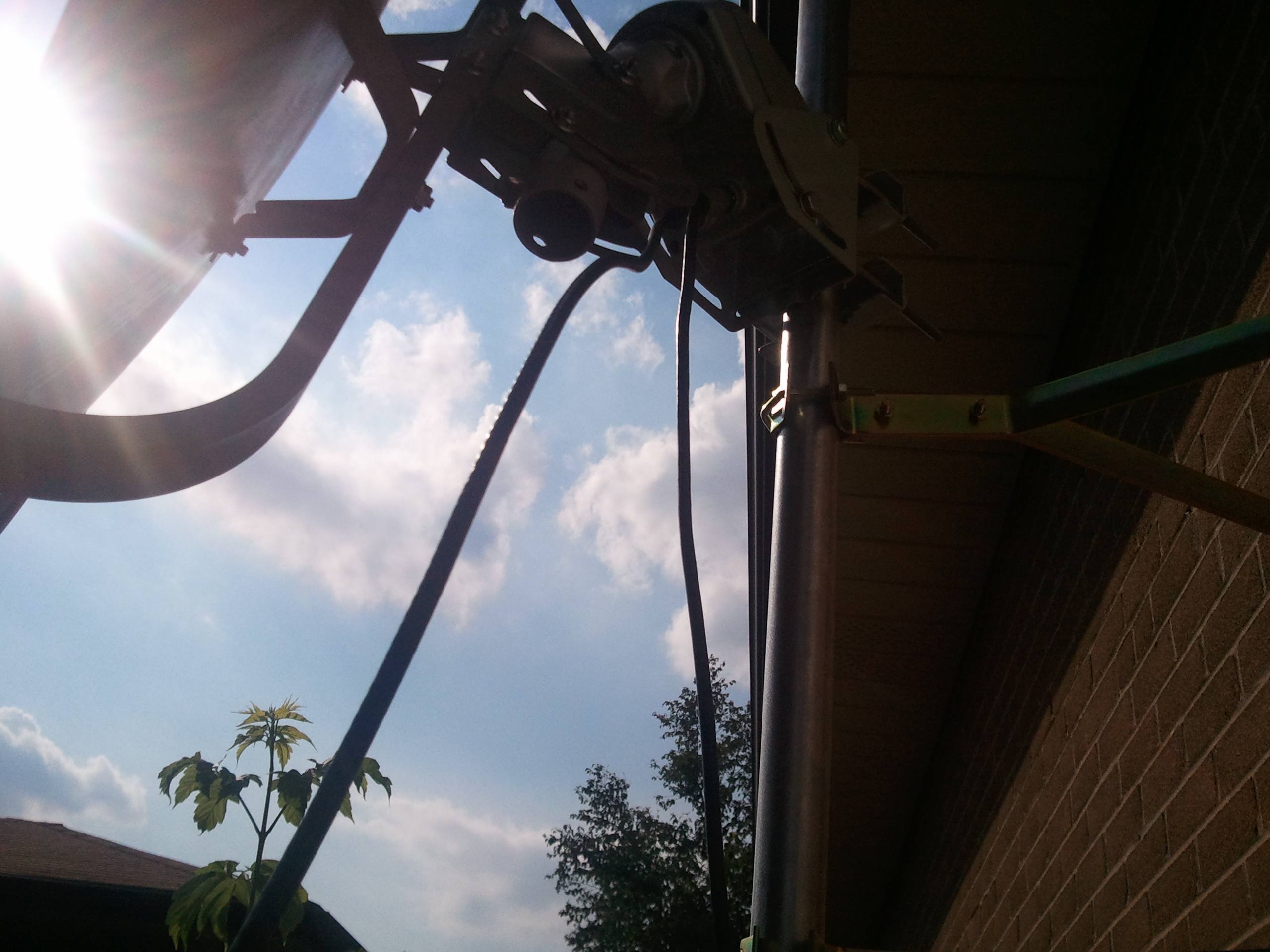

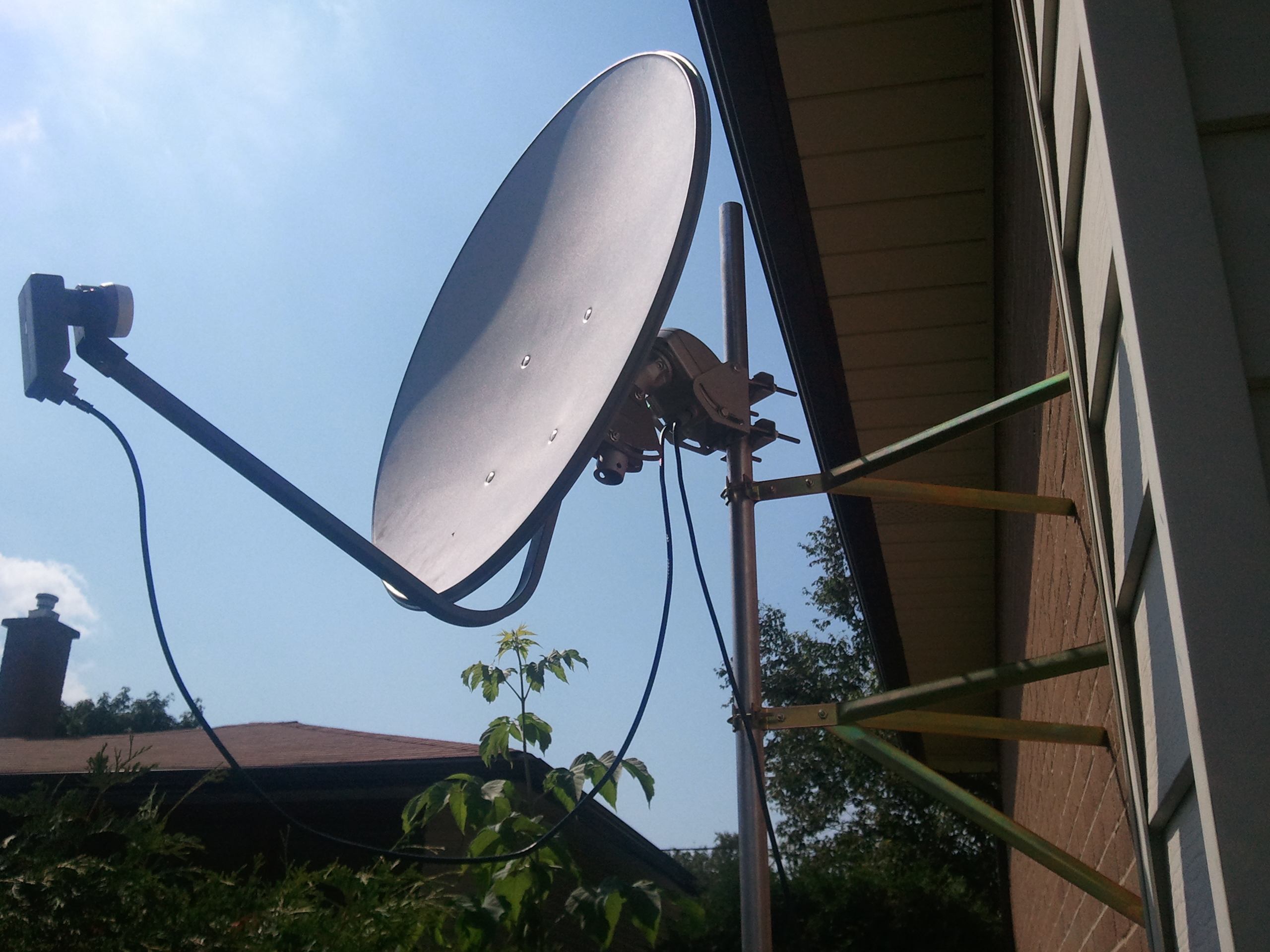

Hi jorgek,
Thanks again but unfortunately I still couldn't get any signal over 10 Q on 97 nor 95 (tried both).
Here is my recent setup:
My latitude is pretty much the same as yours (43.7 degrees).
Here is what the motor manual indicates for 43.7 (rounded to 44):
Elevation angle: 46
Declination angle: 6.7
Dish Bracket angle: 23.3 (I tried this one but it didn't work, it makes sense since 30 - 6.7 = 23.3, I then tried 42 that didn't work either)
I used my smartphone app compass first for true South, that didn't work. Then I went to Satellite Dish finder/alignment calculator, I used the given line and a reference point in my area to point the dish at South which didn't work either.
Thanks for any input.
