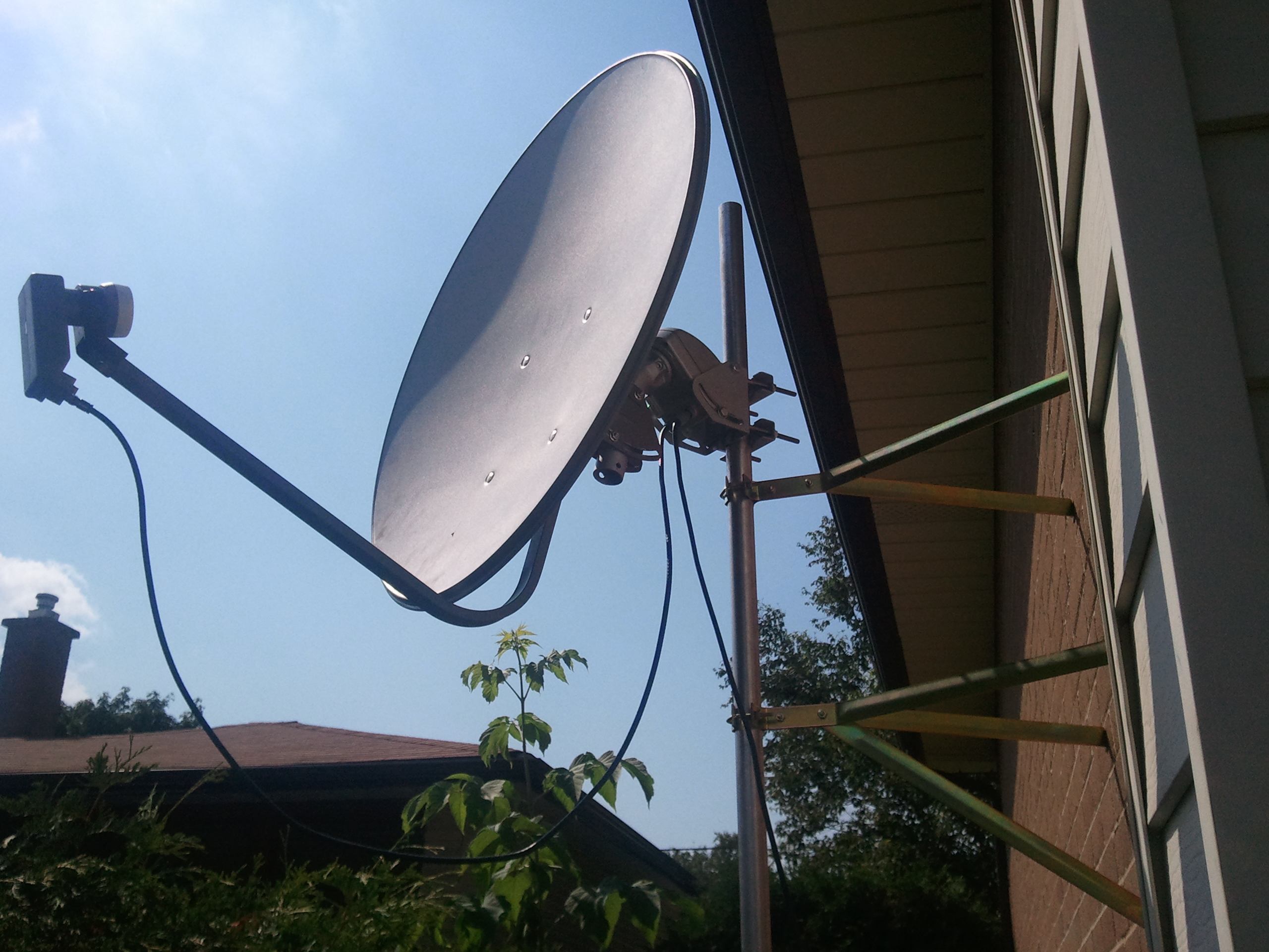

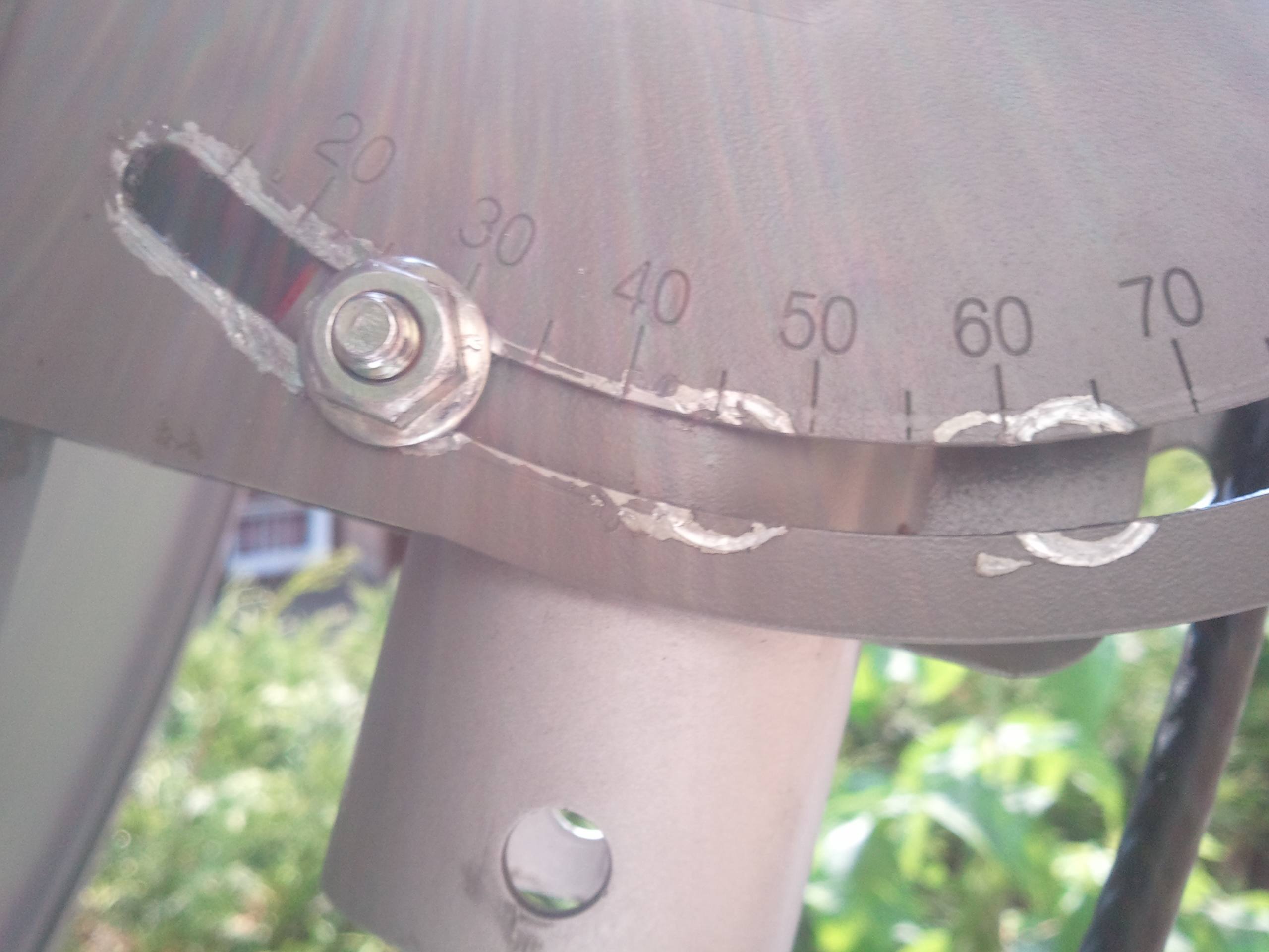

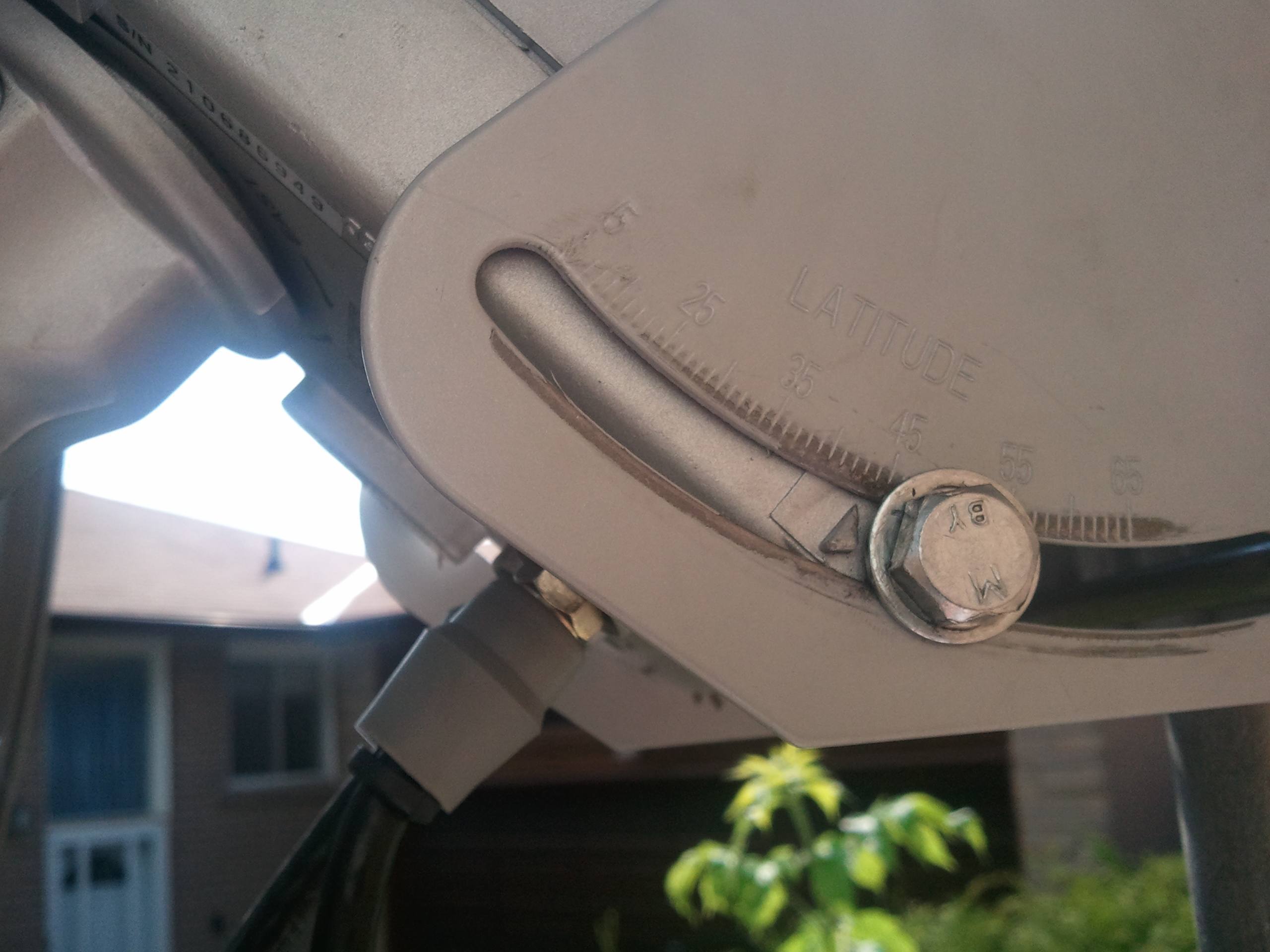

For the dish bracket angle, I had it set for 23.3 and 42 previously, after tweaking and giving up that is where I left off.
Hmmm, the mount for my SG2100 (doesn't work, but I still have the motor) isn't set up like that. Let me look at the pictures for a while ;)

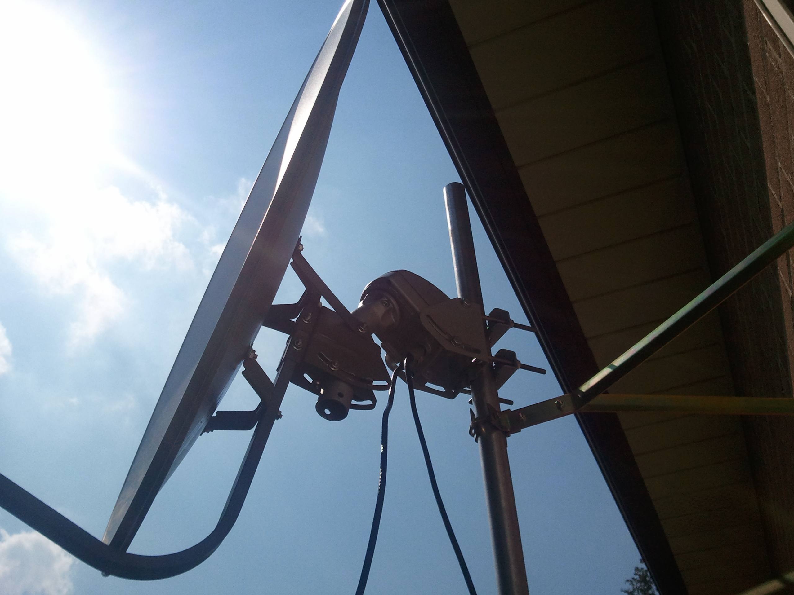

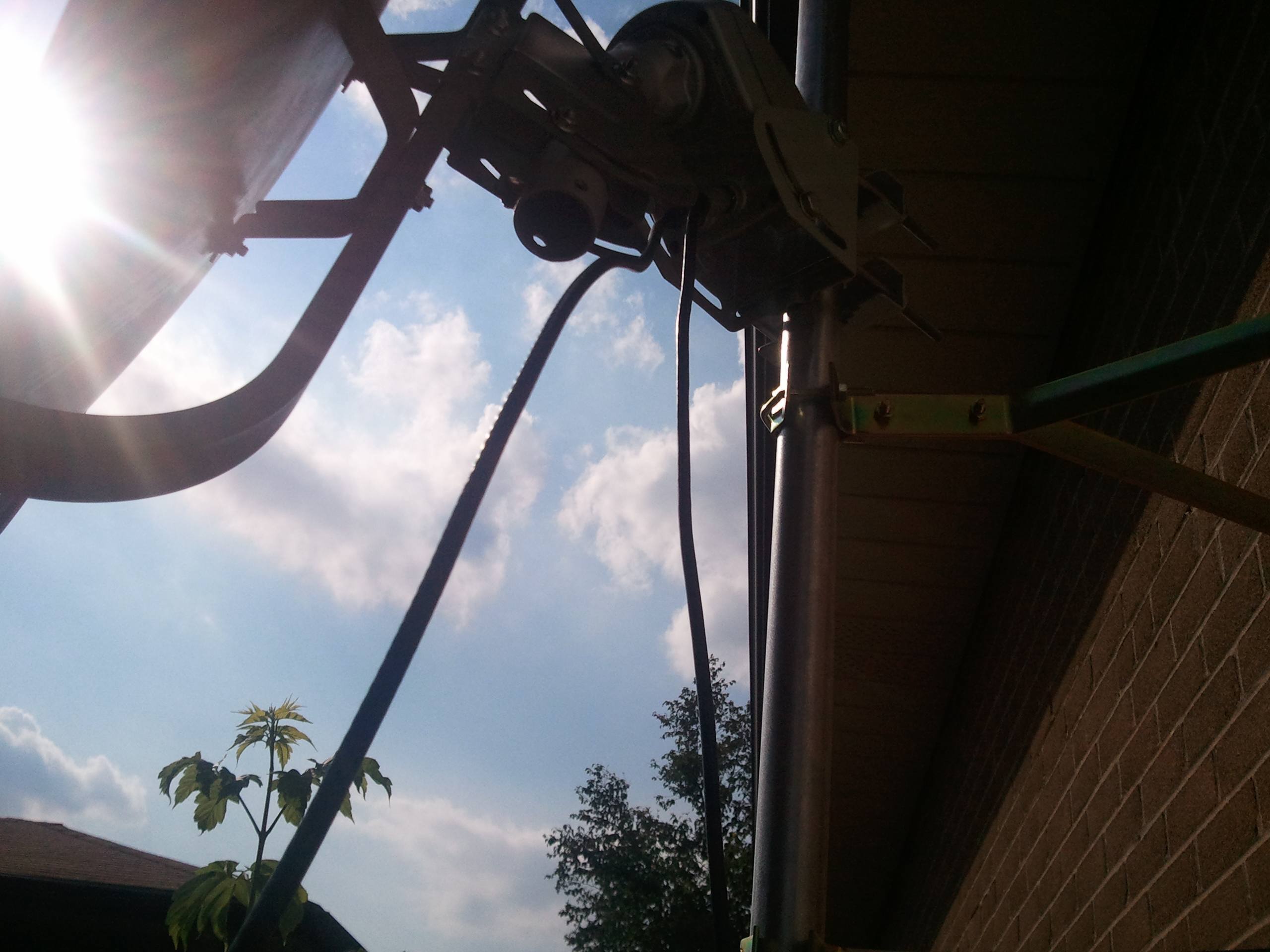

It may seem rotated because the motor is not at 0 at the moment.
I left it like that at the 97.0 satellite with the receiver (via USALS). (Usually I reset it to 0 and start all over again with South etc...and then I go to the receiver and then back for adjustments)
I then very slightly moved the motor and dish together for better South position, got nothing.
Then I moved very slightly dish angle bracket up and down, got nothing.

Forget about true south for a moment. Can you find 97w by moving the the motor and dish together? If yes then mark the position on the pole in line with the LNB support arm.
Make sure your LAT and LONG are entered in the USALS setup menu. Now with USALs drive the motor to the 0 ref mark. Now with USALs sent the dish to 97w.
When it stops move the dish and motor assembly to line up with the mark in the previous step. You should be viewing 97w at this point. Tweak for max Q. Lock down the motor to the mast at this point.
Now when you send the dish back to 0 ref that is your true south.
Thats how I setup the test yesterday AM.
