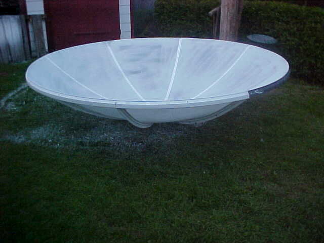

Here is a pic of my newly acquired baby,,,,Changed all the old bolts,nuts and screws and replaced all with stainless
Painting it white (as per pic) so they match my other dishes,,,+ I have not seen too many white BUDS around,,,,,will look cool

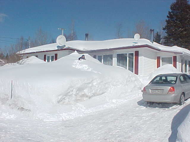

Actually up in the suburbs of Quebec city,,,,,At the base of a mountain actually and yes we do get an awful lots of snow out here ,,I don't think you would believe me if I were to tell you that if I would mount the dish on a 6' pole in the backyard,,the pole and dish would get buried in snow,,,,not kidding !!!
Here's a pic of my house in the winter,,,,,and it got worst than that,,,the snow completely covered the large living room window and the snow got to 1' from the roof,,,we could walk up on the roof with no ladders !!!
As far as my line of sights goes here only one place really behind the house where I would be able to get 30W to 129W,,,,,,All the rest I would have obstructions,,,,,,That is why basically all of my smaller dishes are to the front of the house,,,,,on the roof
I was thinking of using a 6" or 8" Pole and run it through the roof siding,,,,but as you were mentioning it kind of scares me to lose a piece of the house to strong winds,,this is why,,I may have to reconsider just setting up the dish stationary on 1 sat we're interested in for this year,,,save up some money and have professional installer set it up next spring,,,,,from ground level it will have to be 18 if not 20 ' high so to clear the snow on the roof in the winter,,,,,
If this would be a normal setup,,I would not hesitate to do it myself,,,but at these heights it does start getting a little scary,,,

Yep, Thats a lot of Snow and looks cold too.:tux: Can you take some photo's of the back and south side of your house? Would help so we could see more and help more.

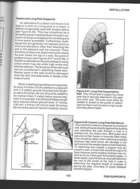

Another option for you is to install a self supporting pole so you could put a pole up without attaching it to the house, but it would have to probably a base 6-8 inch pipe then have smaller sections welded to reduce it all the way to the top section, a good example is road signs which are on tapered poles, you could do the same. The main thing your base will need to be able to support it. I scanned some pages from a satellite installation book and attached them, check out figure 8-46, hopefully they'll help you.

Many Tks Sergei for the scanned pages,,,yes I think you're right,,,an 8 " pole then reducing to 6" I think would be best with a solid base
