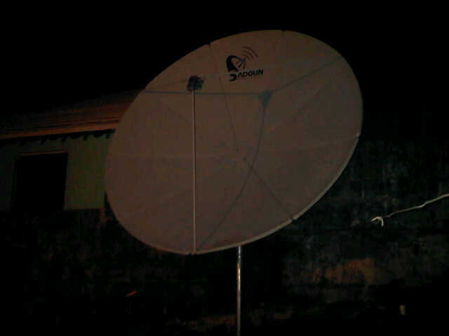

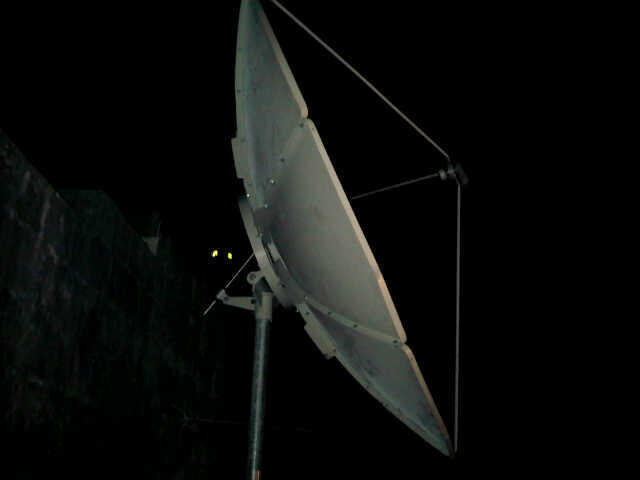

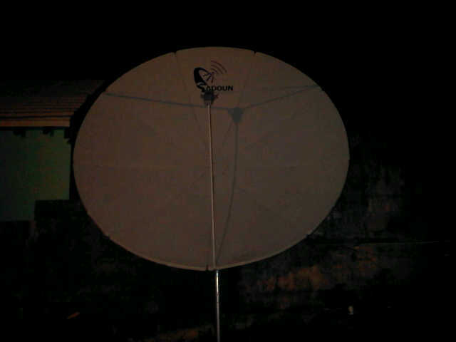

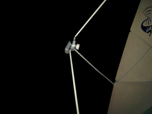

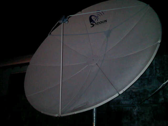

I am using this setup is increase the signal in my primefocus 2.40mts, this is the best set up for ku band sat on primefocus
Prime focus is hurting you. the strongest part of the signal is being blocked by the lnb itself. You would get better signal with Parabolic dish of the same size. Additionally, prime focus dish is not designed for the smaller feedhorn in a dish lnb. your lnb may only be getting signal from center section of the dish. not getting benefit of the full 2.4 meters. Where is the dish located?
The size of the smaller feed makes no difference. Now it would work better if he had a different scaler. But my guess if he has it a the correct focal length he will be loosing no more than 5%.

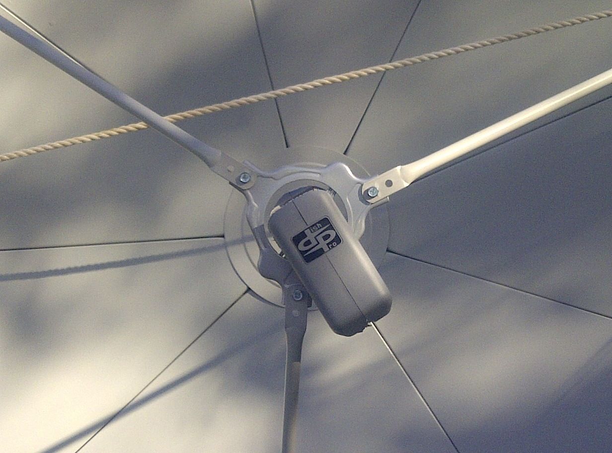

If anyone want to try this is another way to mount a ku lnb in a prime focus dish
No need to explain , just follow the image
2447d1288564585-otra_forma_de_montar_un_lnb_ku_en_una_antena_center_focus-lnb_mod3_jpg
2448d1288564590-otra_forma_de_montar_un_lnb_ku_en_una_antena_center_focus-lnb_mod1_jpg
2449d1288564594-otra_forma_de_montar_un_lnb_ku_en_una_antena_center_focus-lnb_mod2_jpg
2450d1288564620-otra_forma_de_montar_un_lnb_ku_en_una_antena_center_focus-240cf6_jpg
