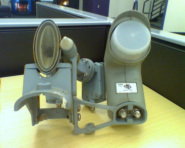

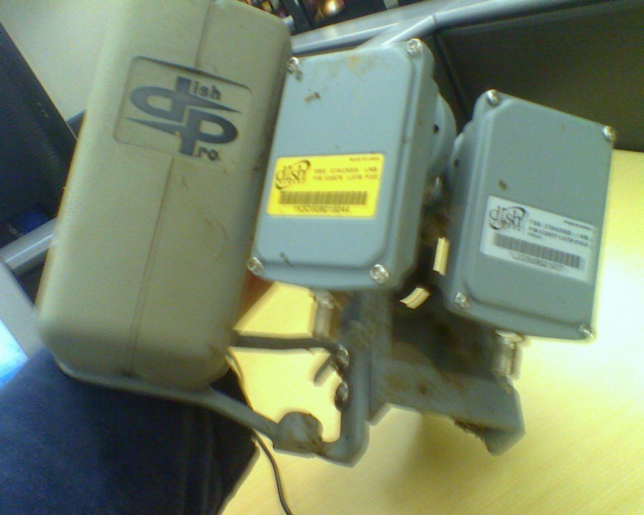

I have a couple pics of this lnb I was talking about to couple people on here does anyone have info on them?
Dan Rose
DishNet Superdish for 121° (and 105°)
Yea, the one with the tall oval horn probably has "FSS" on its label.
That's a bandstacked Standard 10750 LO LNB. <--- which you might want to use
The other two , are DBS 11250 (?) LO and circular.
In a minute, I can figure out which dish those came from, but you probably already know. :)

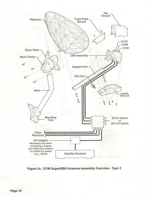

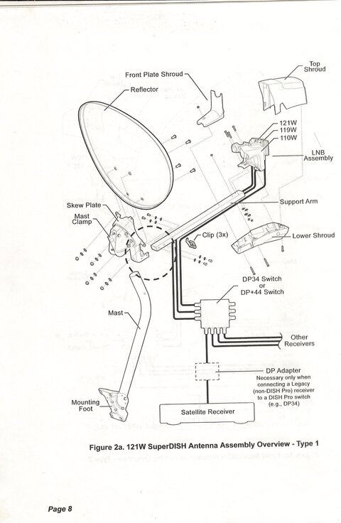

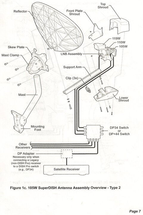

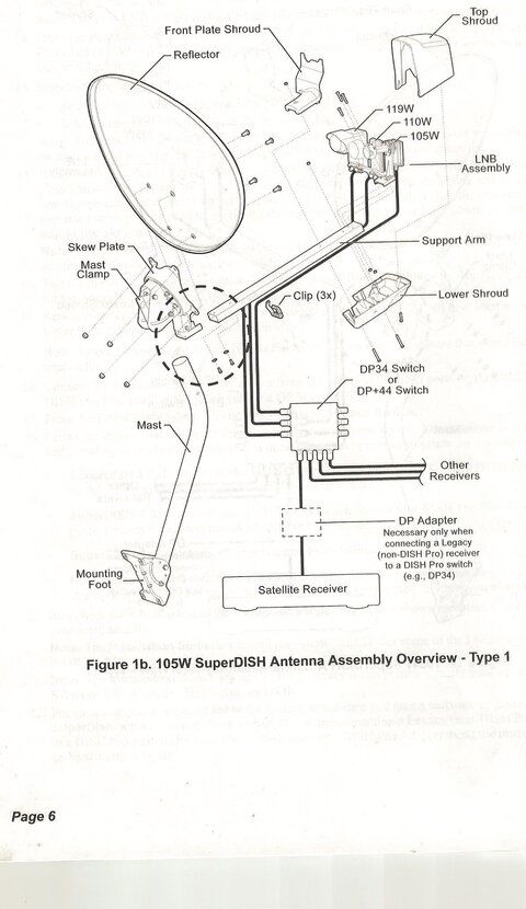

That is the LNB assembly from a 121 Superdish
From L to R the LNB's are
stacked KU Band (used for 121)
stacked DBS (used for 119...pencil one)
stacked DBS for 110
The KU one will work. If you took off the back of the Pencil LNB you could get another LNB on there for 2 sats 2 degrees apart. I know Eagle Aspen sells just the LNB (you supply the feedhorn...thats the eyeball part)
Thank you Ice and Anole I was just confused about it I also got the dish to go along with it. I have a lot of left over superdish lnbs. I thought the pencil shape would be to small to receive a linear signal?
