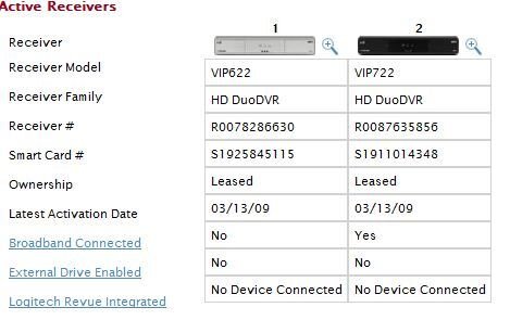

I have a DISH VIP 722 and the Sling Adapter.
I'm yet another DISH user who has his VIP 722 NOT recognized by Dish Online as "connected" when it is!
I can connect and watch my DVR recordings from my iPad and iPhone - but NOT from my computer!!
I can even set my recording schedules from my computer - but I cannot watch ANY live TV from the Sling Adapter - while the iPad and iPhone CAN DO IT - every time!

Months and months with this not working. The 722 shows up on the internet as "NOT CONNECTED TO THE INTERNET", but it is connected (via Ethernet, no less).

I wonder if this could be a HW issue? I had an older 722k at work that would occasionally show disconnected on DO. But, my fairly new 722k at home is always connected, never an issue. Maybe some internal component has changed in the newer models?
I know this won't help all of you, since you're not all having the same issue, but there's a known issue with DOL showing receivers offline that aren't. Quite commonly it's because the receiver number listed has an extra 0 in front of it -- R00123456789 instead of R0123456789. The solution to that particular issue is to give the receiver a nickname, either in DOL itself (which takes effect almost immediately) or in the broadband setup -> nickname setup menu on the receiver (which can take half an hour or more to propagate).
Well well; this might explain why I'm not having that trouble. I nicknamed my receivers LONG ago since I have 3 and didn't now which was which (on DRA) by number.
