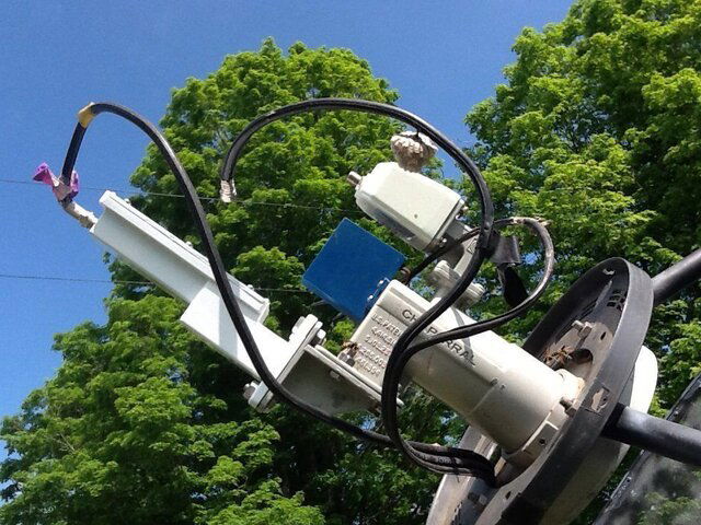

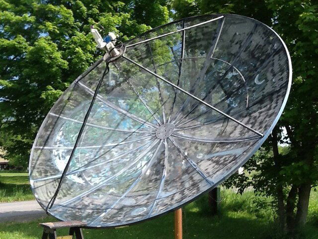

Bought a dreambox a while back after a lightning strike took out my openbox S9, but could not get it configured so I bought another Openbox S9. So easy to setup. I use a 10ft mesh, chapperal FH with a Norsat 8115 digital dro. (The Ku side probably does not work ). I use a Motorola 4DTv to move dish when needed ( it primarily stays on G4) and to switch polarity.
